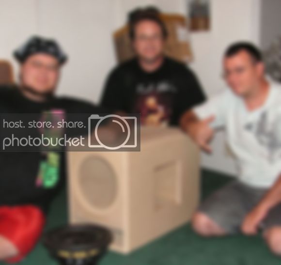

Does anyone know how to stain and finish a HT box its made out of MDF
ive been searching around for about 2 hours and cant really find any good
articles im wanting to do a glossy black color if anyone could help me id appreciate it.
Picture of my new HT enclosure with Pete, Steves Brother, and DD Super Steve.
You can't really stain an mdf box. If you want to paint it a gloss black it is a multi-step process. You will need a few coats of primer (the mdf absorbs alot of paint). Then you will need mulitple coats of good gloss paint, sanded with extremely fine wet sandpaper inbetween the coats. It isn't a particularly difficult process, just time consuming.
