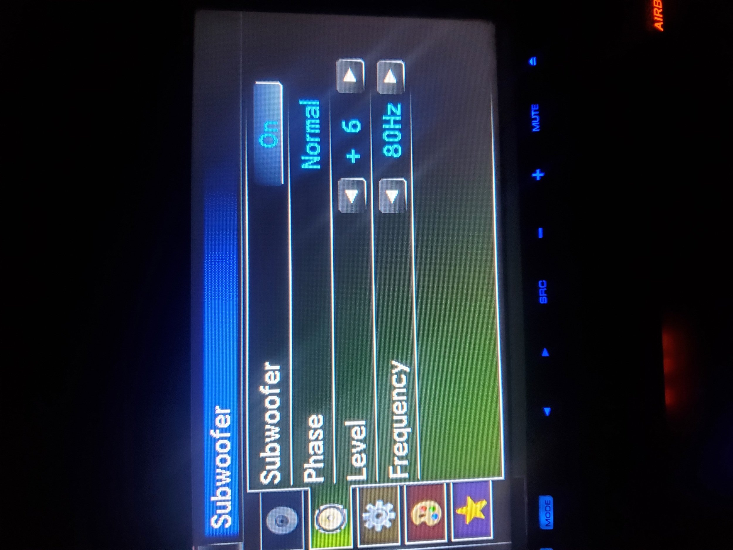

Okay I turned off the bass boosting. Have the radio volume at 75% and for the bass on the EQ at max I believe.
Make sure the sub level adjustment is turned up some I usually go a few clicks before Max. Turn up any source volume adjustments also if it has it. I usually go above 3/4 volume that low you probably only hitting 1v I go 55/62 on my pioneer
