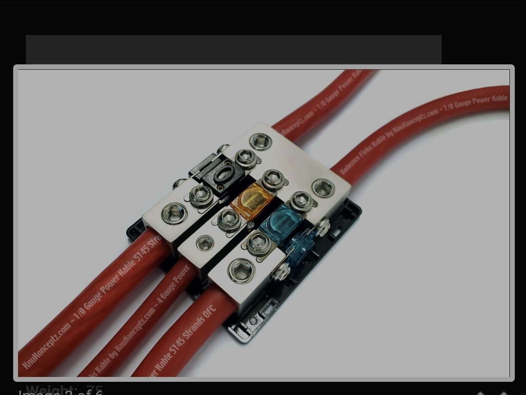

Absolutely with a distro block with those outlets.You can even get a reducer for the 4ga to fit the 0ga outlet for a much tighter fit. Some blocks come with reducing sleeves

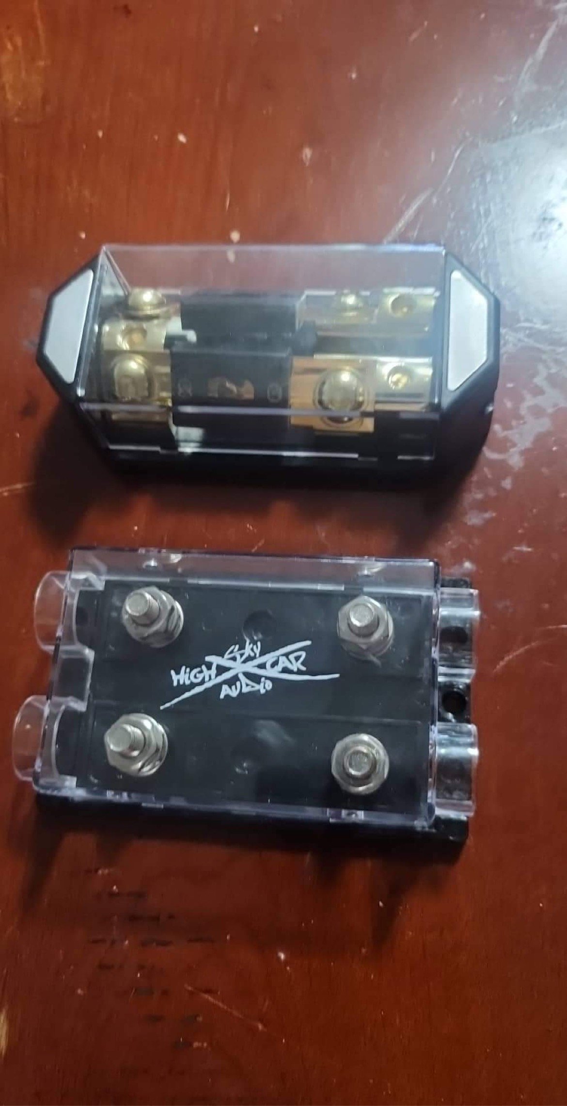

Just wondering if i can have 1 input and have 2 outputs or will i have to use two inputs for the distribution block on the bottom?
You could make the bottom one work with one power input by adding a bar across on that end and would have two outputs.
Otherwise in stock form the bottom one is a dual input/output.
This may be an option for you as well. Im sure Amazon has them on theyre site also to be purchased. Great amps...
