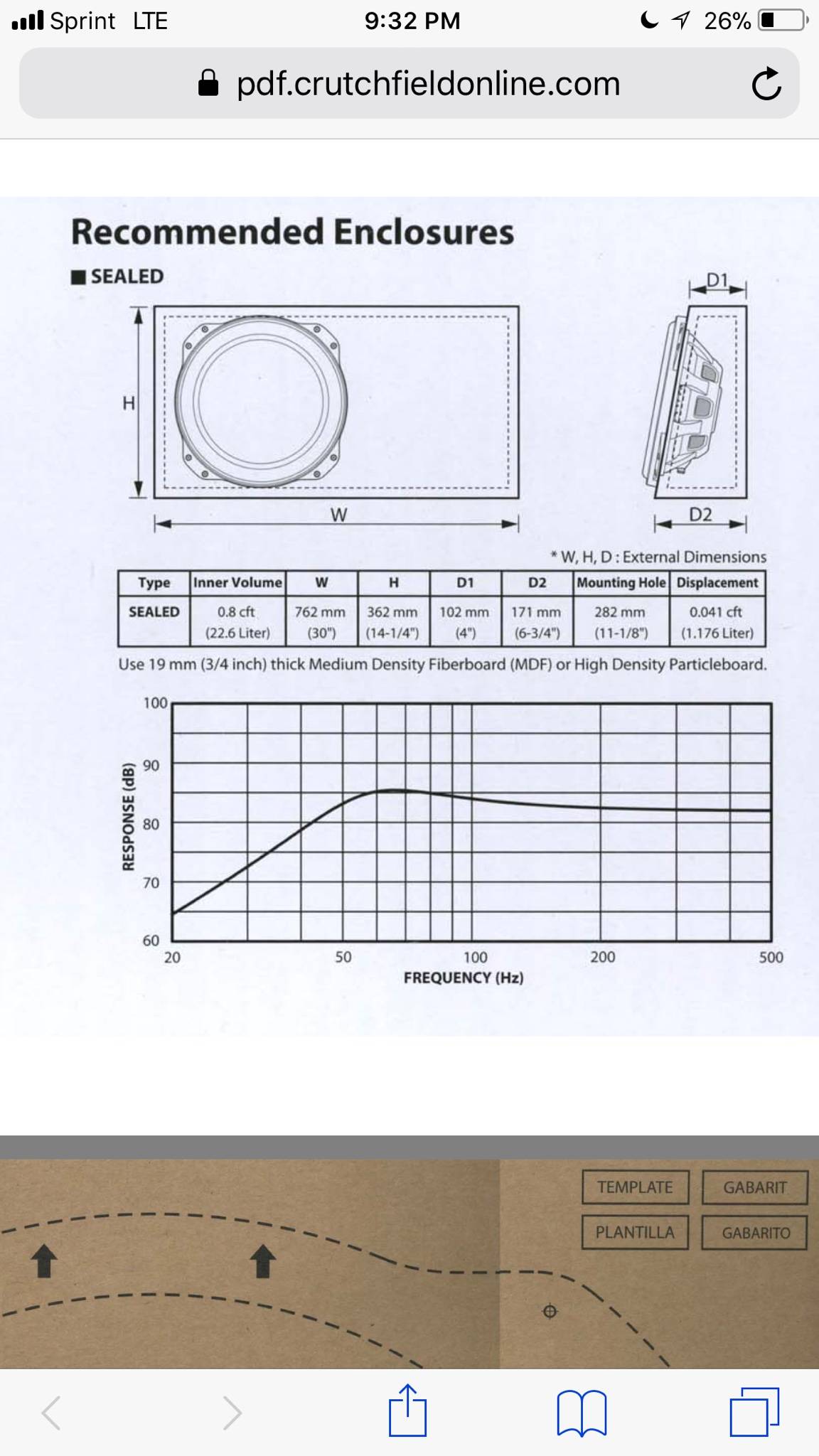

Ok so I have 2 Kennwood Exceleon XR-W12F 12” Shallow mount subs. Since I have 2 of them do I just double the width for the enclosure? Or idk I’m just confused and need help I have picture for sub enclosure build for 1 sub. How would I build it for 2
