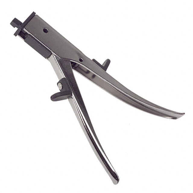

Nibbler tool works nicely for sheet metal or plastic panel trimming. Obviously power tools (dremel, hole saw, jigsaw) are quicker but they are not very forgiving.
Found one on ebay for $16, I'll wait on it, shouldn't take too long to show up. In the mean time I'll figure out how I'm going to do the grill, I don't think I want to leave it exposed. If I can't find a premade grill to my liking will try my hand at making one myself. I did try something with some cheap 1/2 in plywood and grill cloth for the dash speakers but I didn't like the finished product. I have plenty of that material left to try some other options.

Update: Here are some pics of the outcome - wound up having to use tin snips where the plastic was too thick for the nippers, and had to trim the vinyl and foam backing off the area I wanted cut because the nipper opening wasn't wide enough. I fashioned the grill out of a mesh folder holder I bought at Staples for $13. It was actually enough to do the grills for the dash speakers as well.
Comments or critiques are welcome. I'm no pro, but I'm trying, and I'm sure someone may have a better idea or different way to get it done.
