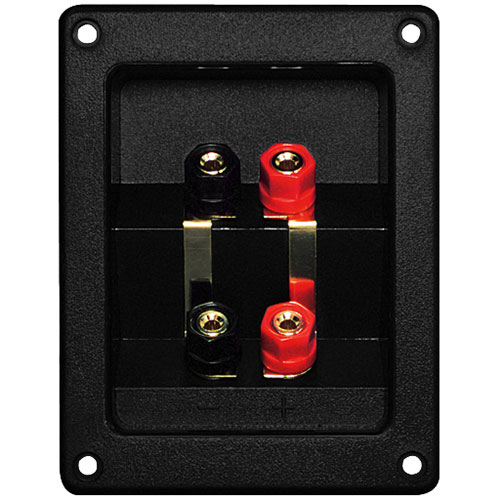

or you can make it easy on yourself and buy one of these terminals for the box (with the jumpers) to parallel the subs after you wire in series.
Gold Plated Bi-Amp Terminal 260-304
so sub #1 has coils wired in series then one pos and one neg to the top pos and neg on the terminal.
then sub #2 also has coils wired in series then one pos and one neg to the bottom pos and neg on the terminal.
the bars connect sub #1 in parallel with sub #2 .
then only one pair of speaker wires are required from the amp to the box (top or bottom) terminals.
