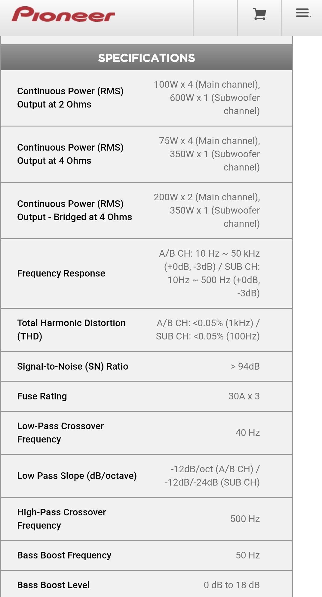

Might as well get the Pioneer GM-D9705 and save some room. It will be strong enough to run your whole setup.
