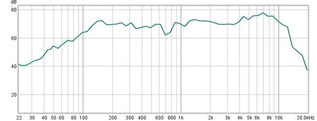

well i have measured the powerbass mid out of car in small bookshelf box i made and came up with this graph

Might want to get some foam weather strip to seal up and fully direct the sound into the car cabin. Also are you using a head unit as well or are you using the USB dongle? Yeah that dip on the graph doesnt look good but the peak is definitely from your door acoustics.
