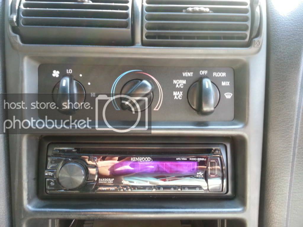

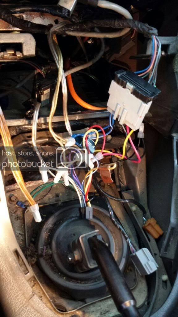

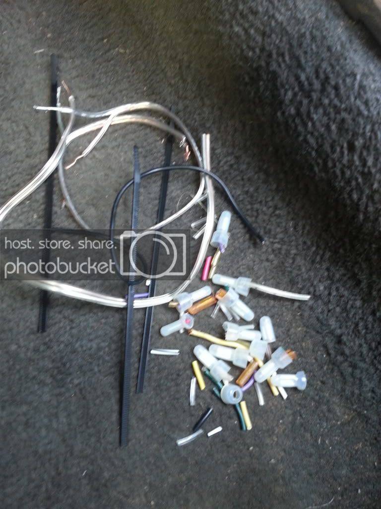

A friend of mine was having some serious trouble with his 2000 mustang audio system. Randomly shut off and sometimes wouldn't have any sound at all. Come to find out the factory amp had been bypassed and multiple speakers wired in parallel to one speaker output. Multiple short runs of short speaker wire were used to make a full run as well causing shorts along the way. Decided the best thing to do was a complete rewire. Take a look.
Before rewire
Stuff that was removed
After
Everything is working well now and as it should after getting rid of improper wiring and shorts.

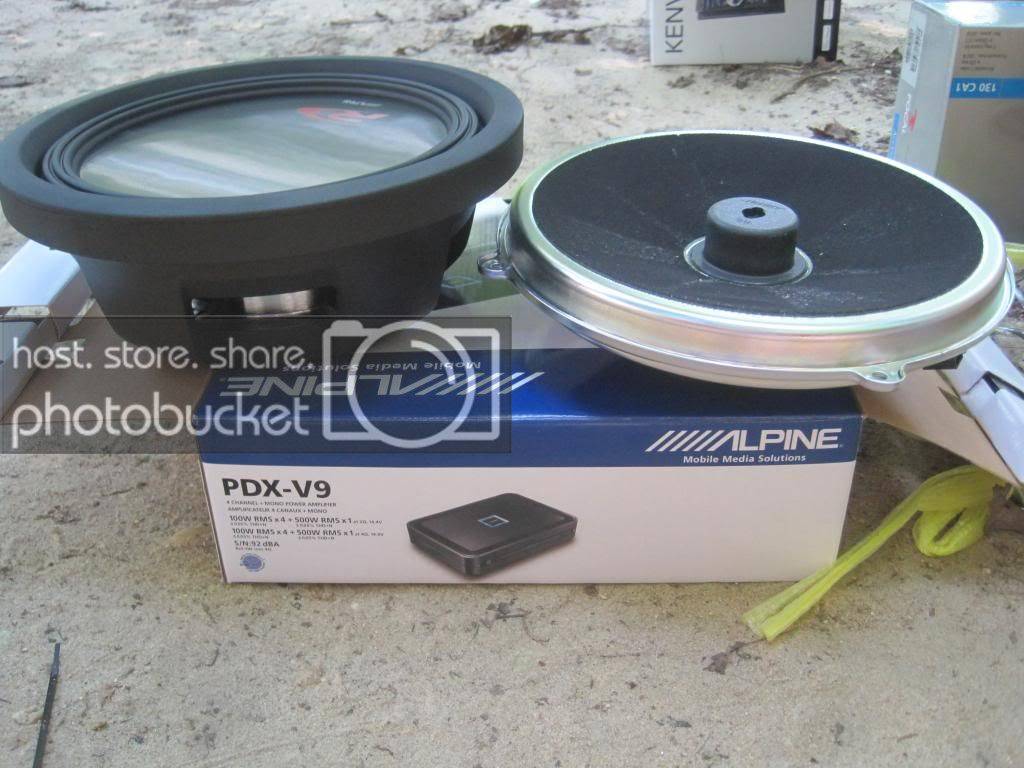

Installed:
Alpine type R Shallow sub
Alpine PDX-V9 5 channel amp
Focal 5 1/4 rears
Hertz HSK 165 fronts

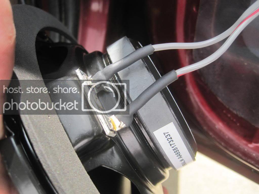

Head unit harness solder, heat shrunk, and zip tied.

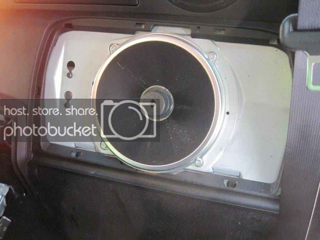

Factory sub was removed
New sub test fitted

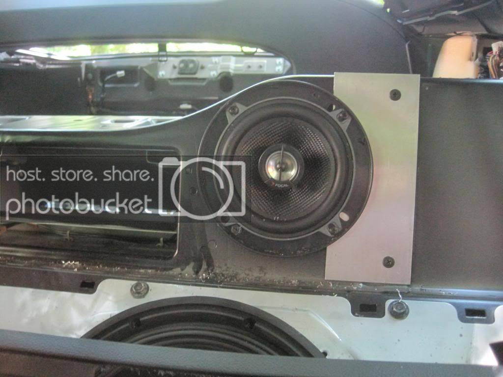

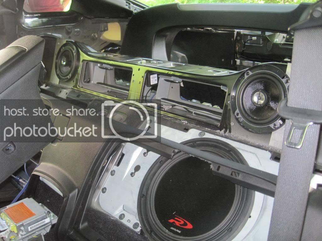

Rears installed

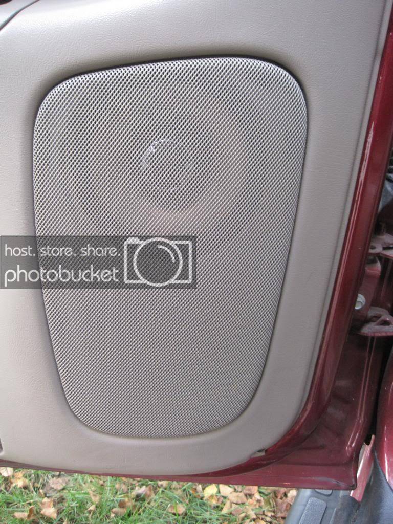

New speakers just barely have enough space to clear the door.
Tweeters installed

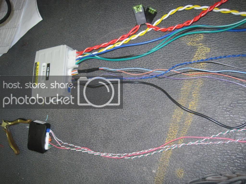

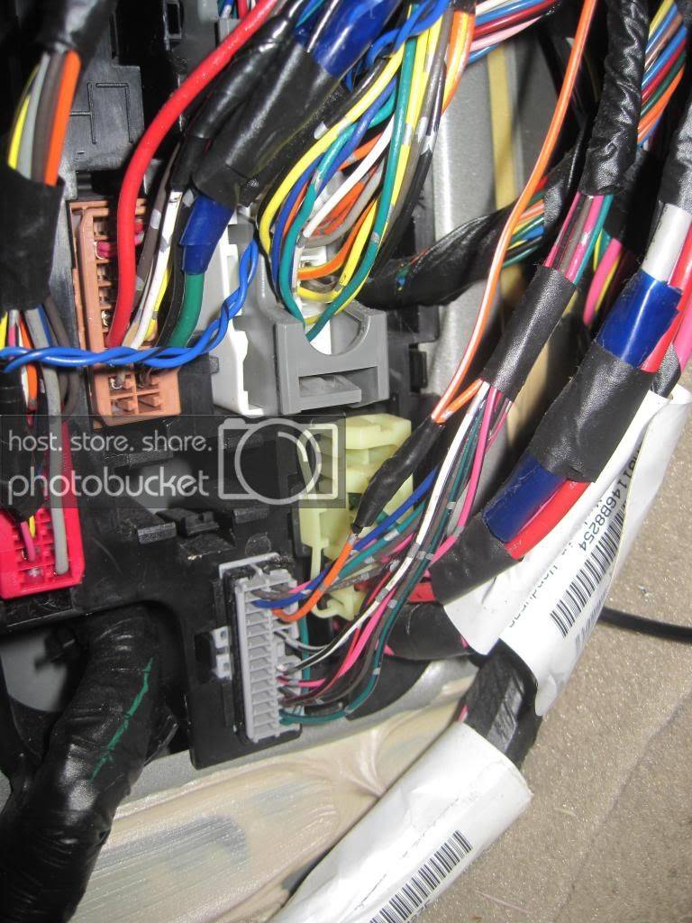

Get your remote start done the proper way. Installed a Compustar CS-800 today in a 2007 Hyundai Sonata today. All wiring was prepped ahead of time and twisted to lose slack.
Installed antenna
Installed the brain behind the fuse box out of sight and away from everything. Than routed all wires to their locations.
All wires shortened and installed.
