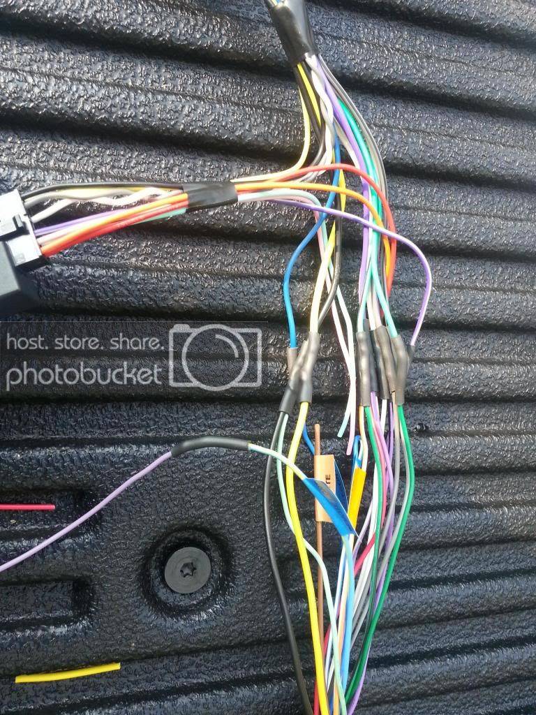

As I do all my work, I soldered and marine grade heat shrunk all the wires, sadly I was in a rush and did not take a picture of this.

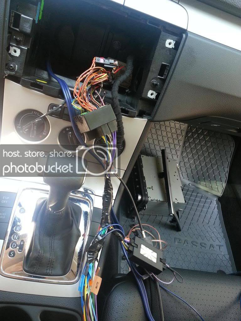

Wires ready to go.

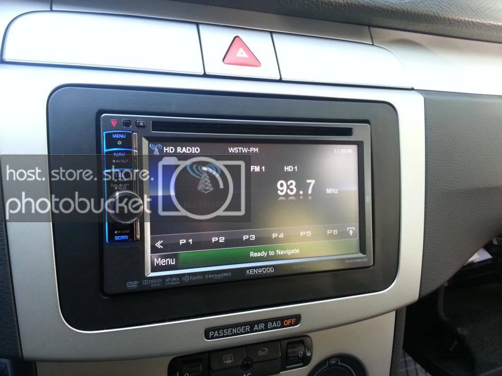

Head unit installed in the metra dash kit.
Installed with trim ring

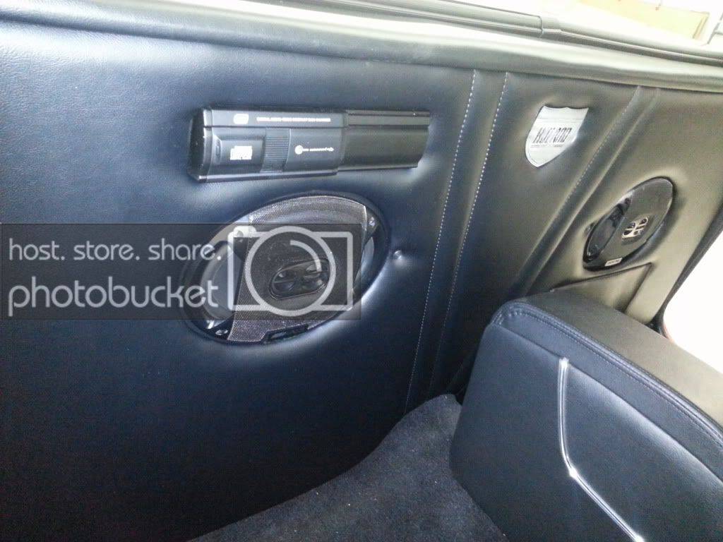

The CD changer was mounted using aluminum brackets secured to the back lip of the rear wall.
Pre made kick panels were not deep enough for the woofers, nor did they have a cut out for a tweeter. Spacers were made and will later be routed and painted, fallowed by upholstery.
A new dash was made (not by myself) and the display was installed.
A bracket was made to install the brain as well on the back wall. The one strip going along the back wall has a gap behind it and worked well as a place to secure everything without going through the wall.

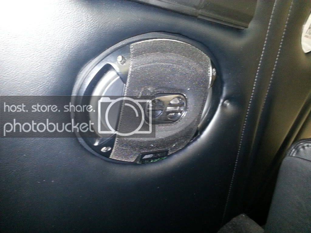

The customer did want rear speakers so I made a set of basic boxes and mounted them level and flat, as the back wall is actually angled back.

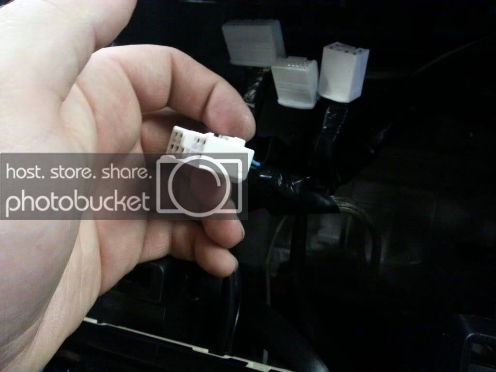

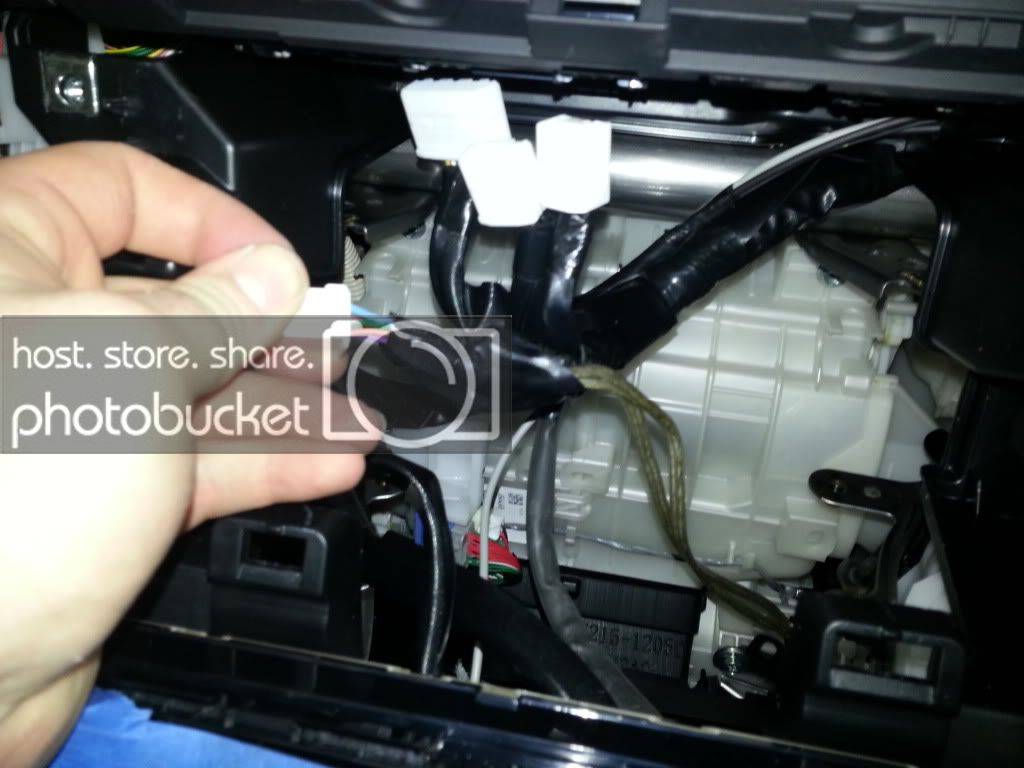

I did a simple stealth install on a 2012 Prius, with the first hybrid being done it was different than a normal car but not by much. The owner wanted a stealth install with major audio upgrades in quality.

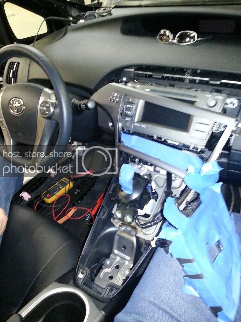

Removed dash panels making sure not to scratch them with painter tape.
Speaker harness needed for the audio control.

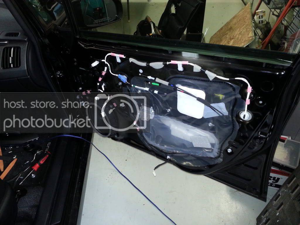

Door panels removed

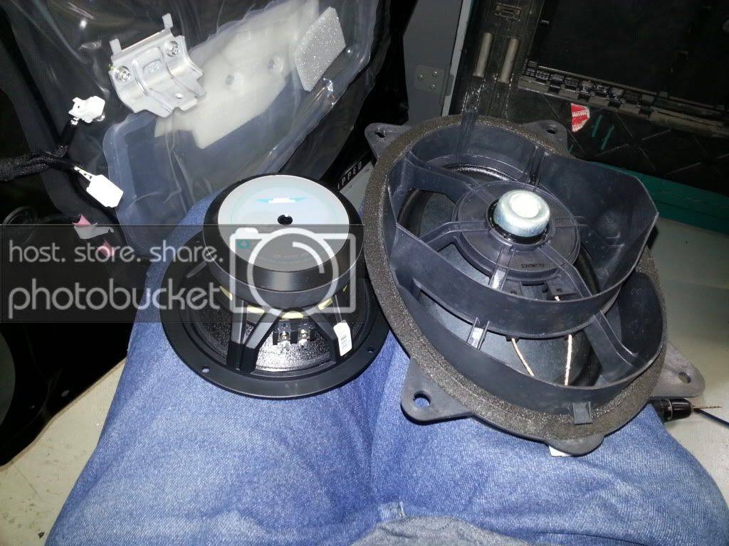

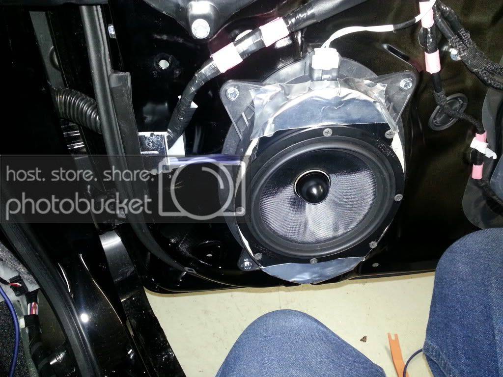

Old stock speakers vs new ID CXS speakers

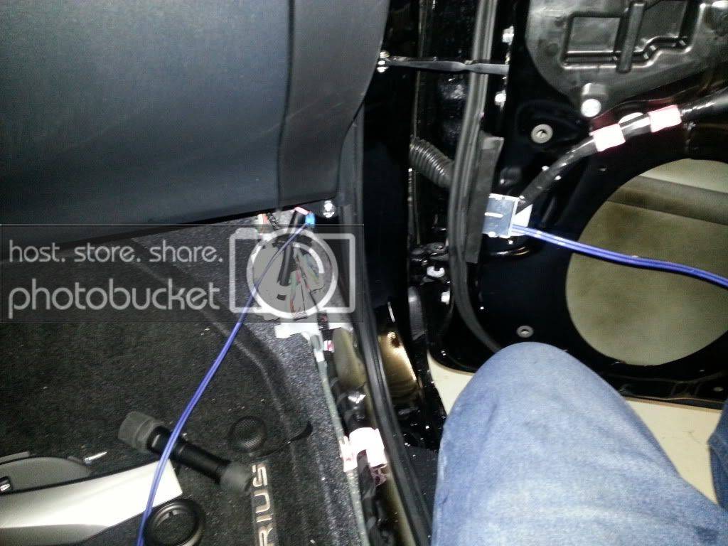

New speaker wire ran.
Wires soldered and heat shrunk
Installed

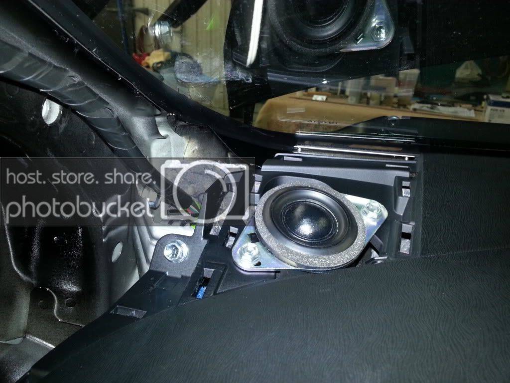

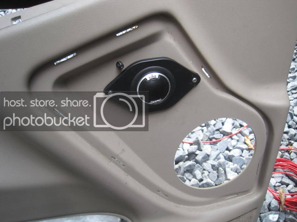

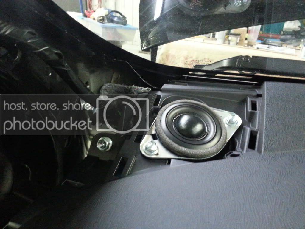

New tweeters using factory location and factory brackets.

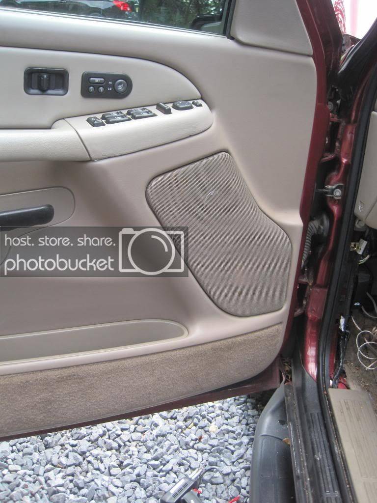

Today was a simple upgrade. A family of a friend of mine wanted better sound for their trip. Sense the speakers were 11 years old it was to be expected. Upgraded the fronts and rears with polk DXI's which were hands down better than the stock ones which by now were deteriorating and sounded awful. The family only requested something cheap and the install was stealth.
The car
Panels before

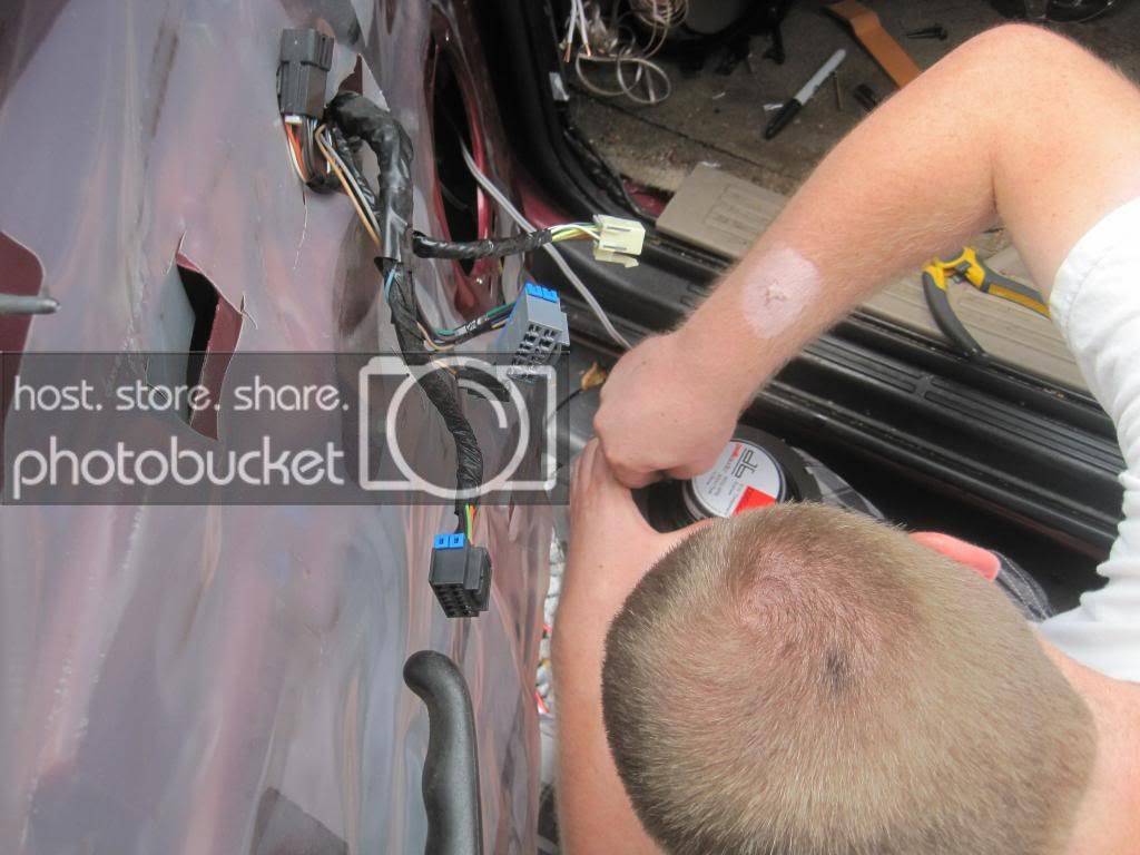

Running the factory wire back through the stock grommet to install the crossover inside the cabin. Speaker wire was than fed back to the speakers.

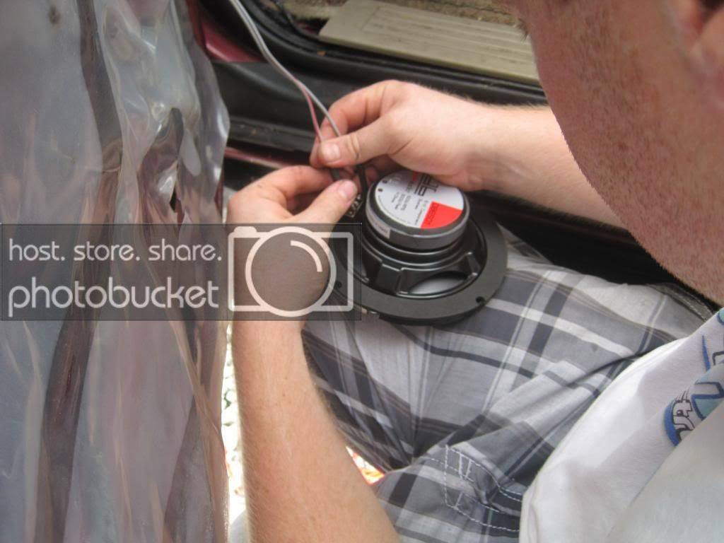

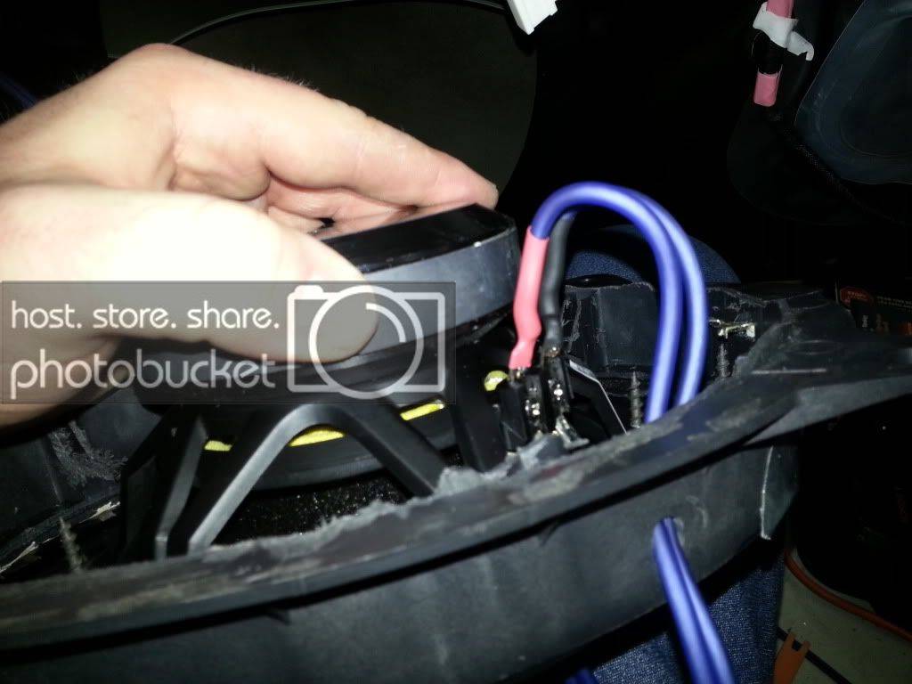

New speakers being wired up. Soldered and head shrunk
