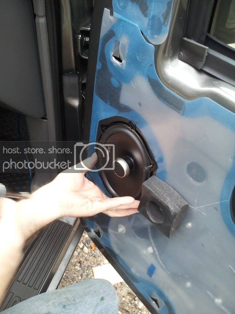

Remove door panels

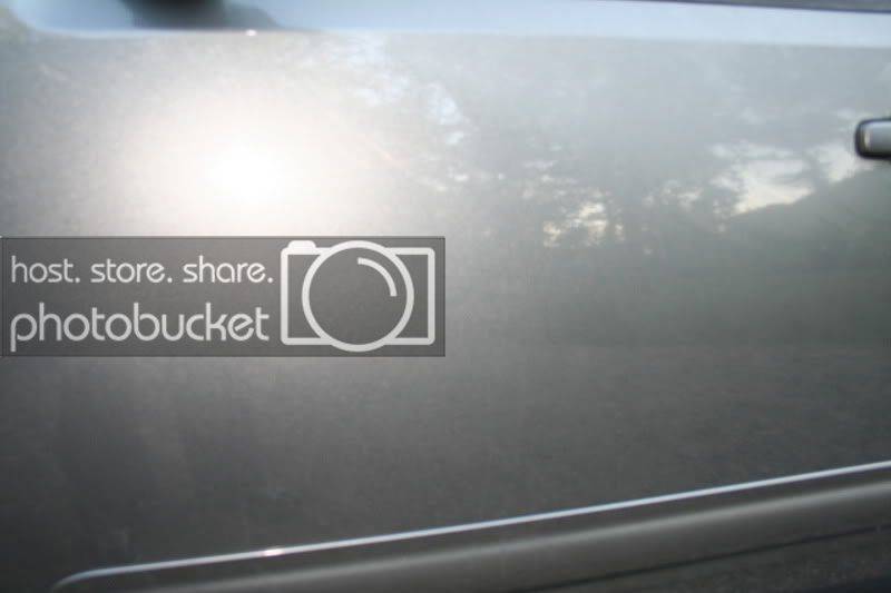

Swirl and haze remover
Polish

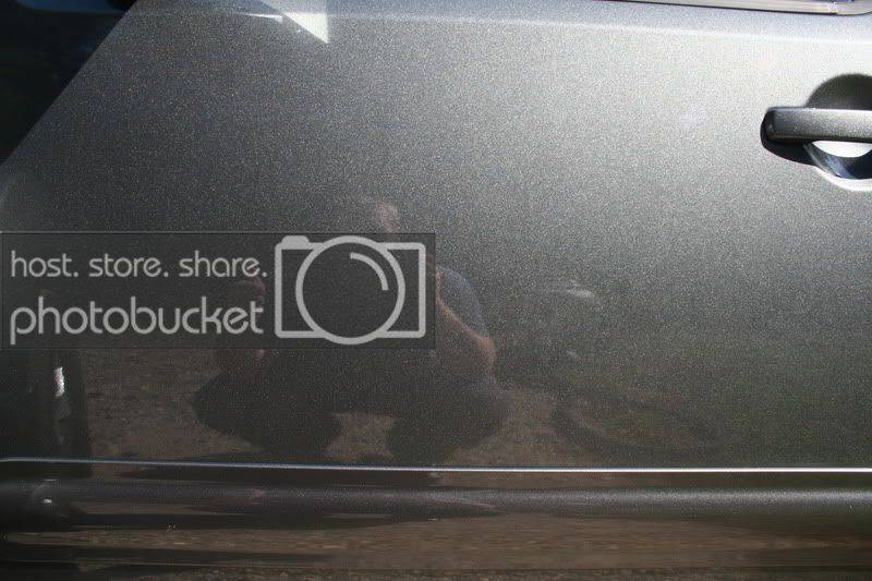

2 Coats of Americana
The car
Look at the trim!

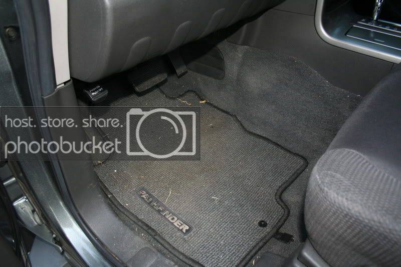

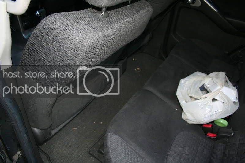

Interior was not that bad considering they have 2 kids.

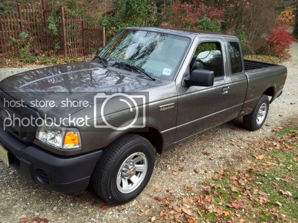

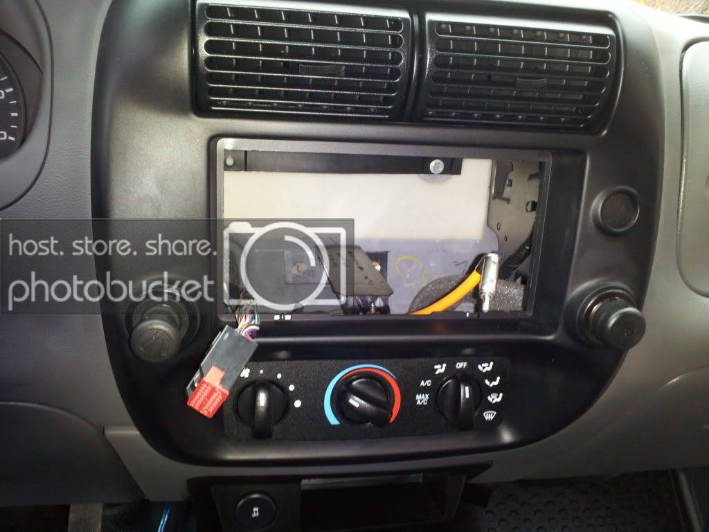

Today I takled my fathers new truck. The audio quality as usual was poor and lacking. So after planning things out we got at it.

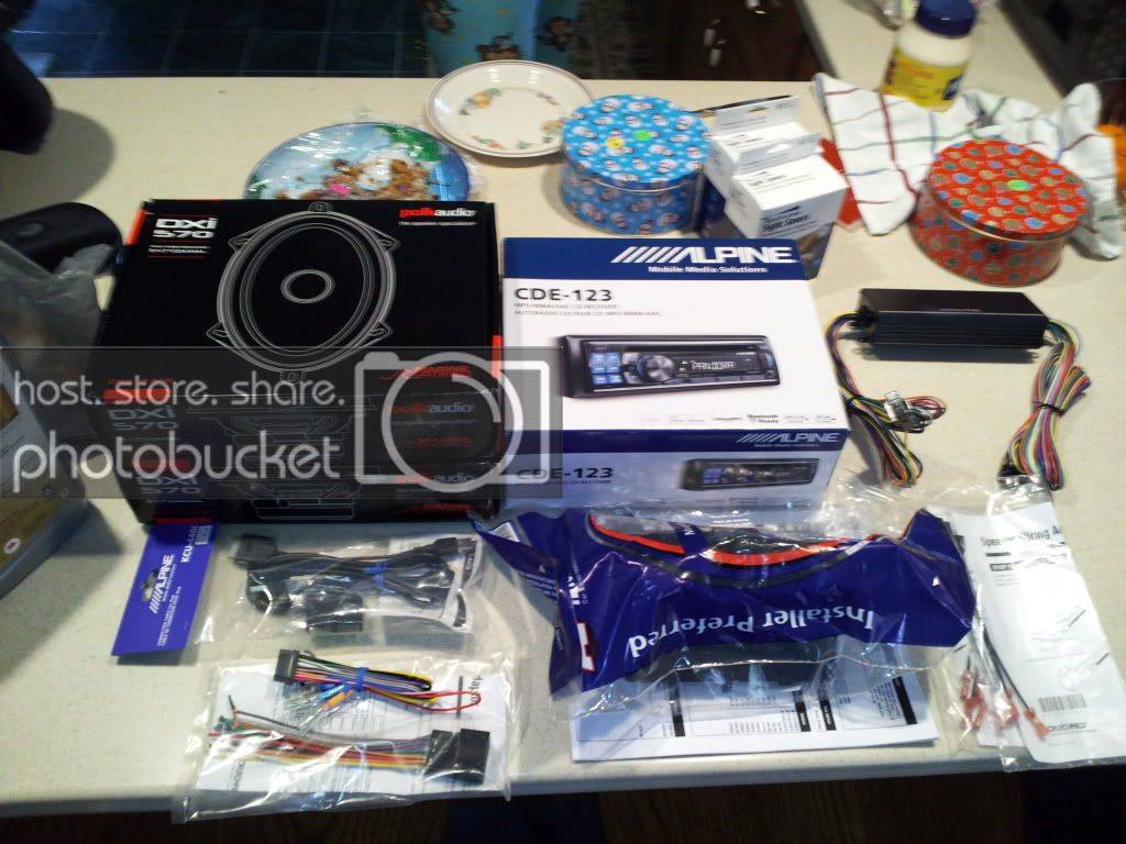

The products

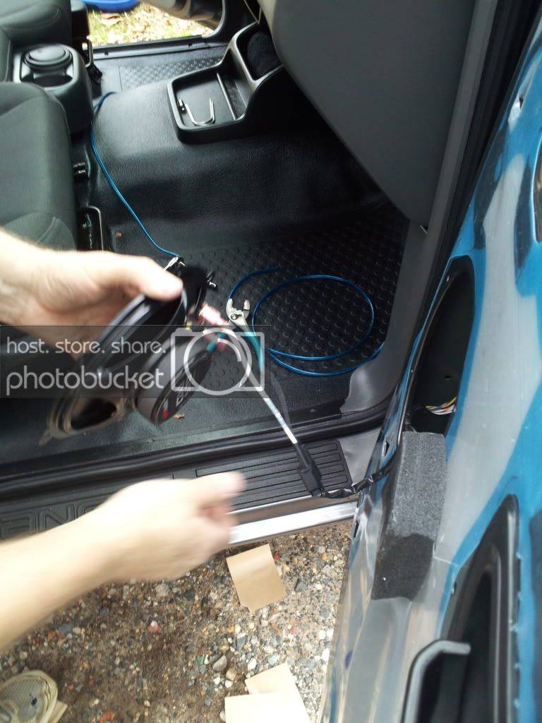

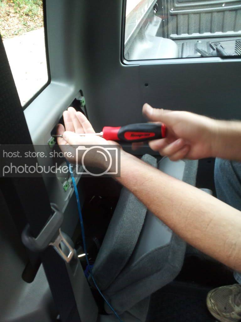

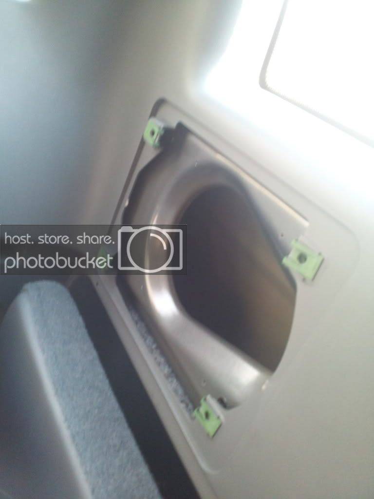

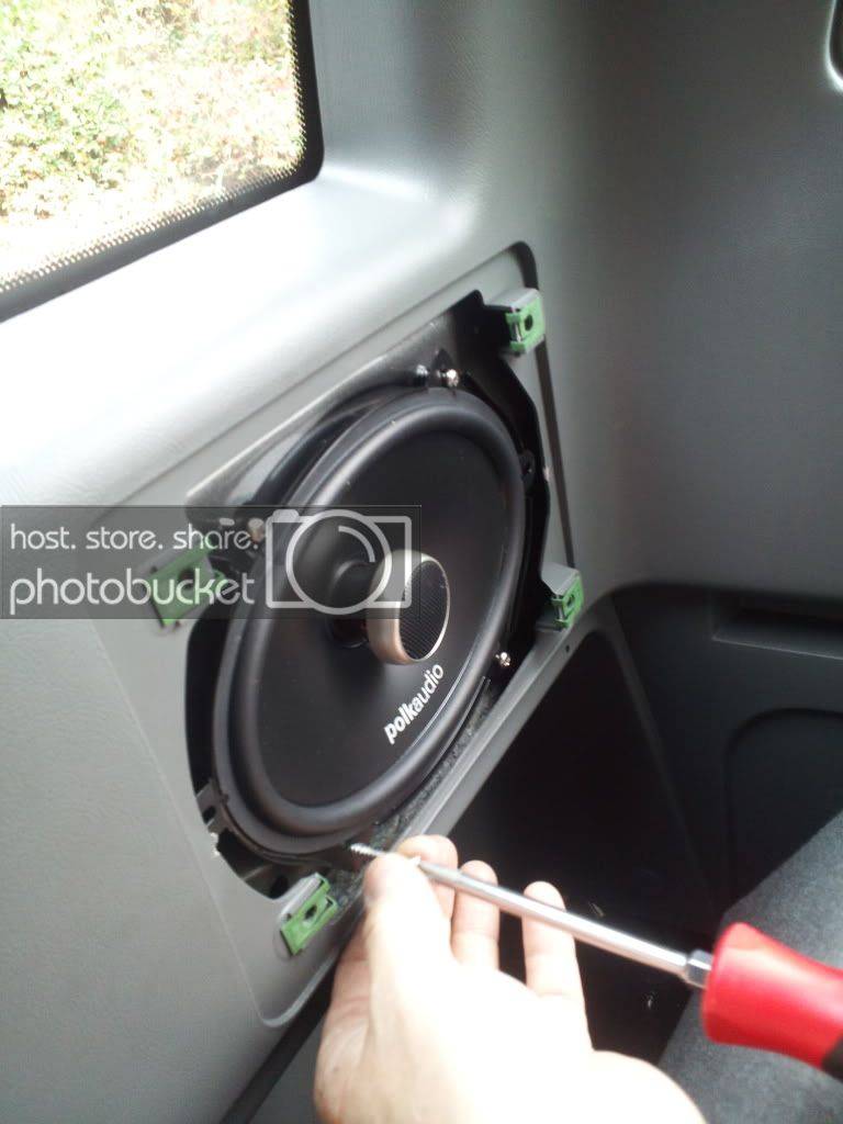

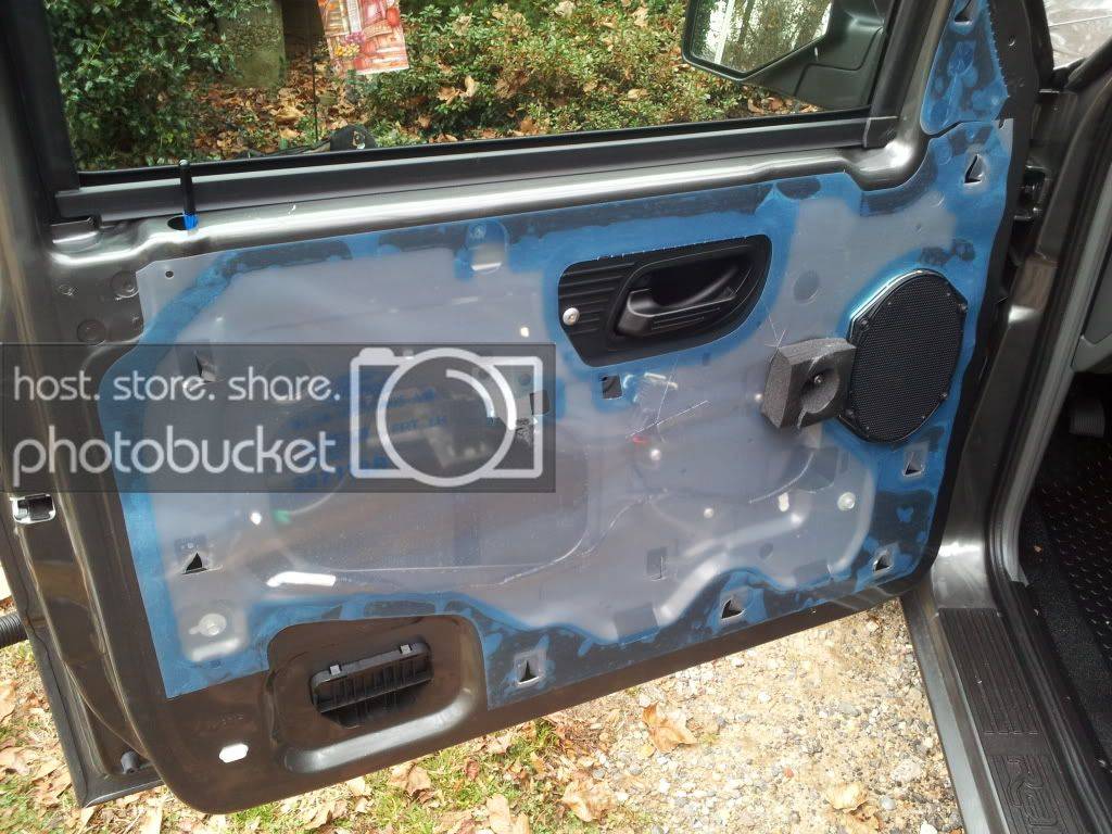

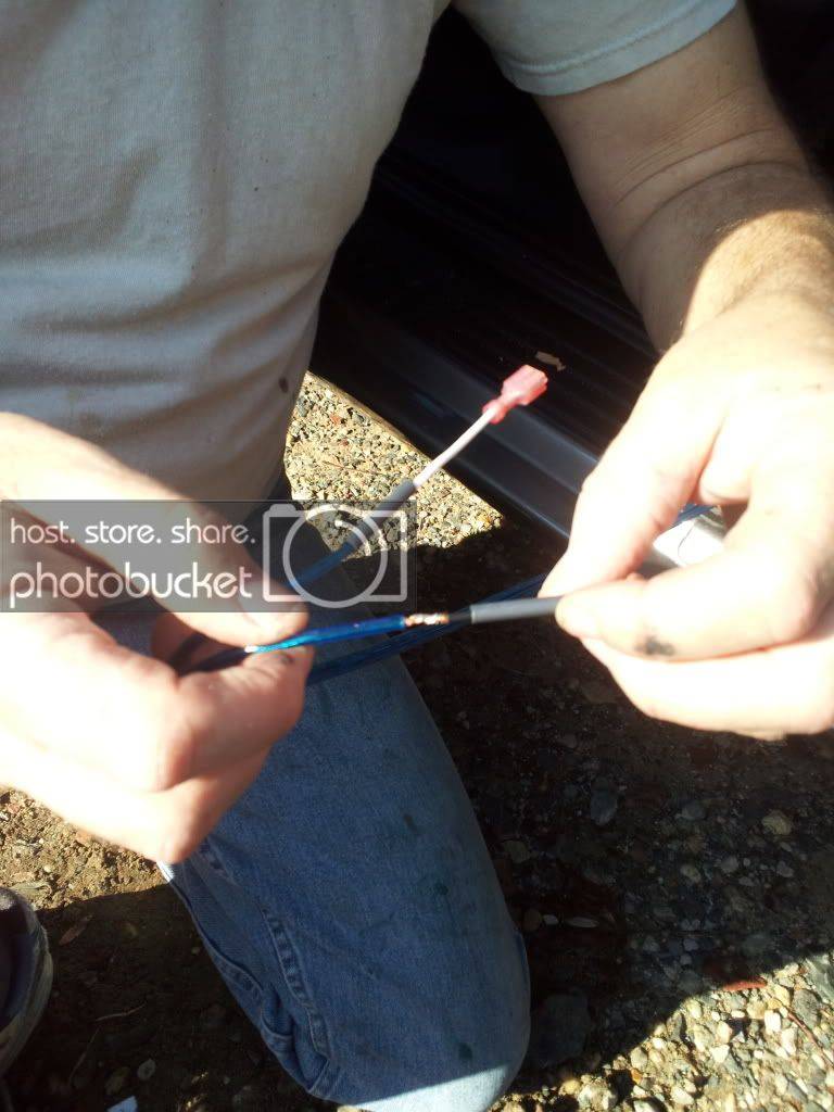

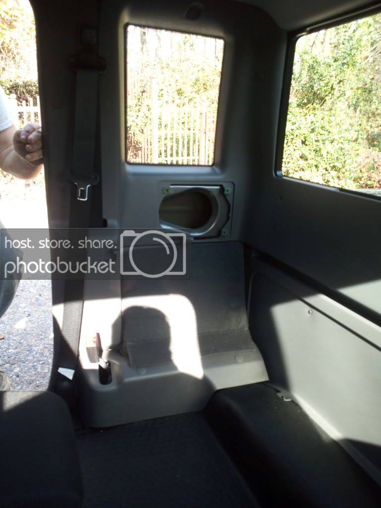

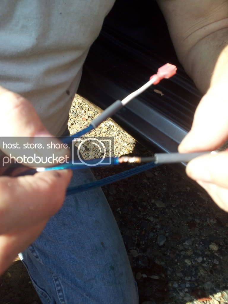

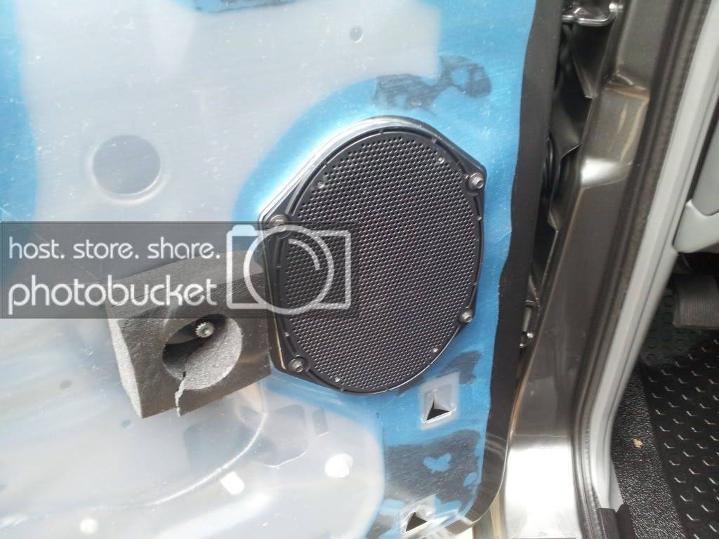

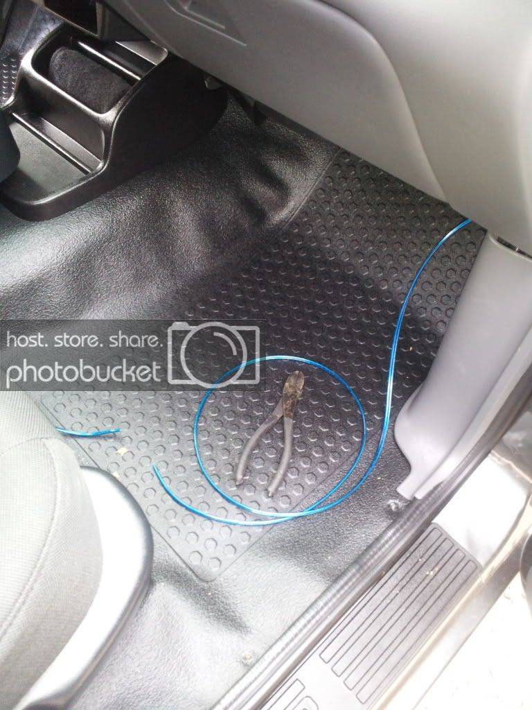

No rear speakers so we had to run new wires and drill holes for the speakers.
Soldered and heat shrunk
Wires ran to the front
Fronts were plug and play

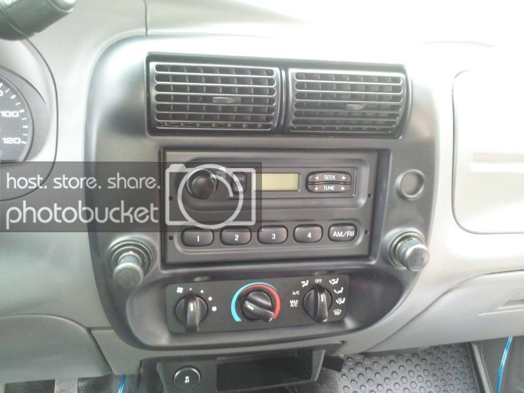

Head unit
OMG so small

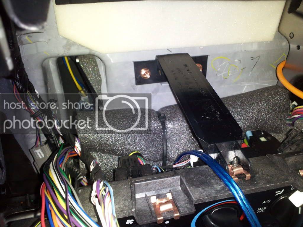

Alpine power pack wrapped in foam and tucked in dash. Had to hard wire the rear speaker wires to it.
Done

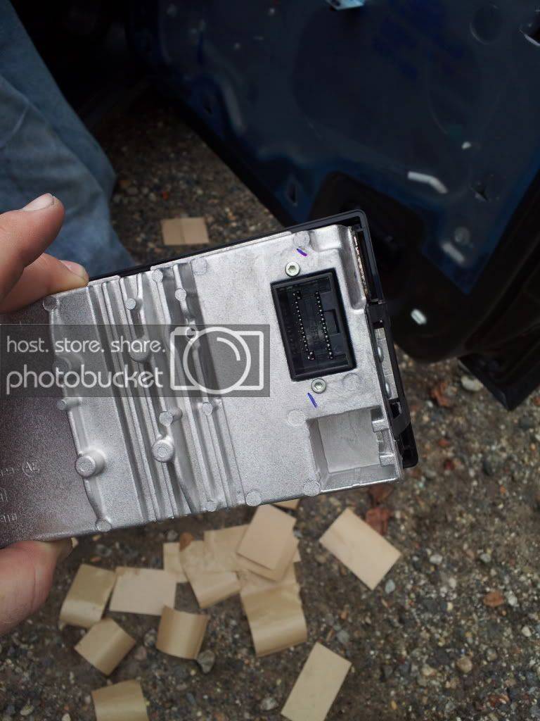

MS-8
