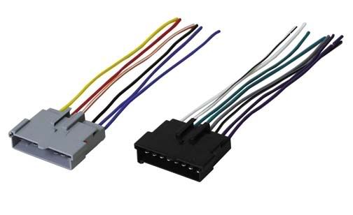

hey all i just got a new car which is a mercury mystique 1996 and i cant get the deck working with sound... i've bought the harness and it has 2 connecters that looks like this
LEFT SIDE:power/dimmer wire RIGHT SIDE:8 speaker wires
i can only use the one on the left which is power, lights and stuff... the second one is for speakers, but if i connect it, the deck wouldnt light up... so is there a way to connect the speaker wires without a wire harness? i've tried it and it is not easy to find the right wires that go together.. any help would be nice
this is the stock deck rigth now, this is the only way i will get sound
circled in red is where the second connecter in the top picture can connect to... but if i connect it there the deck wouldnt light up... when i disconnect it and connect it back to how it was originaly(like how it is in the pic right), then it would work
circled in blue is what i think is the real speaker wires but iunno what to do

http://www.crutchfield.com/p_120705510/Ford-Receiver-Wiring-Harness.html?tp=2977
you are right there is an amp behind the glove box.
hmm is that harness the one i need to get? cause i had a choice to buy a harness like that but i didnt want that one... i took the other one without rca ends... for some reason i cannot get it playing with sound, even with this hooked up
but its not the exact same as pic, its cut in half and i have the smaller peice, what i did was since it was cut in half and was bare wires, i connected it straight to the deck and plugged it in, no sound
i also have this one which came along in the pack, but its not hooked up because i got no idea what it is for...
right now i think i wanna remove that shitty amp and use my thump amp i have for speakers.. if not just hook up the speakers without this crappy amp...
