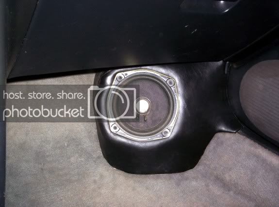

Thanks everyone gettin some very good information here. Few questions tho. I thought kick pannel was down at the bottom from of the door near where its hinged //content.invisioncic.com/y282845/emoticons/confused.gif.e820e0216602db4765798ac39d28caa9.gif.
Kick panels: (taken from another post)
