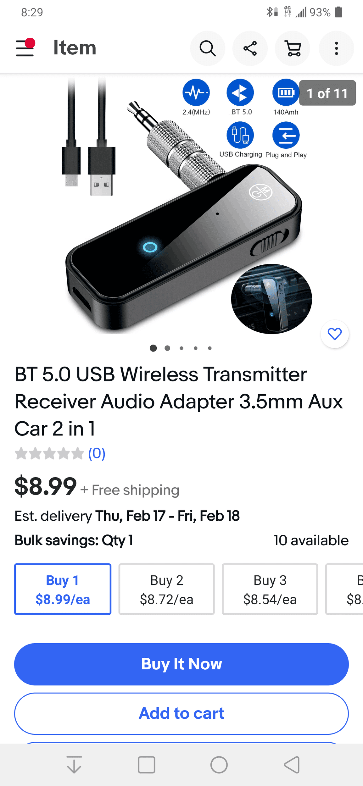

I do not know about your issue, but I think your best/easiest solution would be to use a Bluetooth receiver. I have used them for years with little issues.
