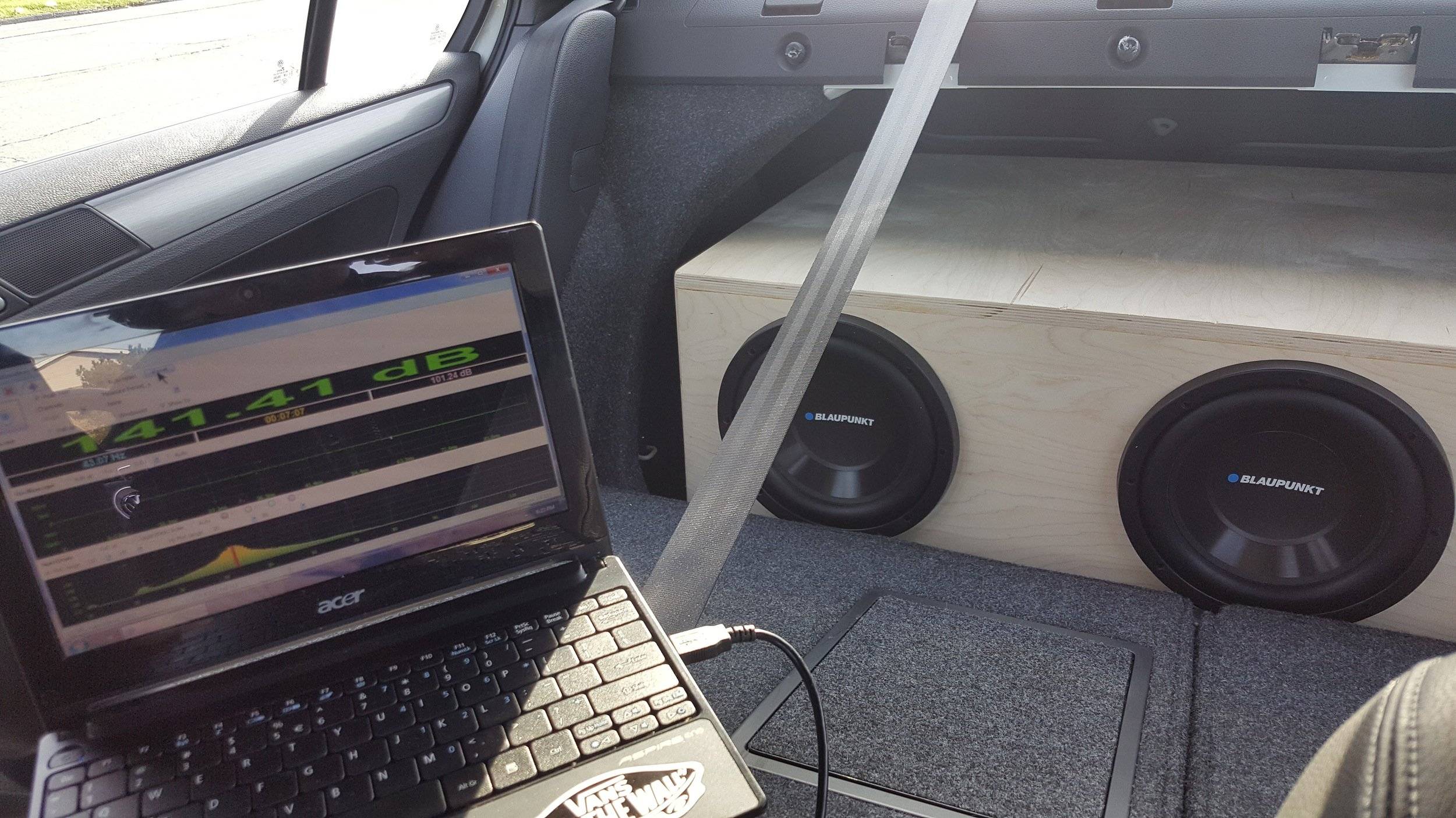

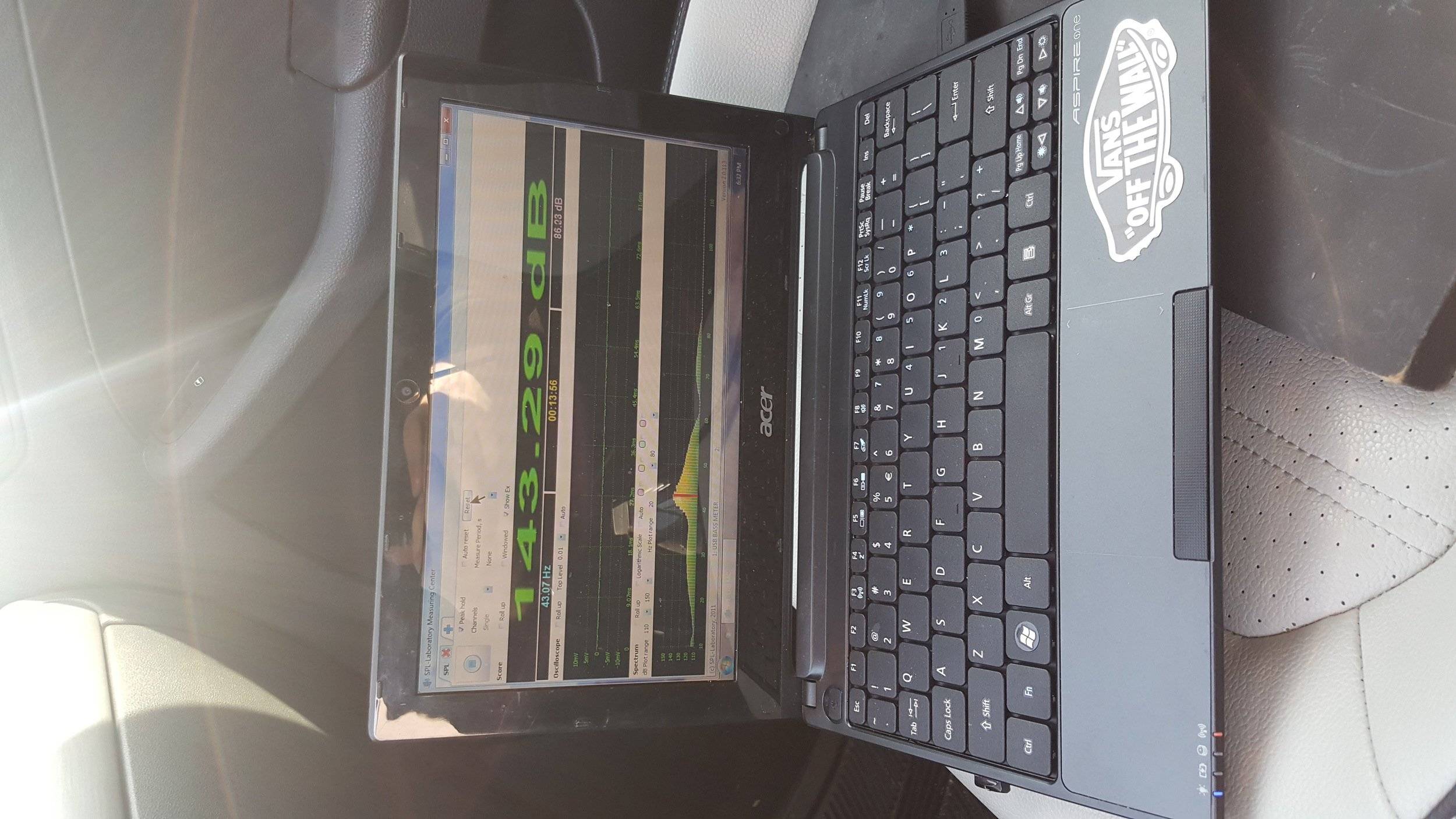

1.6cf isnt always oversized for a 10. I have 2 $18 10s in 4.2cf that do over 143db from the trunk....AND they play music great.
