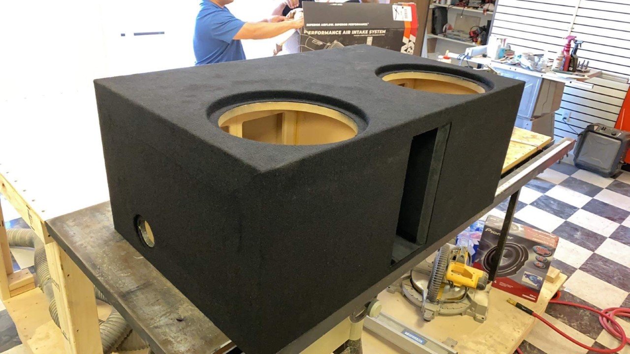

This was a dual XFL-12 box for a suv (Escalade) on higher power (5K @ 1ohm) and it did super well.

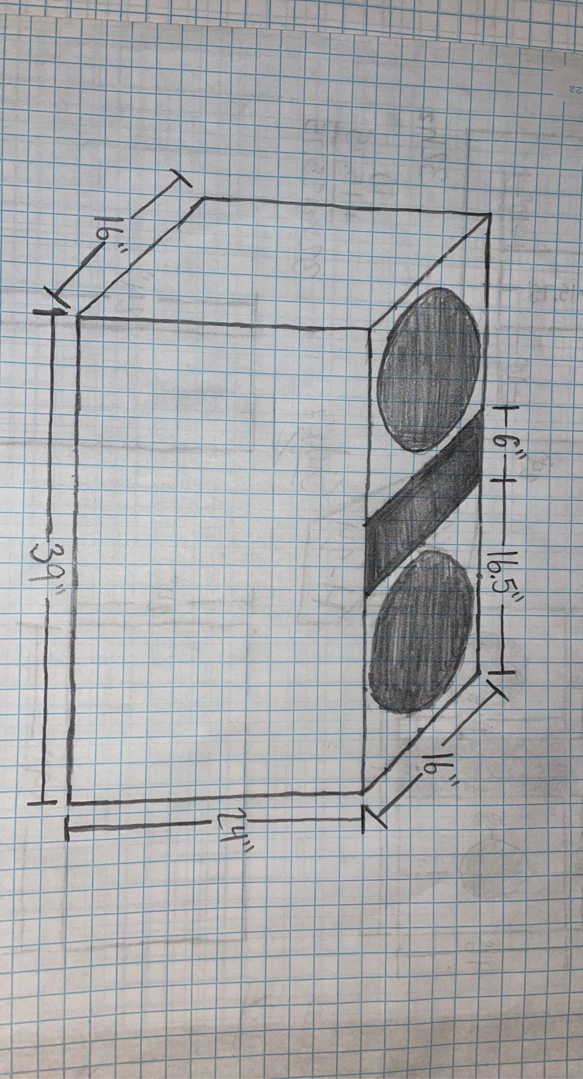

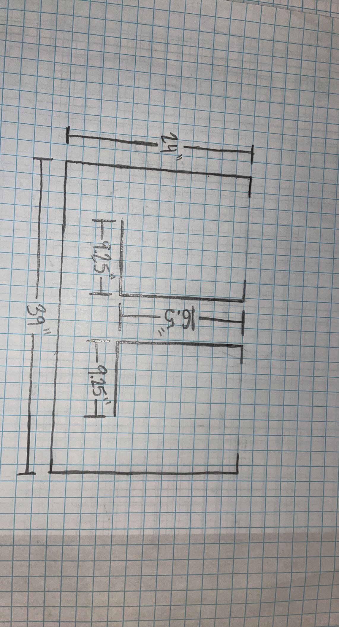

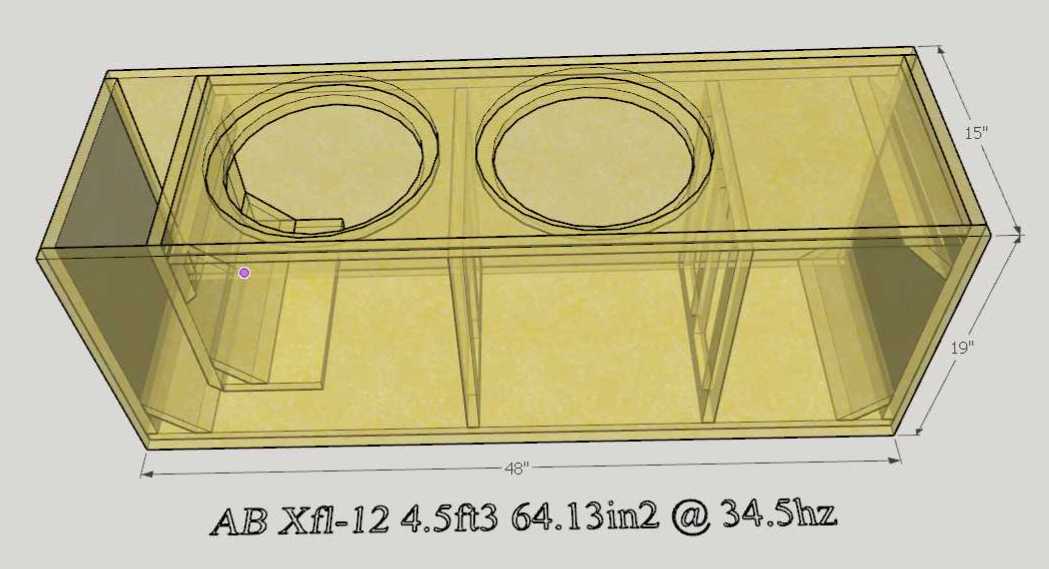

I’ve actually modified the first box you sent and put the subs on the same side as the port. I have it sketched out on graph paper and did the best I could buy I’m still a noob. Do you think this would work? If so it would be the best and easiest option for me.
I’ve actually modified the first box you sent and put the subs on the same side as the port. I have it sketched out on graph paper and did the best I could buy I’m still a noob. Do you think this would work? If so it would be the best and easiest option for me. View attachment 26984View attachment 26985View attachment 26986

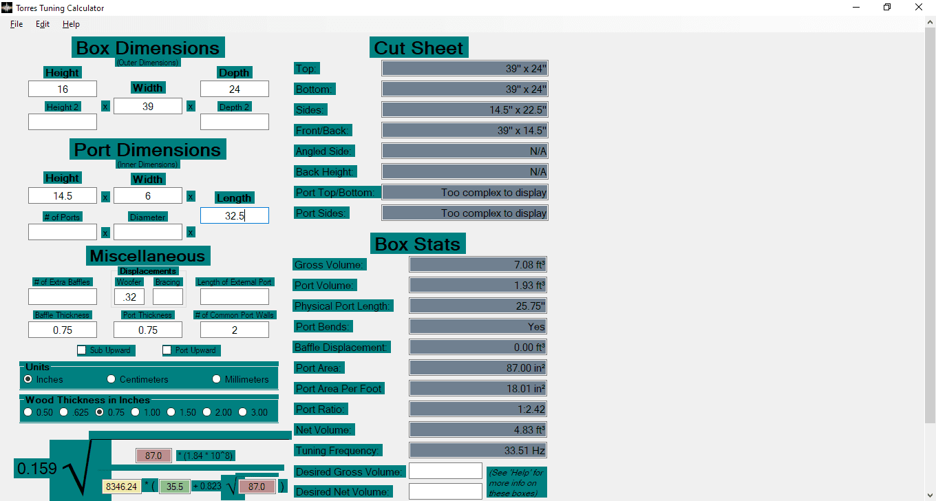

This is what you got drawn quick and dirty...
26995
That's single .75" materials without bracing, single baffled because you were not specific. I'm assuming it'll be subs/port up?
The port area looks a little excessive but as long as the port width changes to 1/2 the exit width (6") to 3" after the bend you should be fine.
Myself, I'd keep the port area per foot in the 14-16in2 range for those Xfl's on your power if you actually get 3K out that amp.
Yeah I’ll be using 3/4 birch or 3/4mdf, haven’t decided yet. I was planning on doing a double baffle. Idk about the bracing I’m new to building boxes and have no experience, that’s why I posted here. Any tips or constructive criticism will be appreciated.

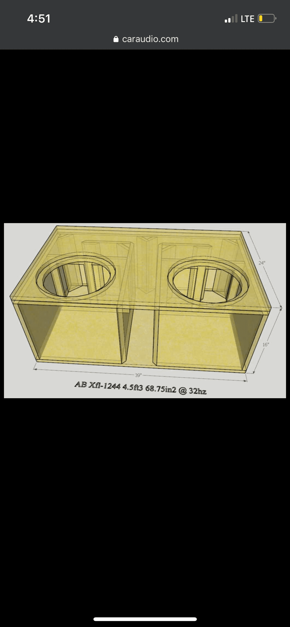

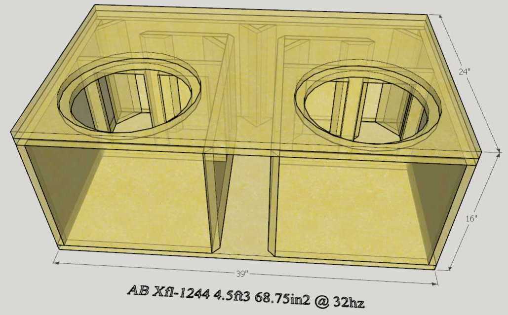

I can design you a box if interested. My favorite airspace for XFL 12's is about 2.25. Used to work with an AB dealer, got to install and hear a lot of them. XFL's are one of my favorite woofers.
That would be great! I really like the box dimensions I already have though, can you keep those close if not the same and just change the port? I’ve don’t have any experience with this and didn’t realize how much went into it until I started researching it. Any help would be nice
