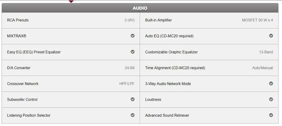

the 600ex is a decently spec'd HU. 24 bit d/a converter and 4v pre-outs, 13 band eq, and the ability of active crossovers (which you wouldnt be using in a front/rear speaker setup, but its worth mentioning because not all decks can do this). Here is the spec listing for the output section. If this is your amplifier and you have very little output, then youre doing something wrong. Dont get me wrong, those arent hugely powerful amps, but they arent wimps either. 50 actual watts at 4 ohms is fairly decent to the front and rear stage. What speakers do you have installed? Where are your gains set? What source are you using(i ask this to see if you have attenuation issues in the deck setup). What is the model of the 1000 watt amp on your sub amp?
What im trying to say is that the stuff youve mentioned so far that you have in your car seems like a list of stuff that would definitely not equal weak output when you crank it up.
the 600 deck is better than the 211 you mentioned. put the 600 back and address the setup issues and youll be good
