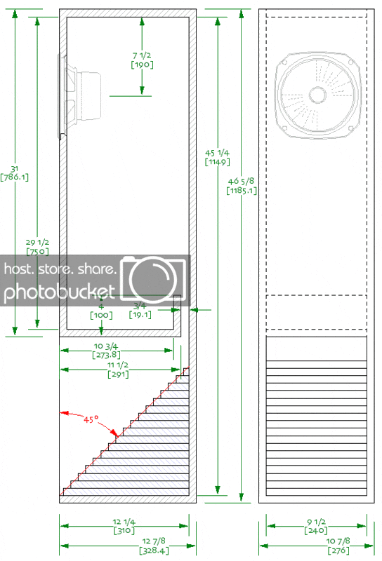

Exactly. I am a college student and am living on the 3rd floor next year with no elevators, so the BIB's will be too much to haul around. Plus, I only have a Grand Cherokee, so that ~4ft height is pleasing. I think im going to do the Half Changs if I can find the plan for them. Put a couple coats of bed liner on them and let their college lives begin. And Im guessing since people are only sending them 20-30w, then a receiver that puts out 85wpc will be enough for these?
I got it for ya
//content.invisioncic.com/y282845/emoticons/smile.gif.1ebc41e1811405b213edfc4622c41e27.gif It would be a good idea to add some kind of hole bracing in the cabinet BTW...
Edit: Also you can replace the "steps" with a single 45 degree angle piece, which is what I did, just do the math...Its a fairly straight forward build, just take your time...
Sweet, that looks real easy. Whats something good to put in the bottom to weigh the cabinets down? I was thinking a couple gallon bags of sand in each. And is tweeter placement important? Also, is rounding the edges around the port necessary? I know in caraudio boxes, it helps reduce port noise, and I would think its the same in this case as well.
Yes sand would be good...I didn't round over the edges and I get no port noise, if you want to do it then more power to you...
Tweeter placement isn't wildly important...Just place it somewhere at ear level when seated, I just stuck them on the 1 and 11 o'clock positions on the left and right cabinets, respectively...
Fill up the angled bottom compartment section with sand for stability.
There is no tweeter, it's full range.
Rounding isn't terribly important but it is a nice touch.
