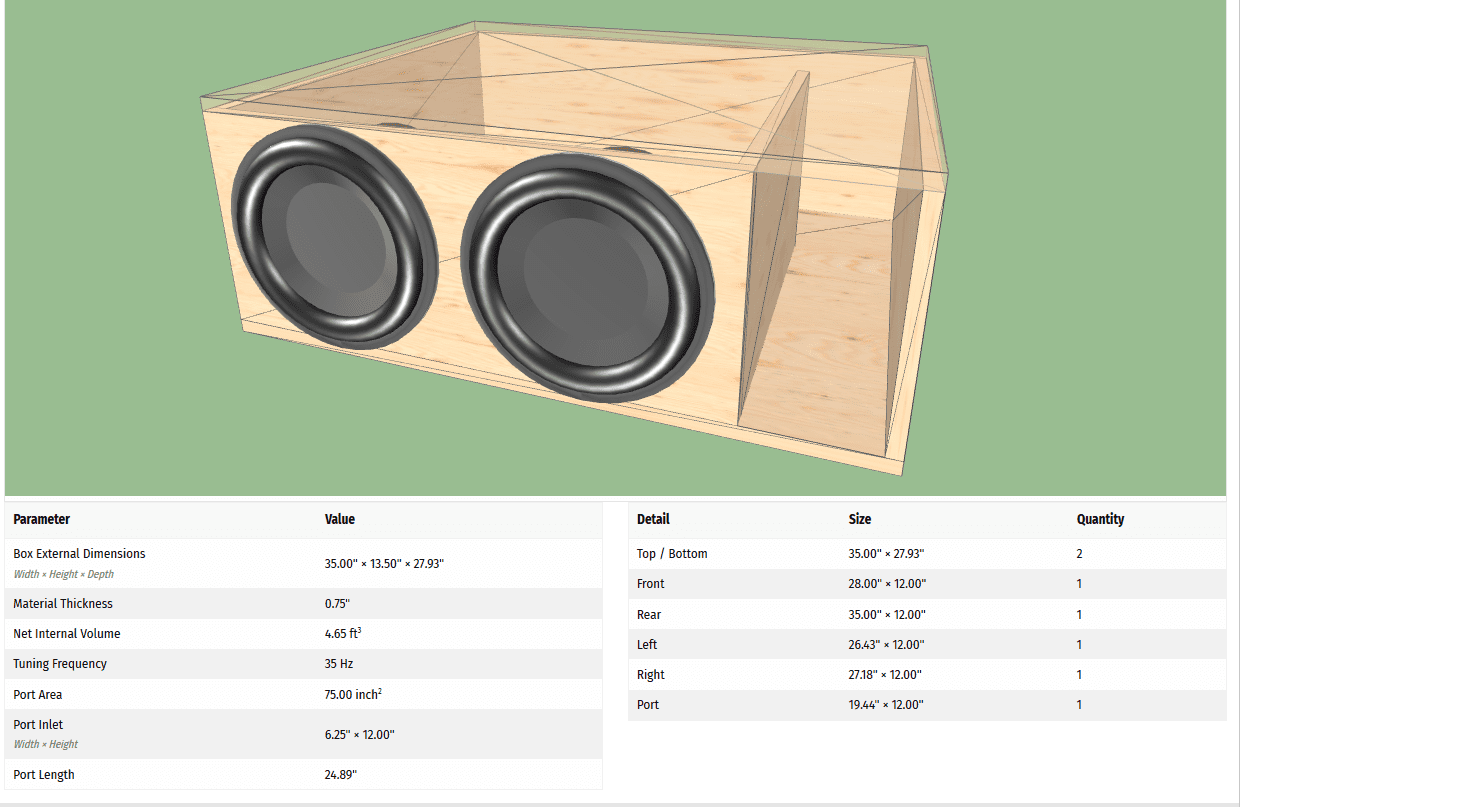

Thanks for the insight. This is what I'm thinking right now:
27683
Wondering if I should go for 4.25in2 and 81in2 port, it would end up being the same dimensions. I feel like more volume would be better.
27684
This calculator makes me wonder if 75in2 is just too small.
That subbox program again... its like a pox on car audio. Made Gramps a designer overnight... lol.
What's wrong with that website? Thank you, but we cut some of the trunk and got 5.0ft3 Net with 90in2 port tuned to 33hz.
Cut the trunk?.. what exactly dd you do?
Trim under the deck or the lip to allow more than 14"h?
90in2 of port?.. you must be "clamping" 5K on some Zv5-12s. I thought you had a smart3? Not a 7500 wired into the dirt.
Subbox is a calc. A basic one that does not take into account power and cannot predict response. And that spreadsheet on power vs port area is **** too. It looks similar to that one that was going around on Smd forums awhile back.
Seems to me that you're caught up trying for excessive port area. I took a look at those subs and either the parameters are off or I'm stuck on stoopid.

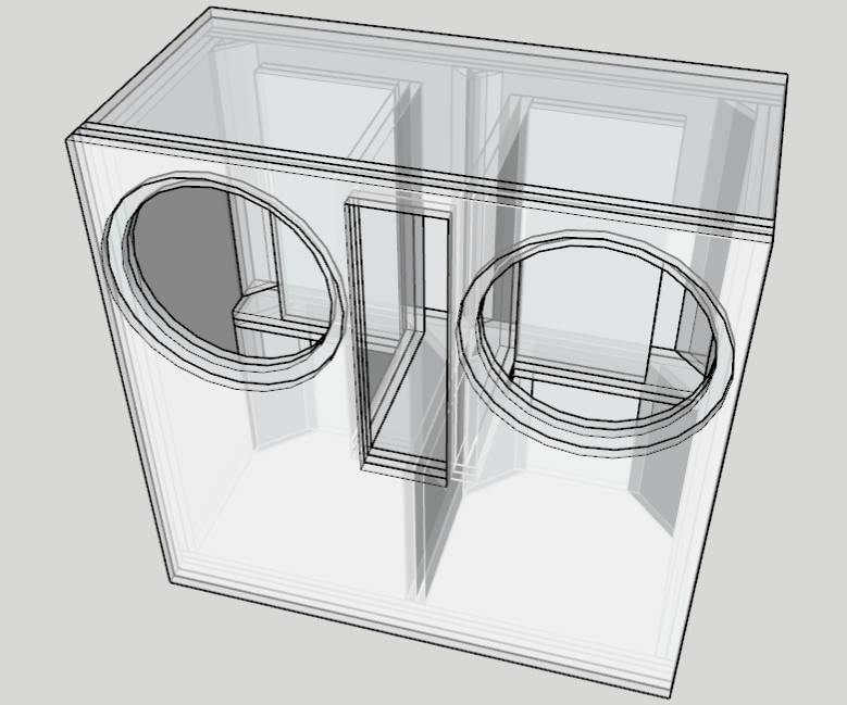

I went thru some designs I have for dual similar 12" subs in basically the same footprint and found this...
This ought to do just great in your application if the height works. The guy I did it for was and is loving it. Its on almost the same power a Smart3 /w/ good electrical will make, and has a touch extra area in the port for higher power burps.
If 17.9^ft3 of port aint enough for those Hawks I'm just going to quit right now. In my exp you'll need more capable subs than those AB's you've got to need even this much port.
It's basically built already, waiting on alternator. So how negatively will the 90in2 impact output if the subs are 'clamping' 3k?
You'll never "clamp" 3k with a smart3 out of a lower tuned musical box on burps so I wouldn't overthink it.
My point was why so much port? I thought your original question was volume vs port area for gains on your power.
That port is gigantic. And, something like 40" long. Why such a big port? Is he just wanting a straight SPL box?
I chose the giant port because that's what the spreadsheet calculator I initially used called for. And initially the space constraint forced me to choose between volume and port, but after cutting the deck it allowed more height. Do you think I would have gained significant output going with a 4.5ft3 77in2 enclosure?
Looking to get the most SPL out of music. SQ is second priority.
