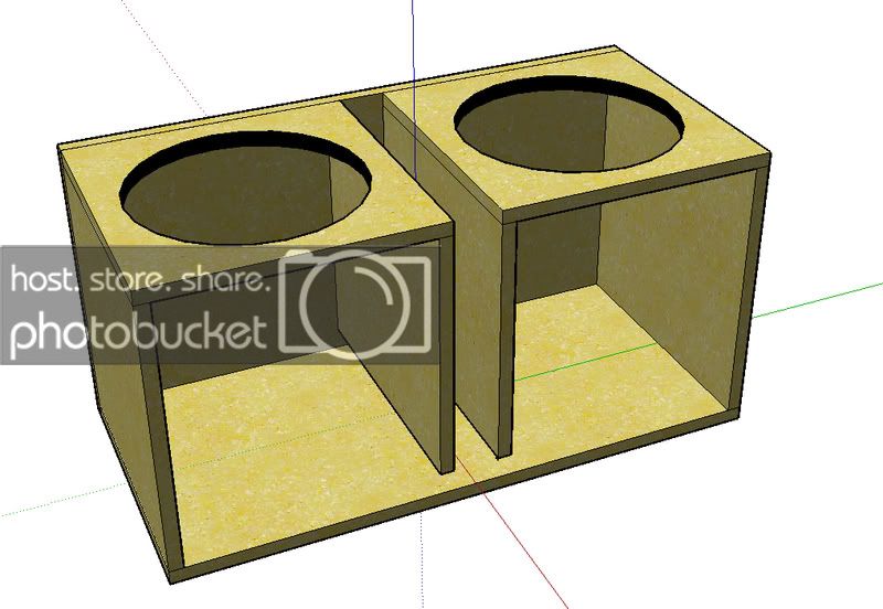

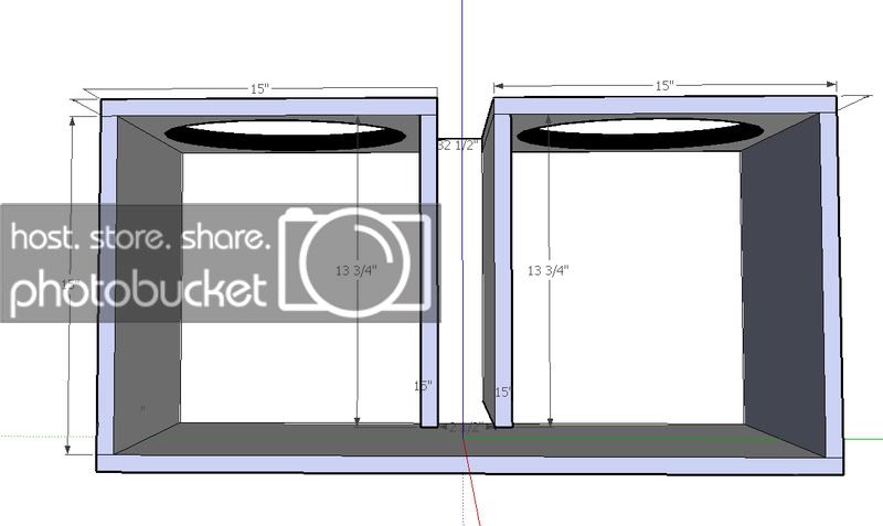

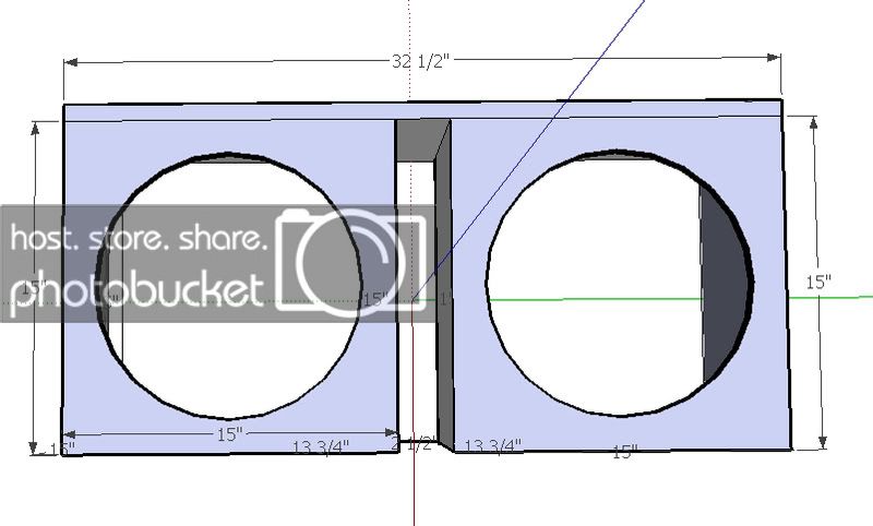

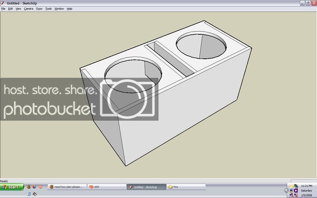

hi to all
i have a pair of mmats p3 12 i would love to build a ported box tuned to 35hz in a hatch box for a Nissan k10 micra space i have available
width -33
height-15
depth 1-15
depth2-20
i would love 4 the port to be in the middle of the 2 subs sharing the same port
thanks in advance
go easy on me, i just dl this program today and this is like my 3rd box
so this is pretty much just to let you see it what it looks like, since i dont know how to figure the port size but here ya go
Here she blows, hope you like it:
Enjoi.
I would be careful about having the port panels extend that far back, regardless of the rules about single chamber separated driver enclosures. You're looking at a lot of cancellation right there.
I'll never say I know a lot, I'm just going by the basic rules. I'm not sure if it'll work or not. That's just the basics I know. So, listen to him over me. He sounds like he knows what he's talking about.
EDIT::
How do you fix that? //content.invisioncic.com/y282845/emoticons/biggrin.gif.d71a5d36fcbab170f2364c9f2e3946cb.gif
lmao, I know what it is. But I'm not sure what it means.
It means the top depth of that box shoulda been 15" and the bottom shoulda been 20". //content.invisioncic.com/y282845/emoticons/smile.gif.1ebc41e1811405b213edfc4622c41e27.gif
