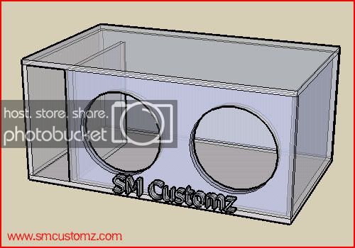

I have a 97 s10 ext. cab with 2 12" l7's dual 4 ohm. I am in need of help trying to build a box. I would like the subs facing up and the same with the port. Tuned to the mid to lower 30's. Any help would be nice. the biggest i can go is 24" tall 41" long and 16" -18" wide
Forgot to rotate the box so the subs and port are up, but you can imagine.
6.5ft^3 @ 33Hz
Double baffled.
39Wx24Hx18D
I would be more than happy to build this box for you. Just shoot me a PM.
Forgot to rotate the box so the subs and port are up, but you can imagine.6.5ft^3 @ 33Hz
Double baffled.
39Wx24Hx18D
great box but are your going for the square peg round hole theory ftl?
its for l7s lol
Im new to box building. Why would i want the port on one side and not in the middle? I know in sealed they normally separate both subs why not in a ported and have two ports? What is double baffled?
