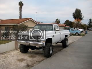

here is some more photo's for those of you who care to see them. The first picture demonstrates the shitty quality of paint on this year of truck. look at the hood, looks like a dairy cow.

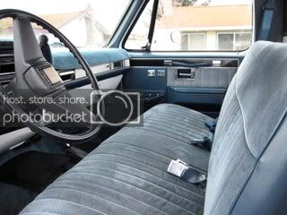

here is one of the interior
