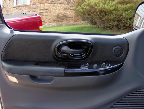

For F150 guys, I am also looking for a place to mount the tweeters and crossovers. The driver and passenger door panels are very different, so I am really not sure where to put the tweeters. The crossovers are large so I'm not sure where to mount them either. I was thinking about putting the crossovers inside the door, but there's no way to mount them that I can see. I bought thee generic 6x8 to 6.5" adapters, but they don't with with the polk speakers so I need to figure out how to mount them as well. Running speaker wires into the driver door thru the grommet was VERY hard. The inside of the truck on that side is very hard to get to. I only ran 1 set of wires so I hope I won't need another set of wires from door to inside on the driver side.

I've seen people mount tweeters near the door handle like this:
I'm trying to figure out where to mount the tweeter and crossover. The door looks nice, but I don't see a good place for the crossover. We only ran 1 set of cables into the door, so I am hoping to not have to run another. The driver side was terrible to do.
