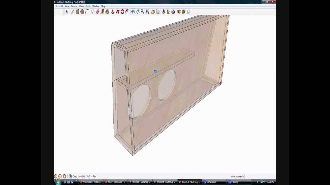

Nah skip the prefab box. You could fit 2 8s ported back there that will be wayyyyy better than that box you just listed. This type of design comes to mind:
And I suggest doing it yourself. And yes, your truck should have rear speakers.
Thanks. That box looks good, but I'm not sure I have the tools and time to make that for Christmas. I took rough measurements last year and made an image. It does not account for the armrest that does dip back some, but its roughly correct.
As I recall, ported boxes are louder, but for small space I figured a small sealed would be best. I could even go to 1 woofer, but thought 2 x 8" would be best combination.
I just need to get a parts list and order it if I have any chance for Christmas.

If you go 40" wide that gives you 1.5 cubes before woofer and port displacement. How wide can you go? With that amount of space I'd do 1 8" or 10" woofer. Hit up @CSCStang for box suggestions. He's the man when it comes to boxes.
