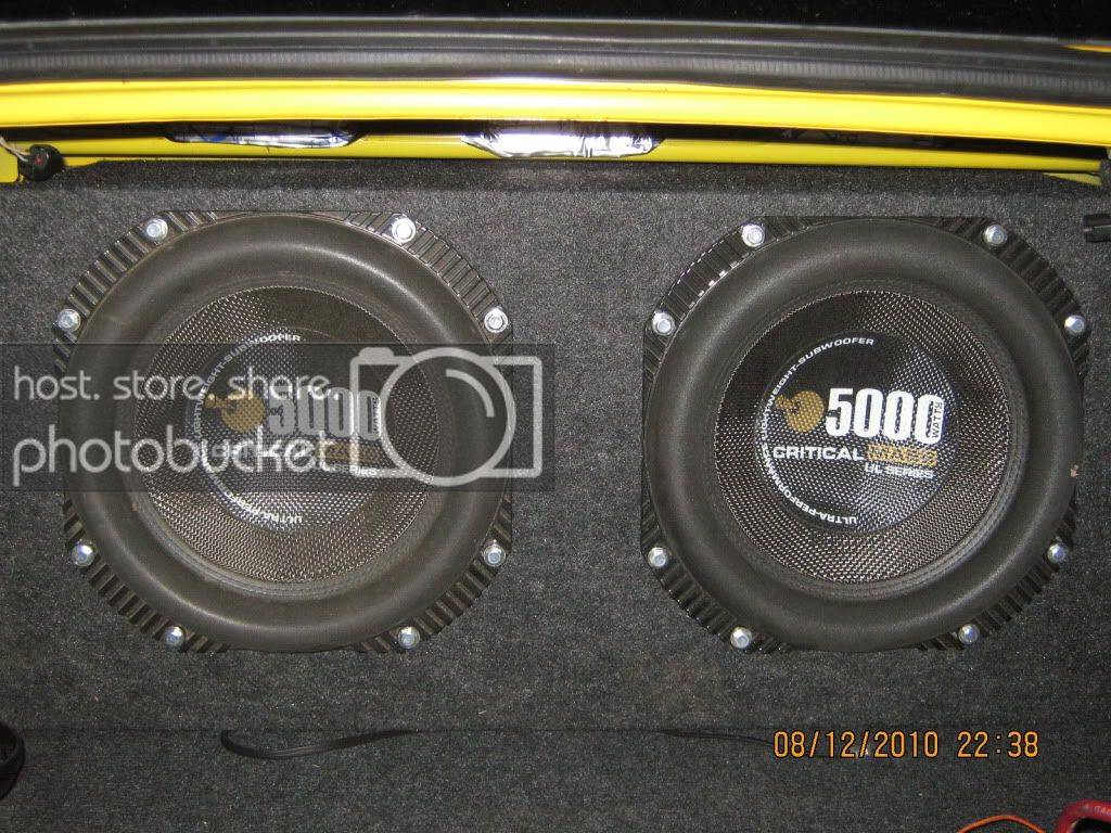

Two 12s in a sealed box can sound pretty sweet I was running these two 12s in My 06 Saleen and that thing would hit low...I had some notes on a demo cd that would have the car vibrating and you couldn't even hear the music...I loved demoing that CD...I ran a DD M3 on the pair at .375 daily ...
