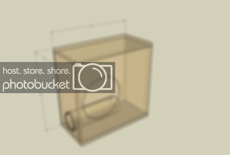

need a box design and cutsheet
it's all about port lenght.. something in that amount of space will have to be long and thin to work,
BTW, slot port, round port, it's all the same if done correctly.
heres an idea about a round port.
that would actually work perfectly..and its even smaller than the box i have now..port..6in pvc? how long?
ill throw ya $10..specs?
What is the mounting depth of the sub? Not that hard to get a slot port on the front of the box if you have. a sub less than 7.5" deep
Could do 25"w x 11"d x ~18"h
Oh, so with the sub and port firing up? Sorry, I thought you wanted them on the front wall lol
Yeah, it would still work just fine, just change the port length a bit.
