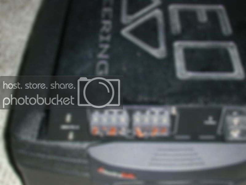

Well, for all the guys who like pictures, I have some shots. I didn't do a whole step by step because most of the interior work was done outside my workplace (Checker Auto Parts) during down-time so you won't get to see step by step install of the deck, wires, or speakers. I will tell you though, that I rewired the rear and ran the fronts from the deck harness to the amps. 0 awg wire came through the unused grommet above the gas pedal (was a ***** to find too), and ran to the back. Factory sub was removed to allow bass into the cabin. I also made some pods out of the triangular panel by the front windows, and MDF spacers for the front mids painted with polyurethane to prevent cracking. Both amps were painted silver to match the car. All I need to do now is make an amp rack cover and tighten up some small stuff. Sub and box is a bit dusty still. My system consists of:
Deck: Kenwood KDC X790
Front speakers: Phoenix Gold RSD 6.5 comps
Rear Speakers: Cadence ZXN52
Mids/Highs amp: Rockford Fosgate Power 750x
Sub amp: Rockford Fosgate Punch 800.2
Sub: Rockford Fosgate Power T115
Box: Homemade 3.5 cubes tuned to 38hz painted with textured Graphite paint
Enough talking and on with the pictures:

Nismos - They aren't right on axis but it's the best as far as mounting goes for now. I didn't want to cut hole in my doors and they wouldn't fit right on that **** panel any other way unless I extended them out like 2-3 inches but that'll look pretty stupid. Trust me, I tried. these are actually the second set of pods I made for this car. The first ones cracked after I closed the doors:(.
