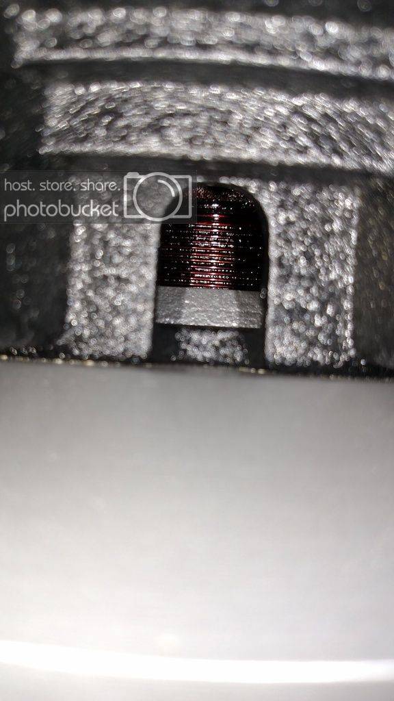

Man its hard to squeeze a picture of the coil through those small basket holes. Here you can see the blackened coil as well as a little shiny copper, maybe its just the adhesive but it has enough black to make me concerned.

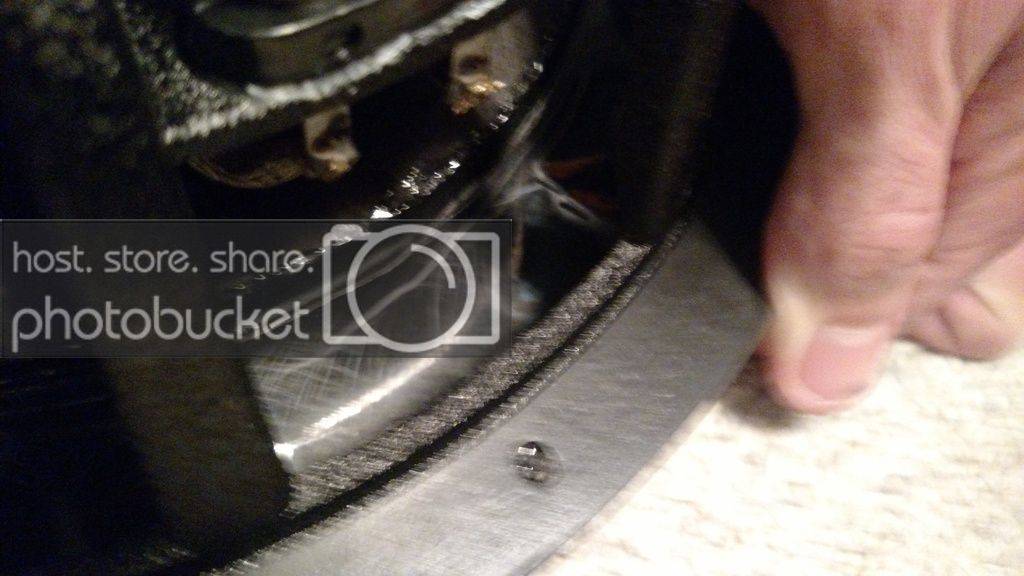

I'm gonna refer to those white lines on the bottom of the surround as stress cracks. Majority of them actually are not fully cracked but in another picture I will show one that is really bad.

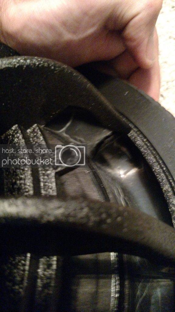

Here is the one that I refer to as the soft spot that you can noticeably feel from the front. When the subwoofer would play you could actually see it sort of kinking here. Its done this from its very beginning days if not day one //content.invisioncic.com/y282845/emoticons/frown.gif.a3531fa0534503350665a1e957861287.gif

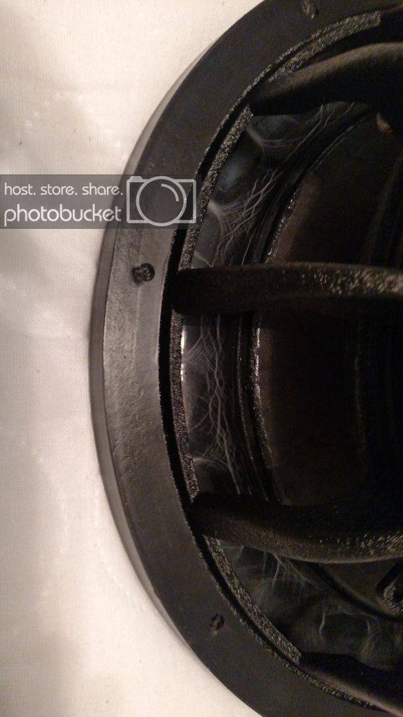

Another smaller crack, its odd to me that they don't go all the way through the surround. Its almost as if the surround is two layers and kind of shiny looking like clear glue which gave me the whole smeared glue idea.

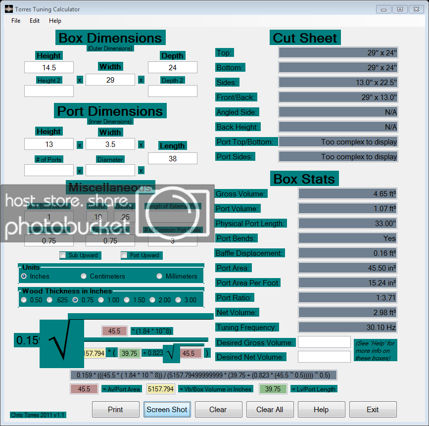

Here are specs from the first home the zcon had, I believe this was the guys second box he built with the first being his own but he sought some help over on ssa forums and diyma if I recall correctly. Probably not the best specs but I was having a hard time finding someone to help me with a box at the time. He was local, proved great craftsmanship, and was really nice.
Hopefully these pictures will help yall address my concerns a little better.
