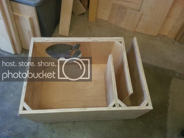

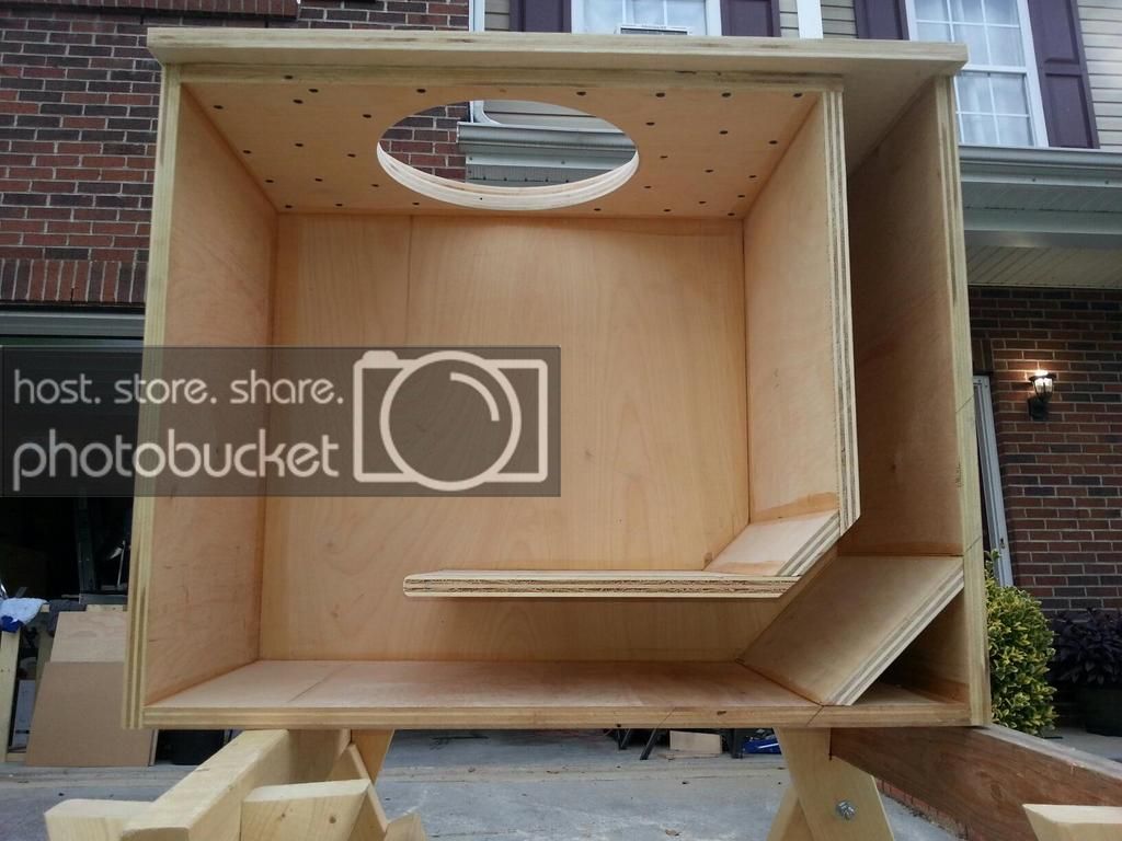

The first enclosure, 3 cubes @ 30hz was sub and port firing into cabin. Then when I got the 2.5 cube box @ 32hz I decided to do sub and port firing towards the rear probably about 5 inches or so from the trunk. I read that trunks do well this way so I figured that was the best orientation. I feel like the zcon was begging for more power but I wasn't comfortable pushing the amp any harder in fear of clipping. I remember when I got the 2.5 cubed box here fairly recently it was like holy crap I should of did it a long time ago. I had to back the gain down a little on the amp and turn the subwoofer level on the 80prs down actually into the negative cause it was that much louder.

Yeah she will play the low but no output what so ever, I wanted to go to 3.25 @ like 33hz but ccstang felt the 2.5 @ 32 was right for me but guess its hard to build a box for someone and not knowing what there looking for. The 3 cubed box did dig a lil lower but still lacked the output. I know low and loud takes good electrical and lots of power, that's why I was thinking of getting a bigger amp. But while things were out of the car and I wanted to inspect everything and discovered that uggly surrround and revealed the truth of why there was always a soft spot in it. This zcon never seemed to move much in either enclosure, ive zeen the zcon straight bouncing in some youtube vids.

I also hate how much my current setup weighs, im in a 2013 civic si coupe and like to whip around and you feel that **** back there. I dont have much more room than maybe just over 3 cubes unless i build in trunk and dont want to do that, that 3 cubed box was a tight fit.

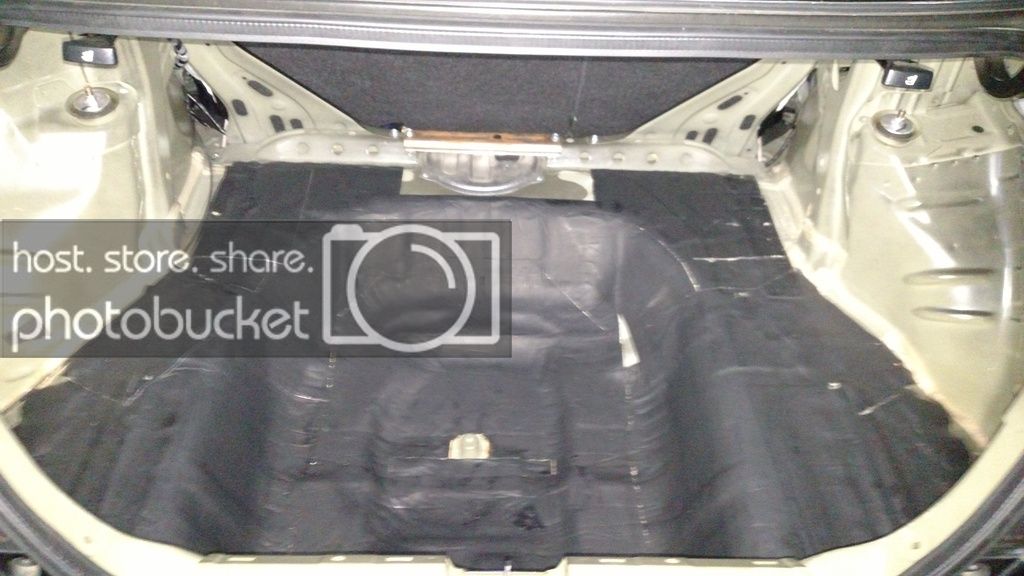

Here is my empty trunk, got a good amount of deadner down on the floor but still got a little work to do to make it a good install. Honestly, I would love to try something different cause this zcon just hasn't been doing it and obviously its in need of some tlc. I been without bass for about a month and im bout to go crazy.
A zcon and 3 cube box doesn't weigh much. The weight of your whole system is probably equivalent to having an extra person in the car at all times. When it's just you driving, it would be like the car is just carrying two people. I doubt your system is over 250 pounds.
