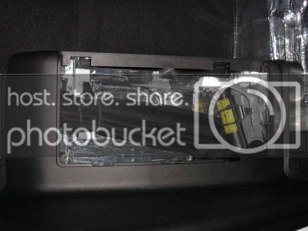

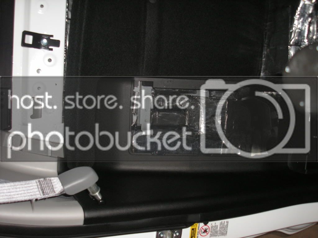

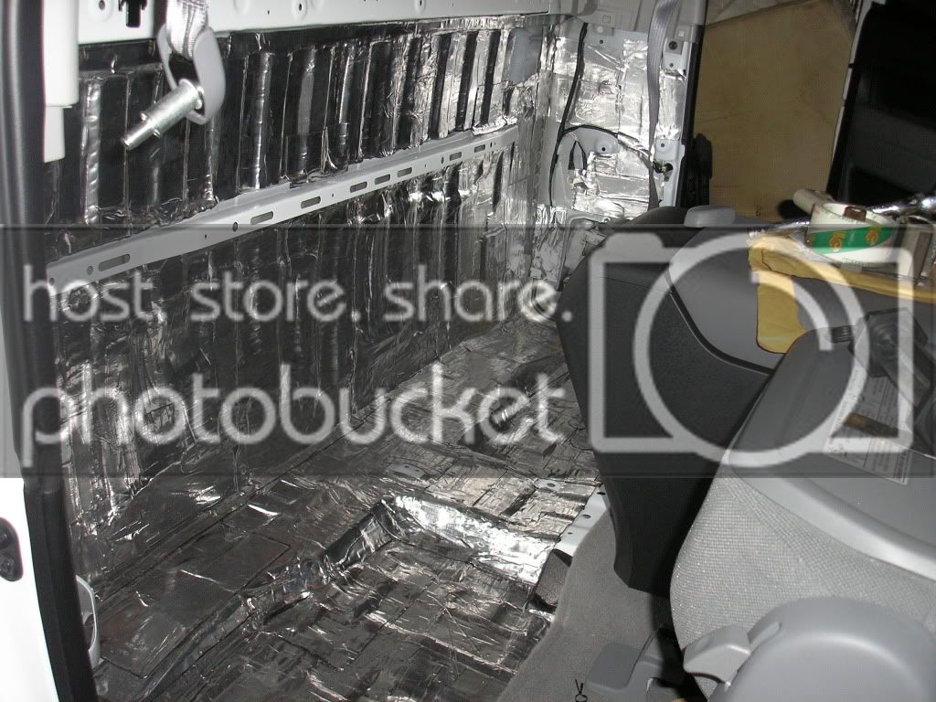

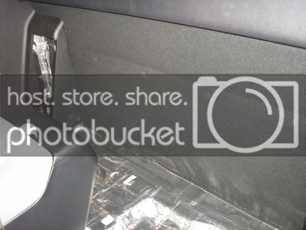

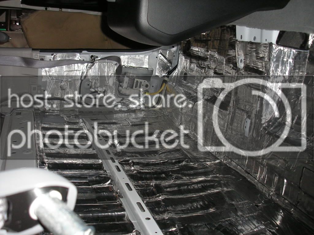

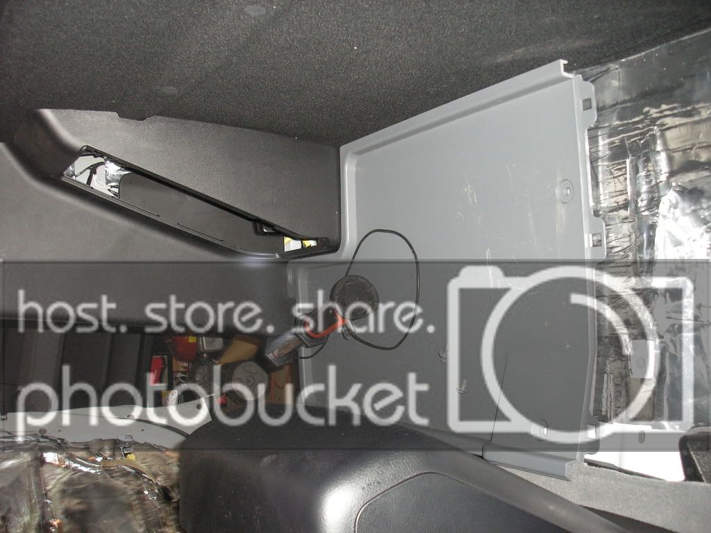

reinstalling the interior...

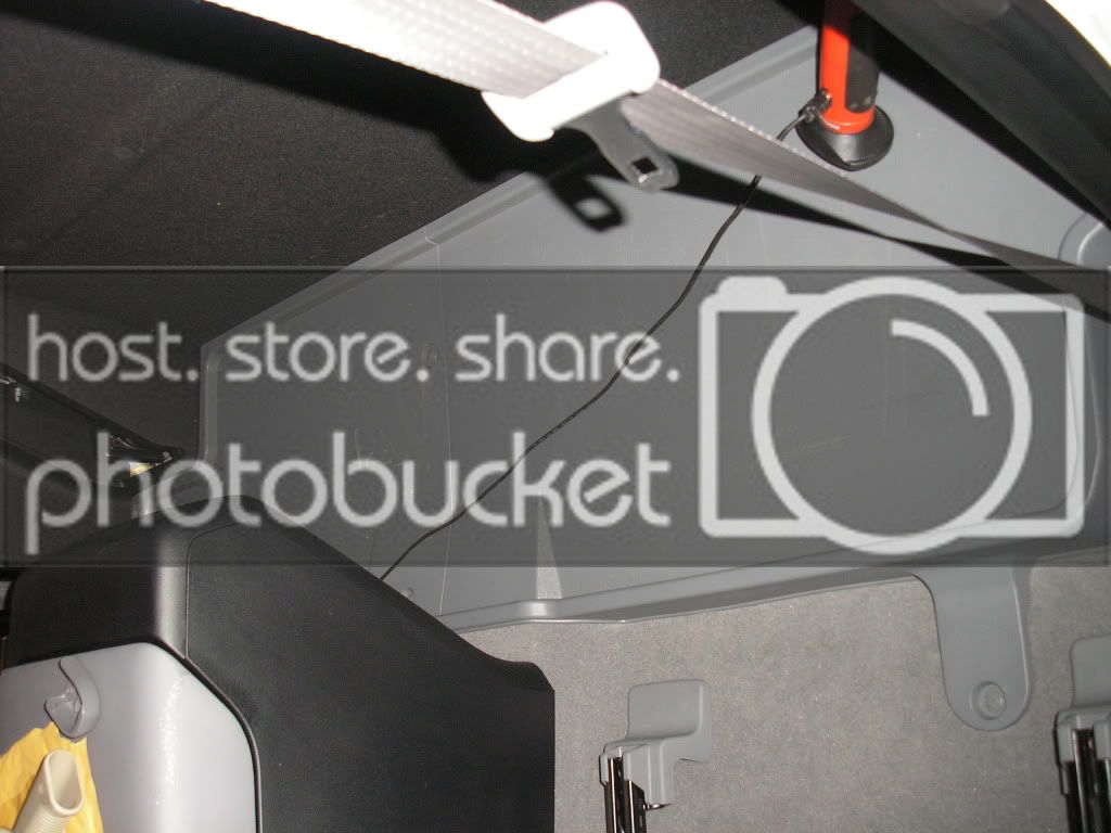

first install the back carpet

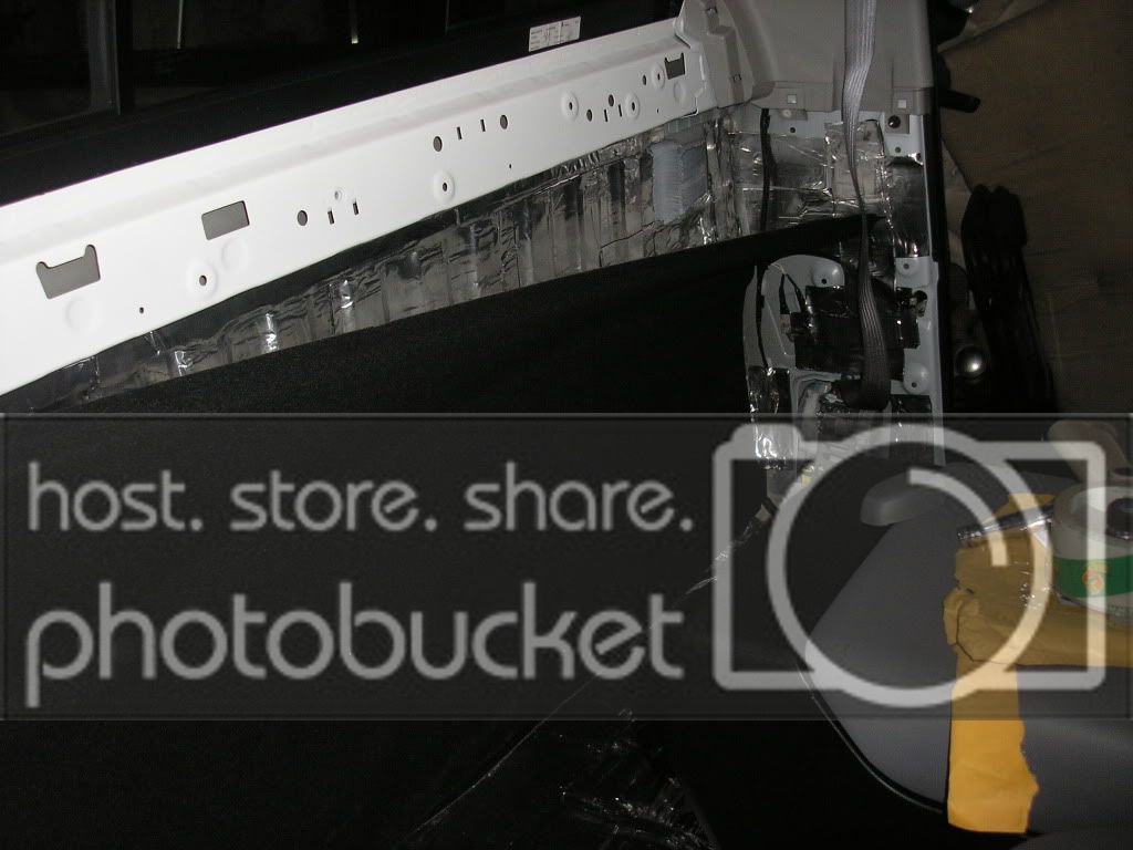

install passenger side back panel

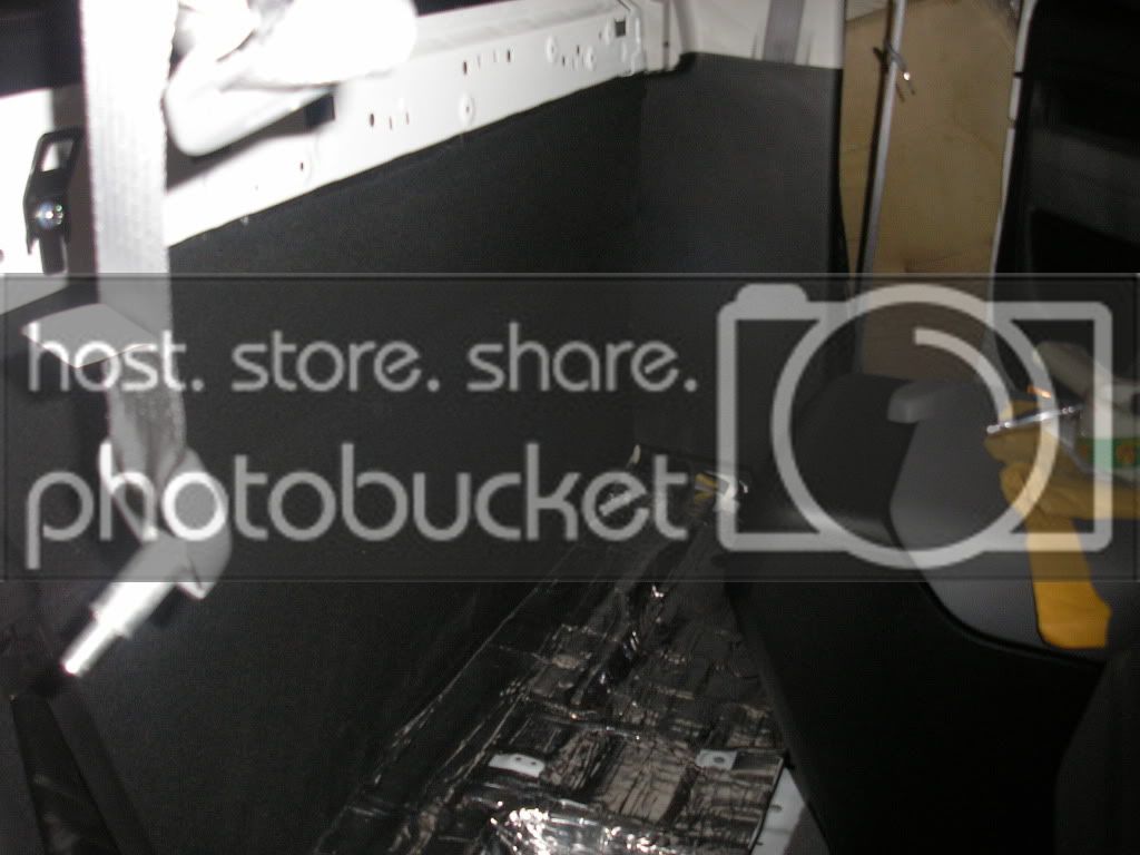

install drivers side back panel
(install seatbelts) not pictured
reinstall top piece (very top of picture)
reinstall jack and tools
reinstall passenger side of floor, only connect the 2 snaps on the outside not in the middle. you will install the middle clips after the drivers side piece goes in.
drivers side installed
