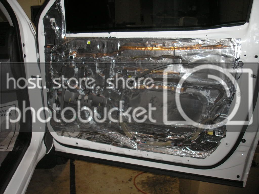

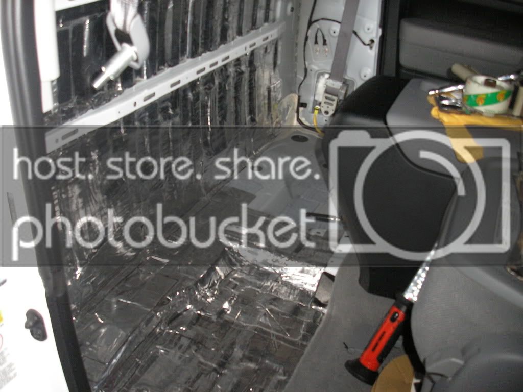

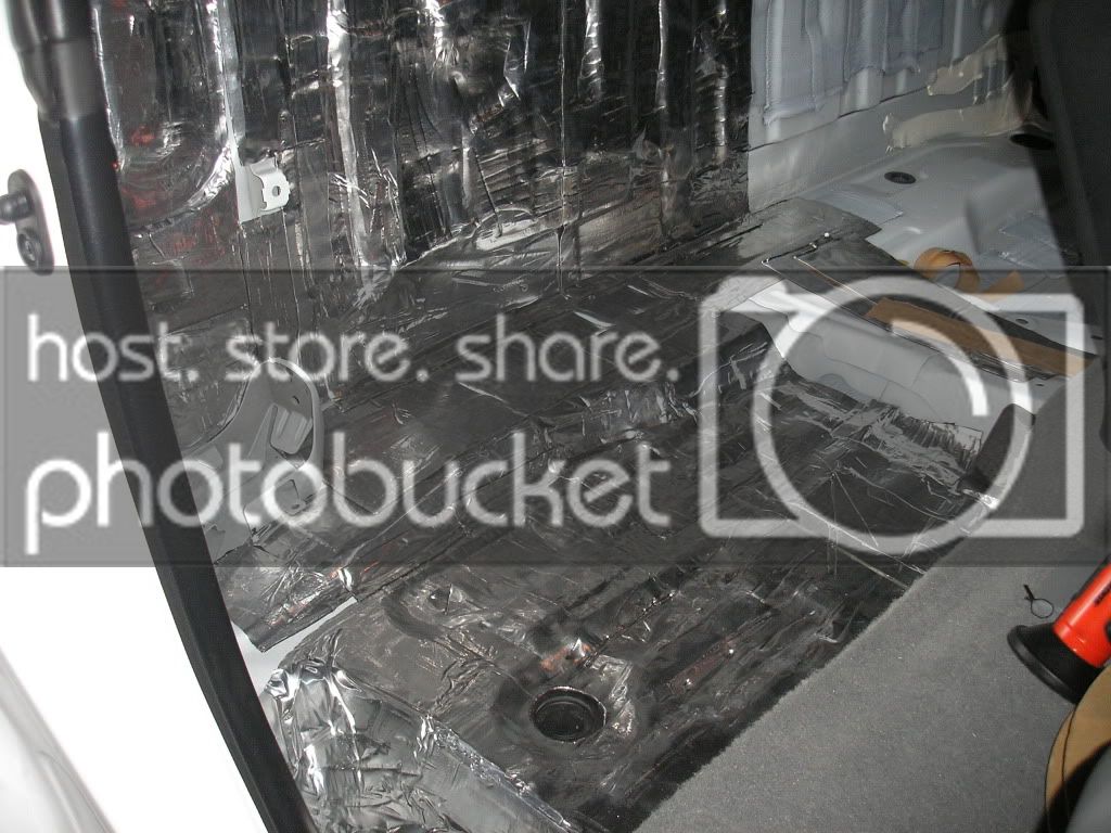

i sealed up the holes in the door. i cut a "frame" with the knife of the back so only the paper backing came off aroung the edges.. i dont want buytl on my windows.

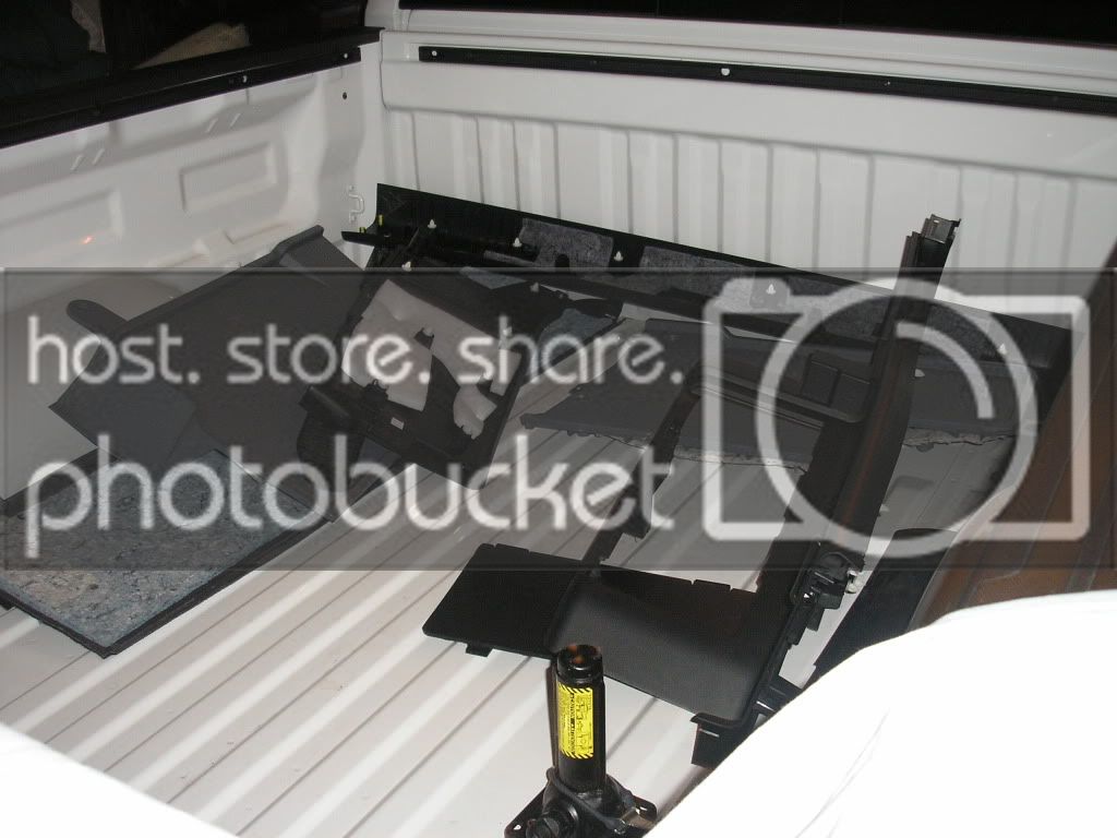

interior of the truck in the bed.

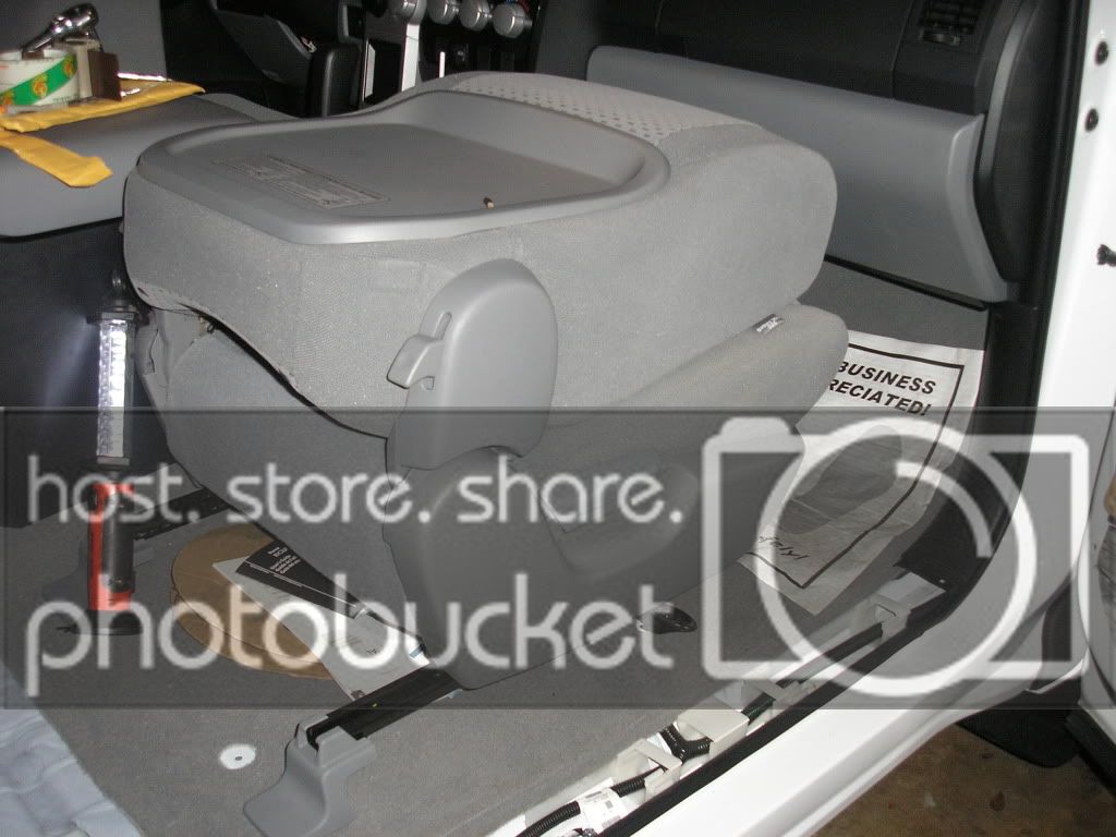

i found out my seat folds flat lol

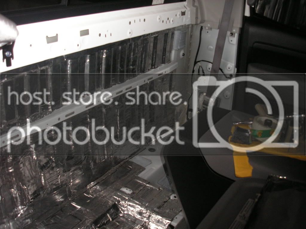

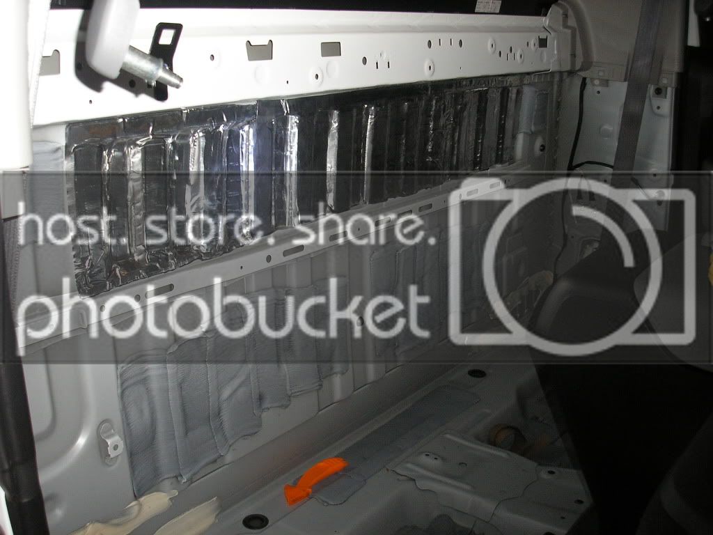

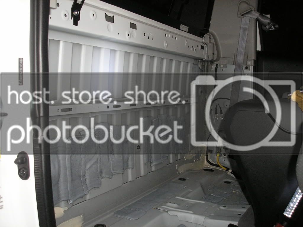

getting started on hte back wall

//content.invisioncic.com/y282845/emoticons/crazy.gif.c13912c32de98515d3142759a824dae7.gif im not done
