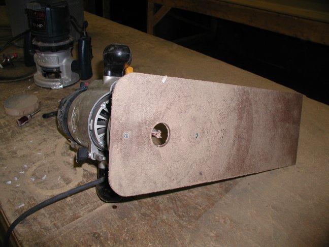

Home made circle jig.
Scrap masonite and 10 minutes of my time.
Took the router base off and used the original screws to attach the jig.
You dont have to use masonite, any thin board should work.
