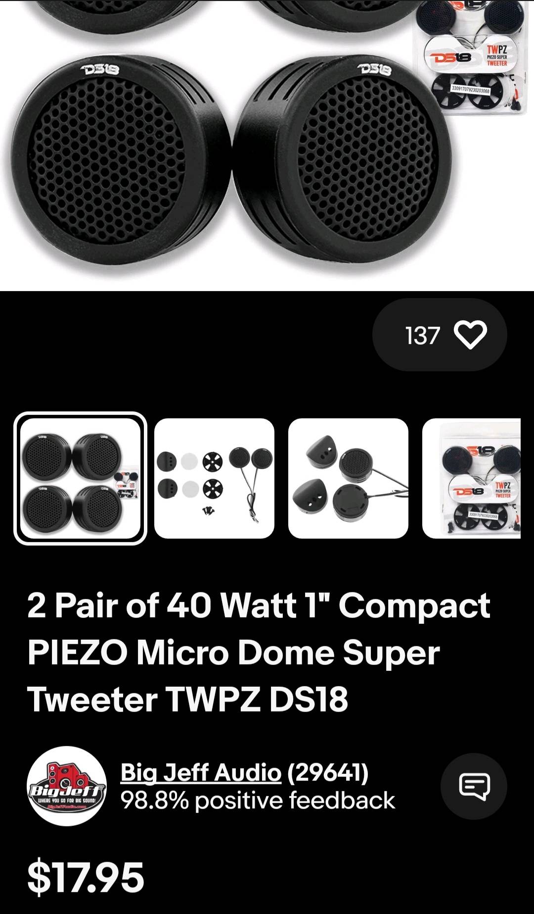

There is an option F that some may not like. I have "upgraded" a few peoples audio with the addition of just a brighter tweeter. I noticed most OEM radios have a balanced midrange but subdued highs. Just that addition of piezo tweeters makes an noticable improvement. The tweeters I use only cost about $25 so not a big loss if it is not what you are looking for.
