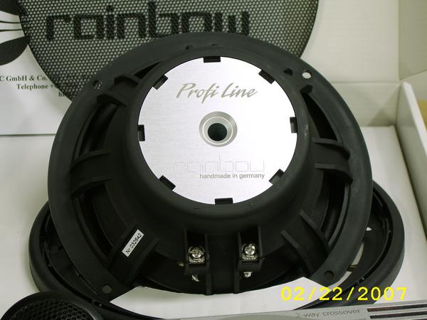

This is just the teaser......

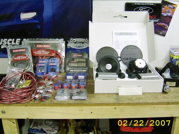

Here's my plan for the install on my '05 F-150 (it's going to take a while //content.invisioncic.com/y282845/emoticons/frown.gif.a3531fa0534503350665a1e957861287.gif );
1) I'm going to lay down 120sq ft. of RAAMmat on the floor, rear doors, back wall and if I not to lazy the roof. While doing this I'm going to re-wire the truck for the Big 3 in 1/0 ga. Run new 1/0ga. power and ground wire for the amps. Run the RCA's, speaker wire, remote wire, and radio power/ground wire down the center on the truck. Then install my LMI seat lift kit.
2) Then I'm going to concentrate on the front door. For them I have 80sq ft. of Second Skin. and the
NEW RAINBOWS 265 Profi Kicks! :banana: Haven't decide the full plan on that but it will require a full weekend for me to install. Too much of a perfectionist!
3) Building my new box with two JL 10w6v2's for a little bump.
I'll be runing my PPI a404.2 to the Rainbows bridged @ 200w. The JL 10w6v2's will have a PPI a600.2 bridged @ 600w.
