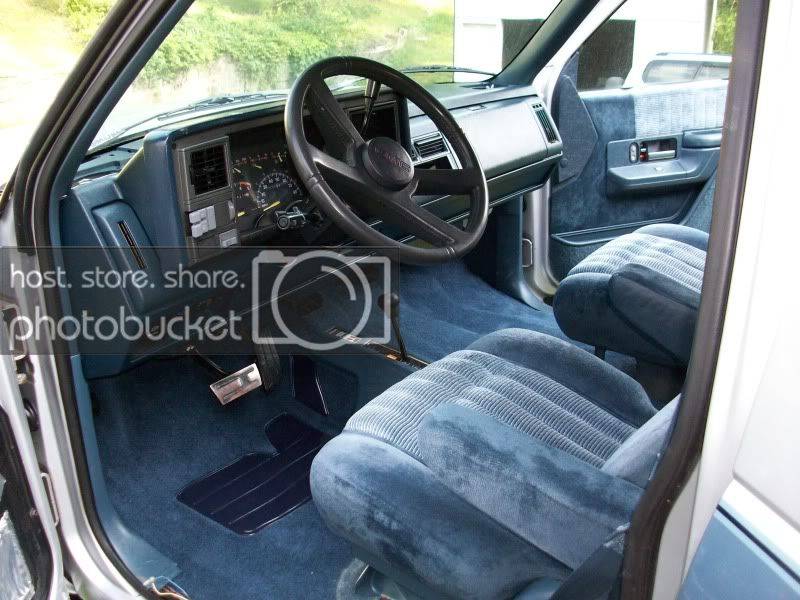

Carpet came from Stockinteriors.com also a great company to deal with.

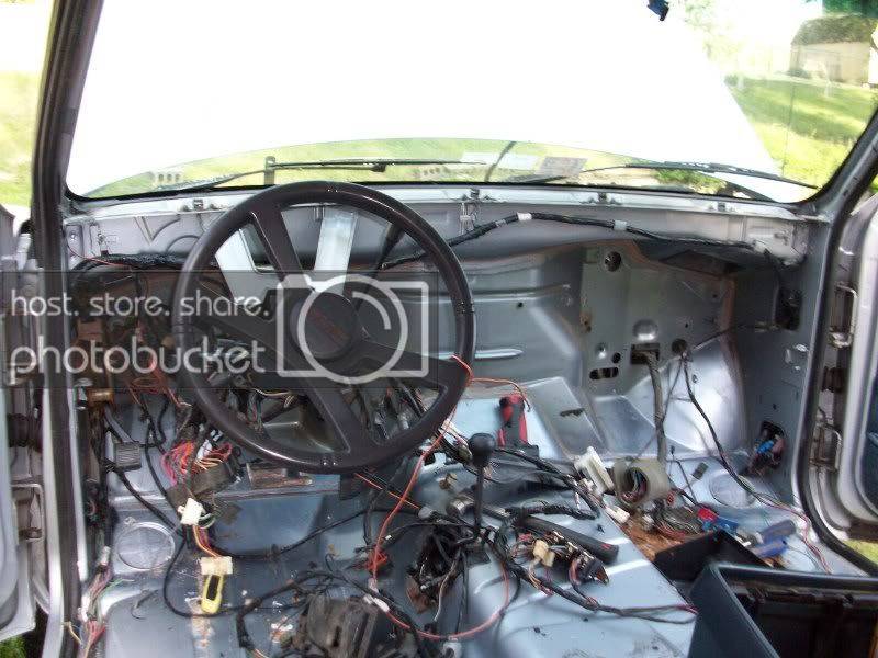

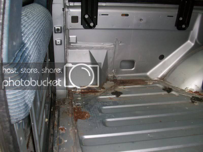

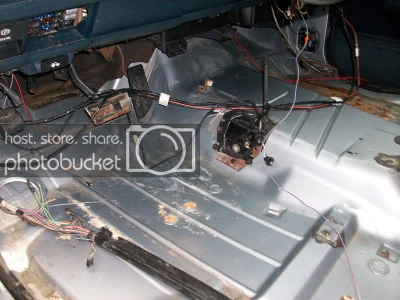

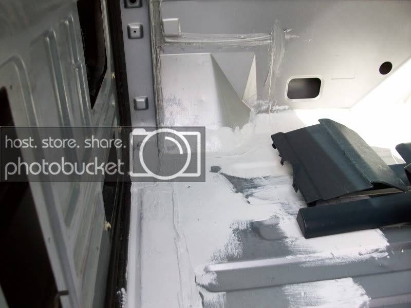

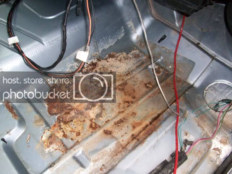

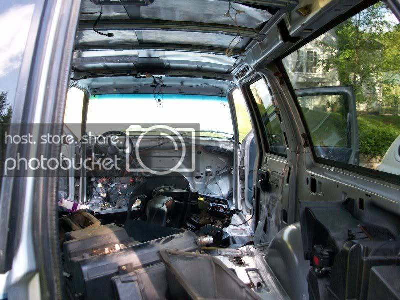

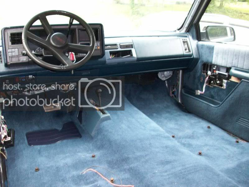

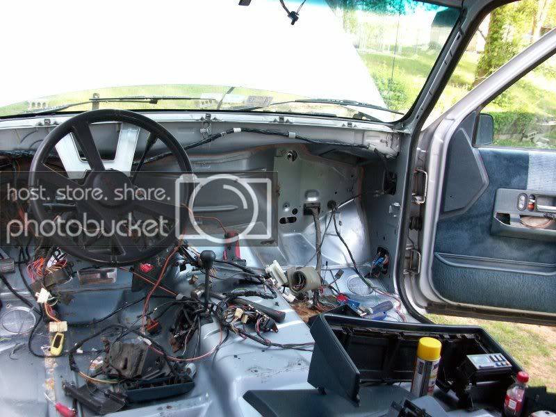

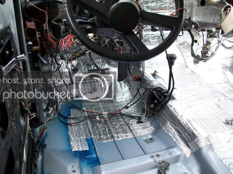

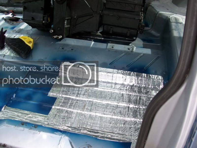

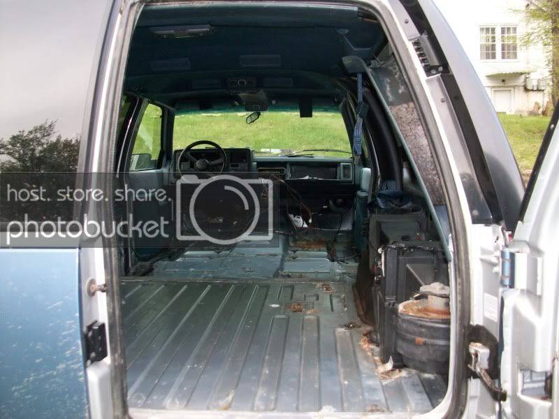

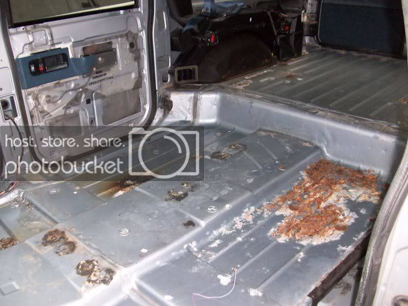

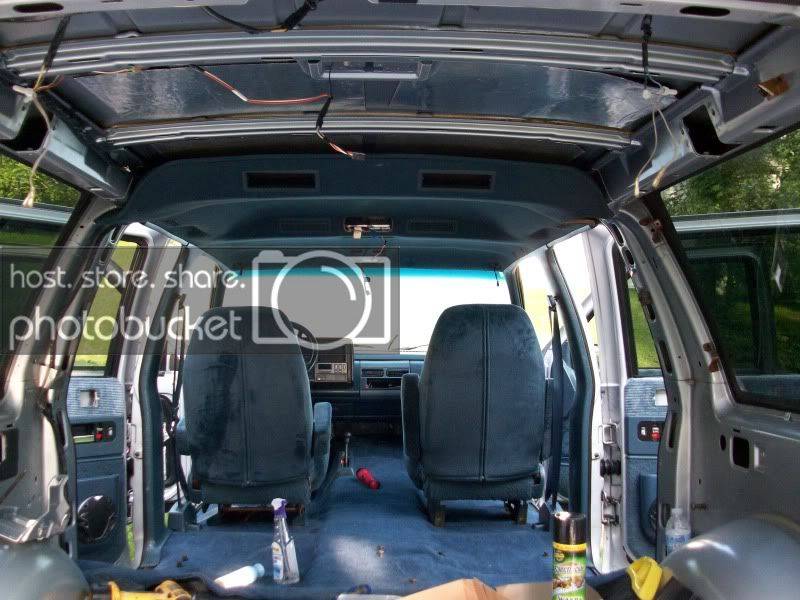

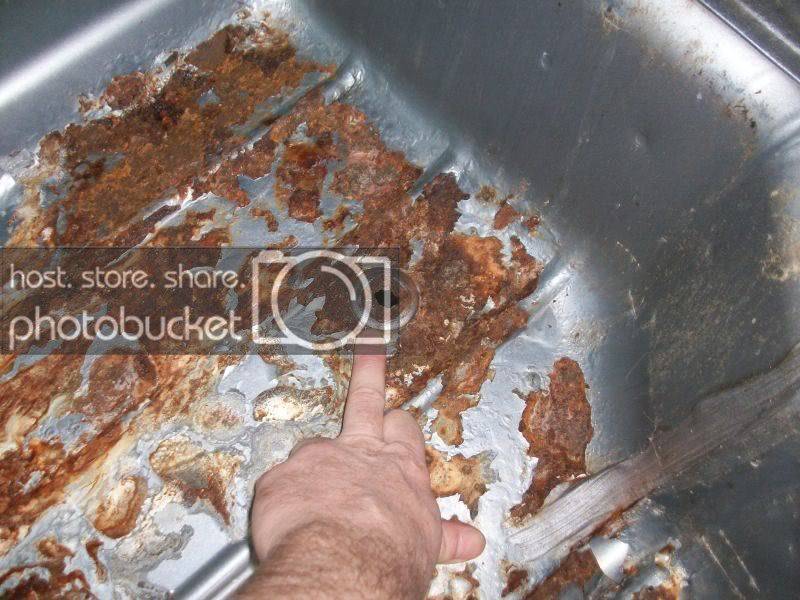

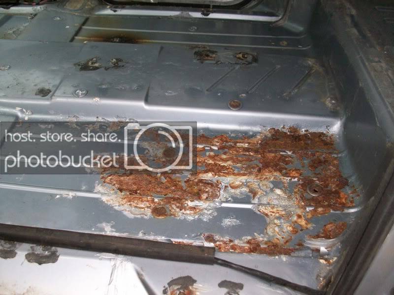

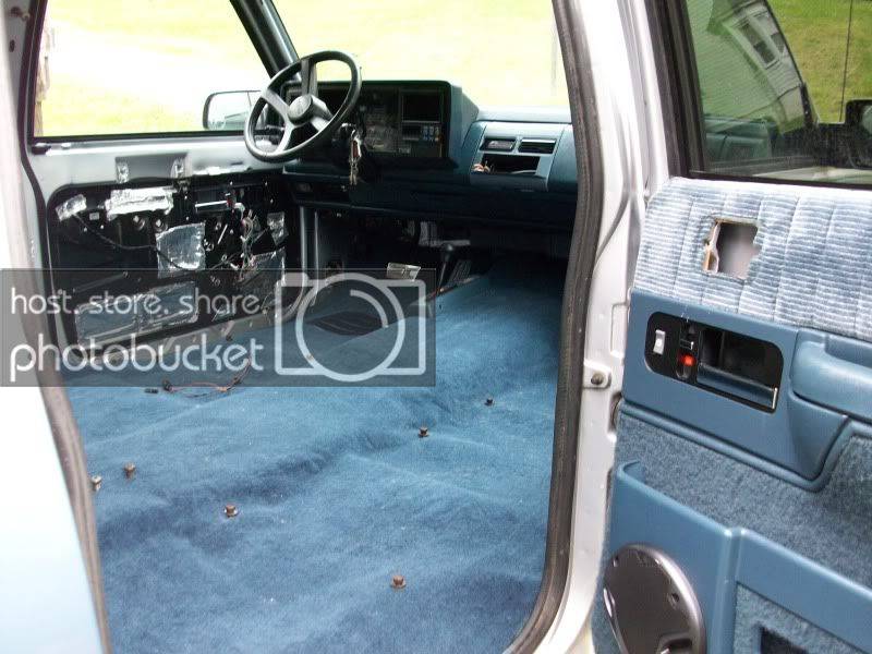

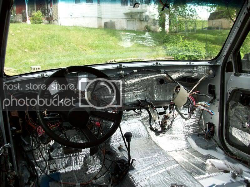

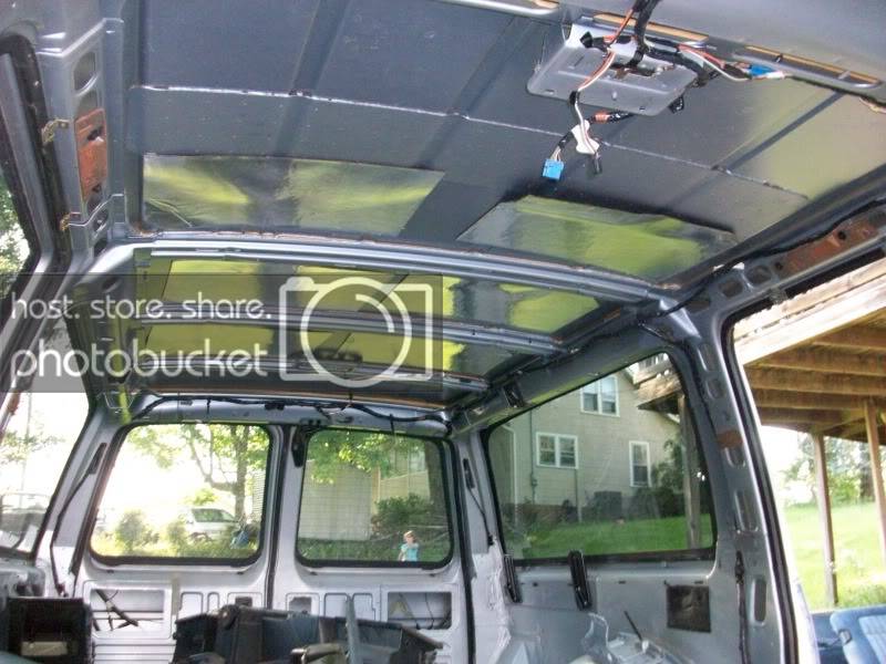

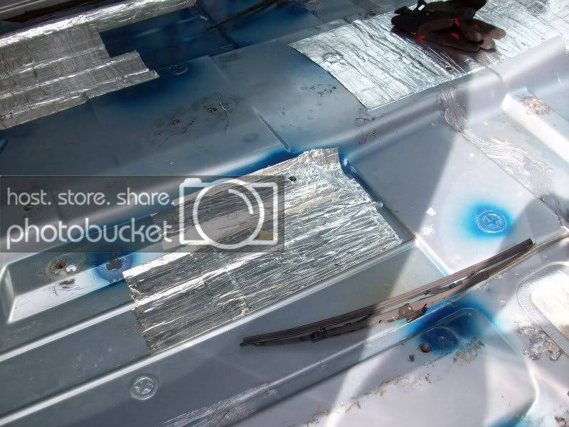

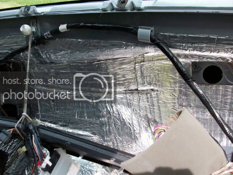

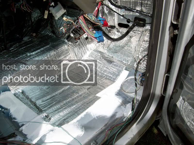

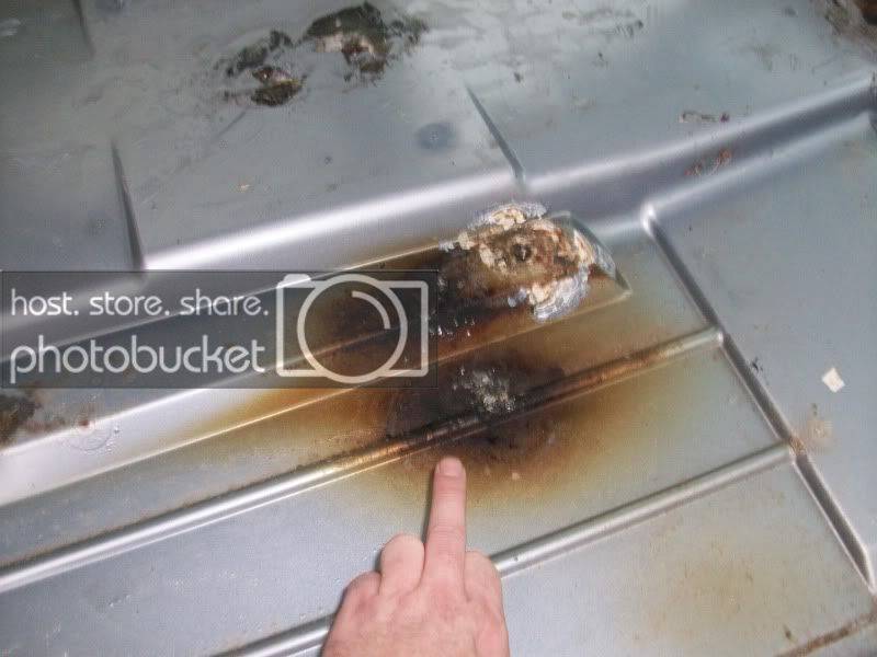

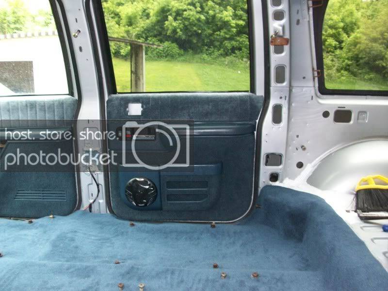

1994 GMC K1500 suburban. I picked this truck up cheap and it needed carpet and all the factory deadener was dissolving from being wet. The previous owners were "just hosing it out" and nearly ruined it. I forgot to take pictures before I took it apart but they start soon as it was empty.

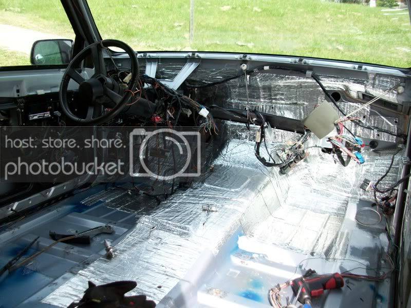

Which one did you use? 60 or 80mil?
Also how much deadener did all that take?
Awesome build man! You did some good work there!
Thanks man, it took tons of time.

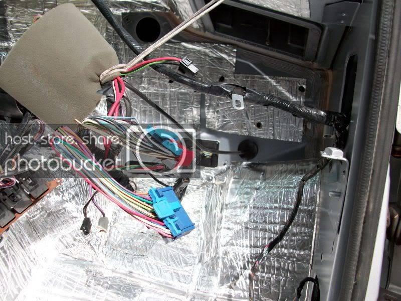

The deadener is the 60mil as I prefer to do 2 layers always and sometimes 3 layers.
So far I have used 50sq feet of AT with plans to use another 30 or so sq ft.

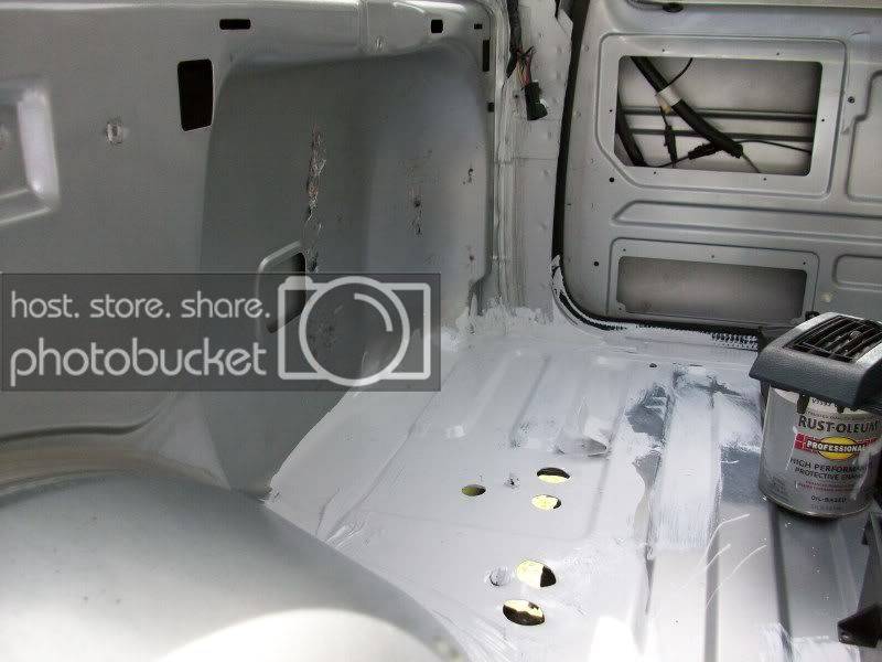

I also used 80sq ft of the thin (40 mil IIRC) FatMat on the cargo area floor because I know it will get damaged back there and I know it will be way easier to remove Bahahaha...
Thanks man, it took tons of time.The deadener is the 60mil as I prefer to do 2 layers always and sometimes 3 layers.
yeah... once that AT is on there it aint going no where. I put about a 1/2 inch going past my door panel and thought "no biggie, will just peal it off" WORNG!//content.invisioncic.com/y282845/emoticons/frown.gif.a3531fa0534503350665a1e957861287.gif LOL
Nice work.. cant wait to see what kinda sounds thats gonna deaden
Looks good. How much deadener are you going to end up using? I am interested in how well it works for road noise.
Soon as I actually take it off my property Ill post back about road noise and how well it insulates. I will have about 200sq ft total in the suburban. I am using it to replace the factory crap mostly. The original stuff was like cardboard asphalt and held moisture . Hence the rust IMO.
