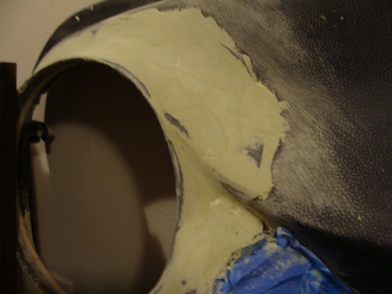

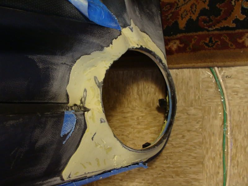

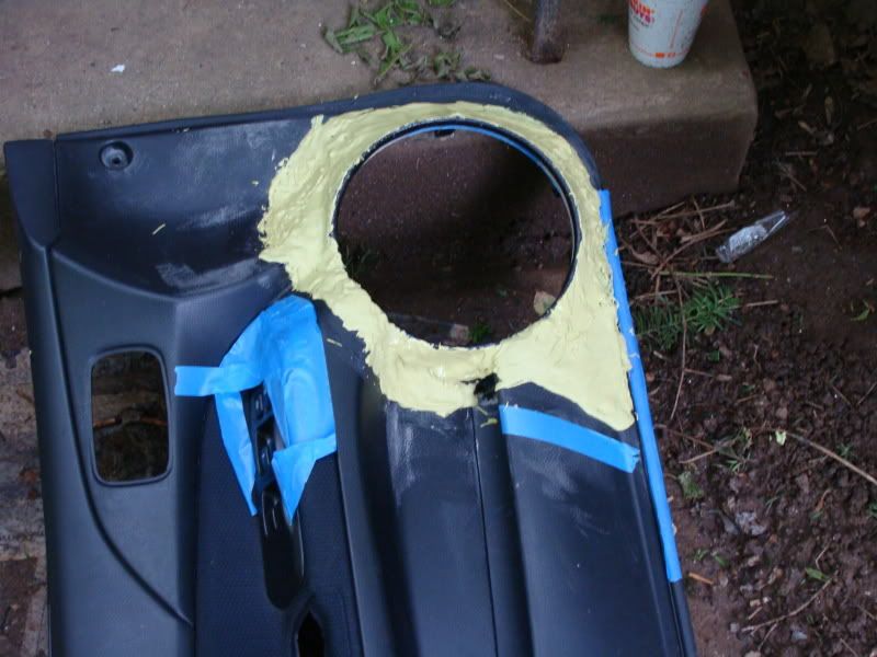

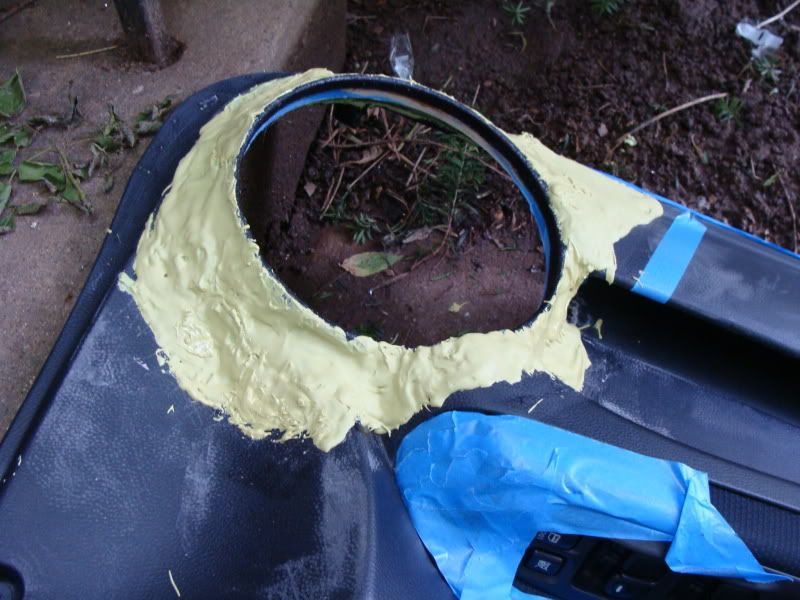

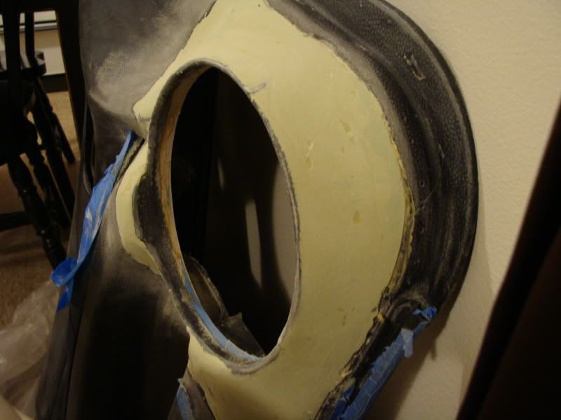

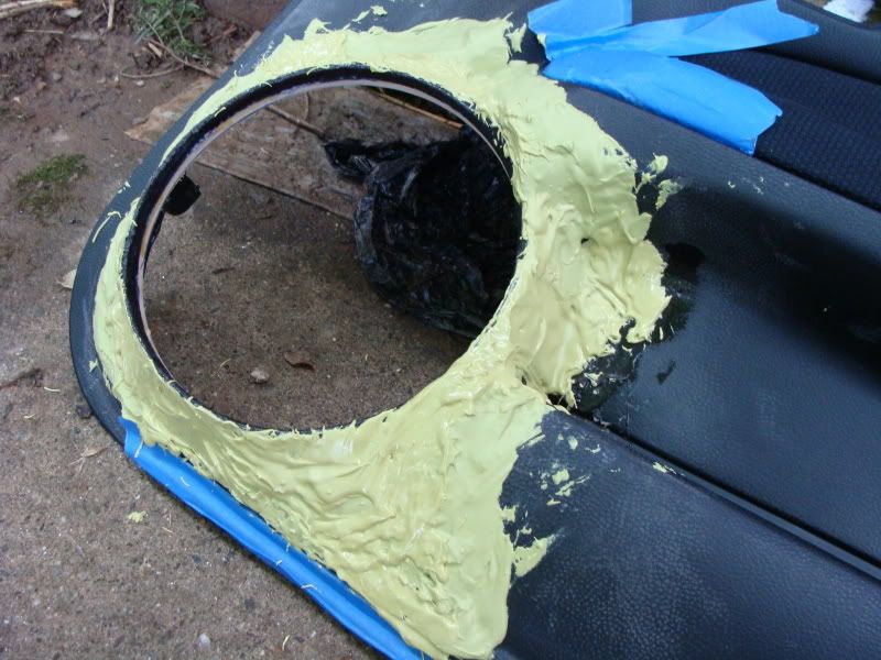

Got a chance to put down a layer of Rage Gold today and do some (alot) of sanding. Not a whole lot to report, but heres pics...
Oh, and this stuff is so far superior to Bondo...MUCH easier to sand.

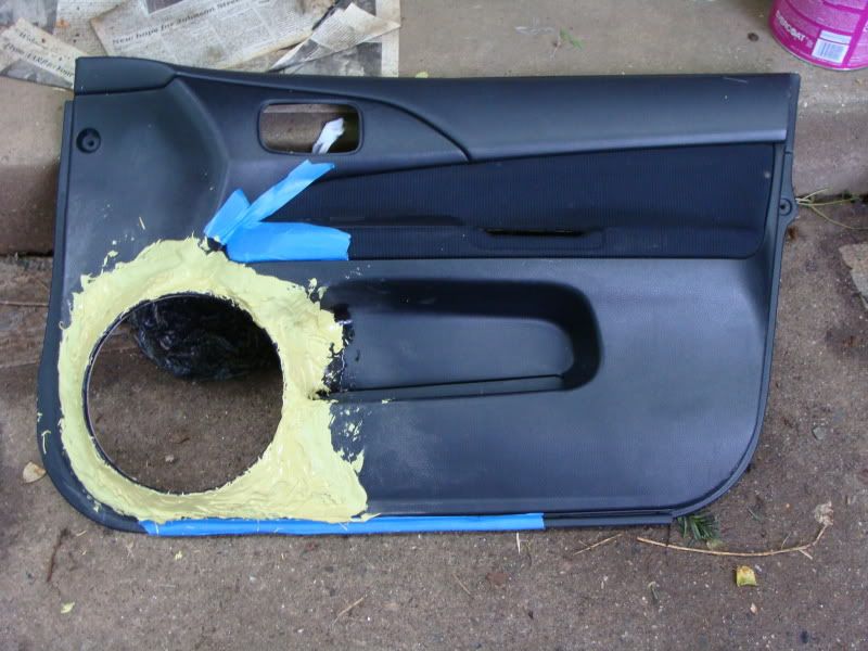

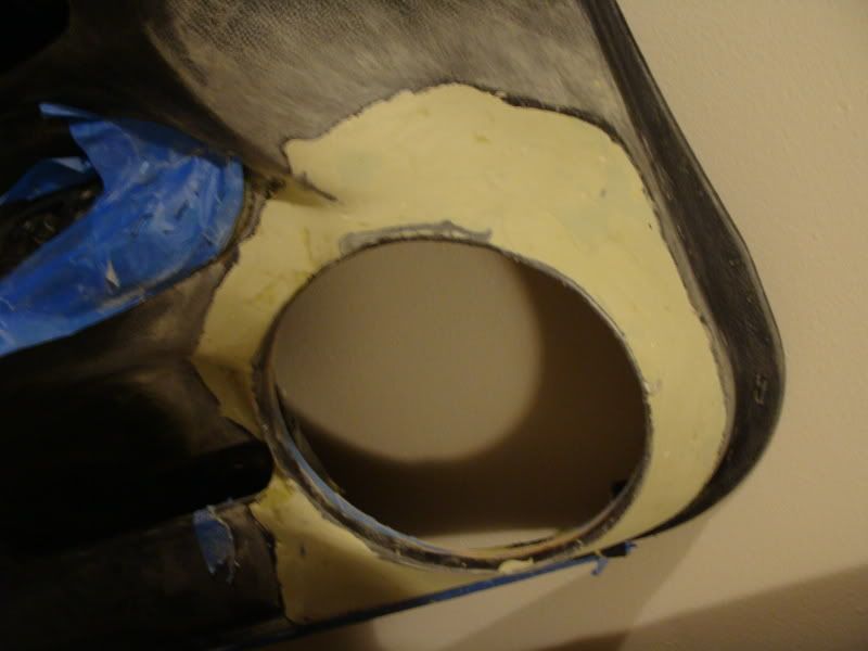

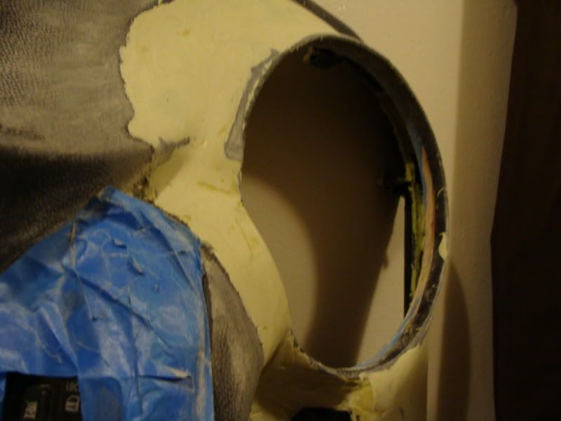

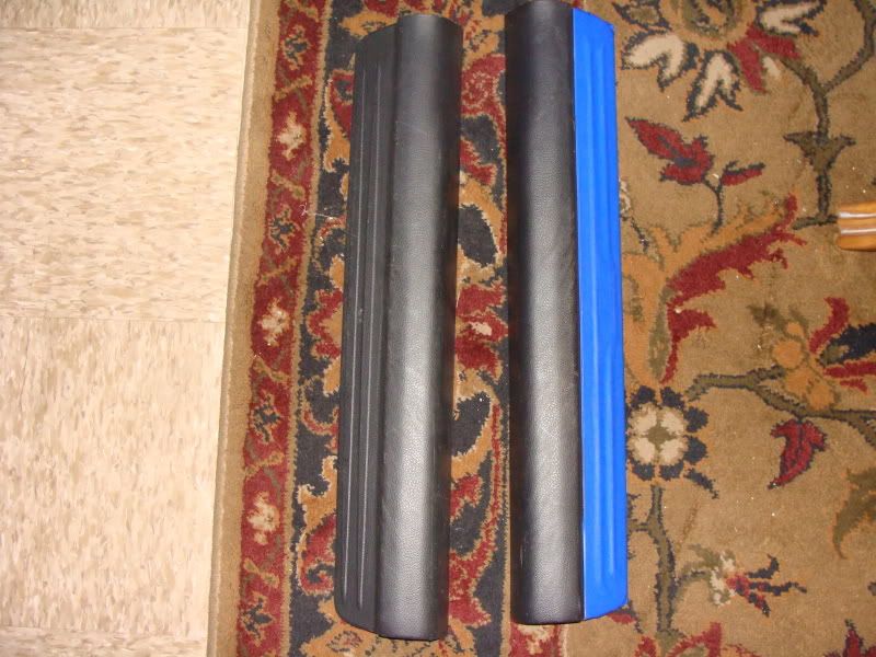

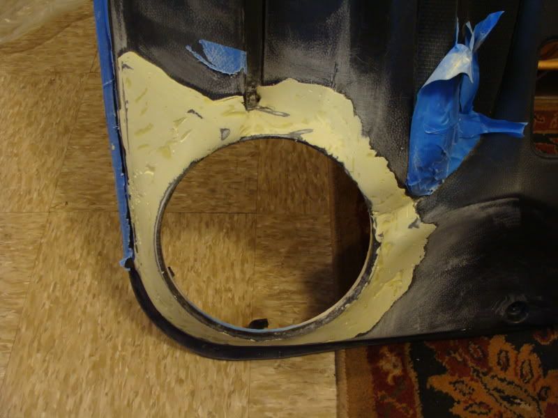

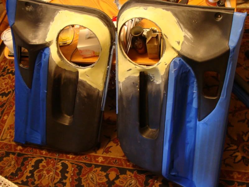

A little more progress done on the doors. I should be ready for a final filler putty and some final sanding soon to prep for finishing. The panels are actually a little better than you see them here, I just havent taken more pics yet. I did some more spot filling and sanding.
Not bad my man, not bad at all. Looks like your headed in the right direction now //content.invisioncic.com/y282845/emoticons/smile.gif.1ebc41e1811405b213edfc4622c41e27.gif
Im no expert so i cant say if it "looks" like it'll sound good (//content.invisioncic.com/y282845/emoticons/rolleyes.gif.c1fef805e9d1464d377451cd5bc18bfb.gif) but either way im not a critical person..if i can hear it im good //content.invisioncic.com/y282845/emoticons/smile.gif.1ebc41e1811405b213edfc4622c41e27.gif lookin great. Dont know if youve done this many times before but doesnt look like your messing up to me. Alot better than i think I wouldve done, atleast you got the balls to cut up your car metal and all for this lol..no way in hell here. More pics!
coming out great. How do you plan on finishing that? the smooth finish of the body filler doesn't flow well w/ the textured door panel :p
Yeah no kidding JB lol. I was thinking SEM texture paint over the majority of the panel. Thinking that should be the easiest and most doable solution for me. I havent done vinyl and since this door panel has some tricky curves, it might not be the best idea to give it a go this time around.

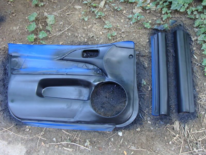

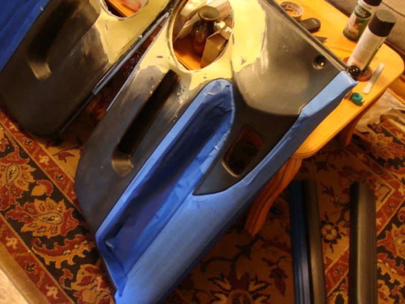

Decided to try and get some more done on the doors today before leaving for the July 4 shindig.

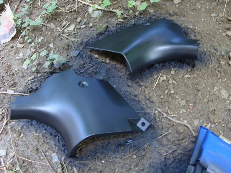

I did some sanding and cleaned up the doors, then masked them off. The top portion of the doors is vinyl while the majority of the door is just textured plastic/poly. Also the armrest is a cloth material so that was masked off as well. I applied 2 coats of Rustoleum specialty "Textured Plastic" as a base coat. After applying its easier to see imperfections and areas that may need a little touch up. While it may say "textured", it certainly doesnt do a whole lot. I think the SEM texture paint will make a much bigger difference toward matching up with the stock look. I also took this opportunity to paint the panels that mate up to the door. The kick panel and door sil panels. Anyway, here are some pics of the progress thus far. Paint is drying...
These are right after spraying the second coat so they look a bit uneven since they are not dry yet.
