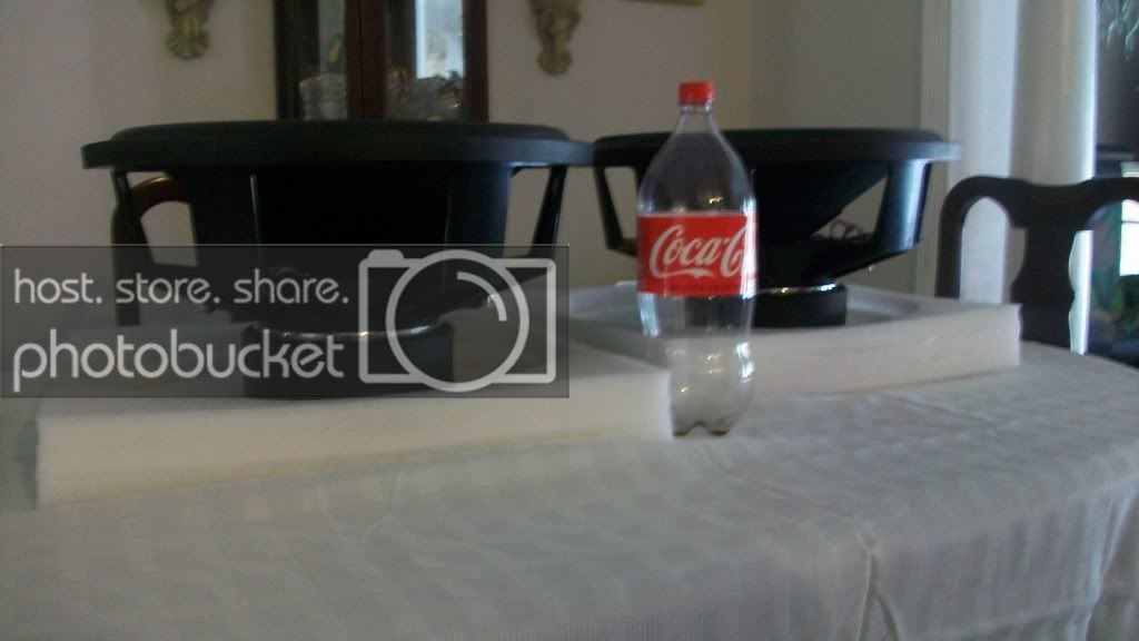

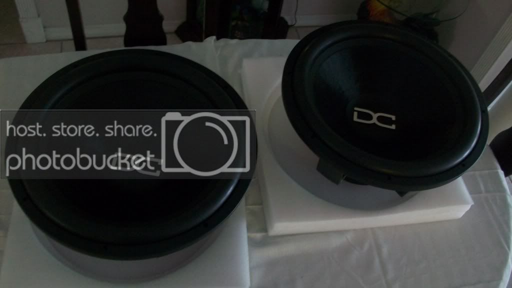

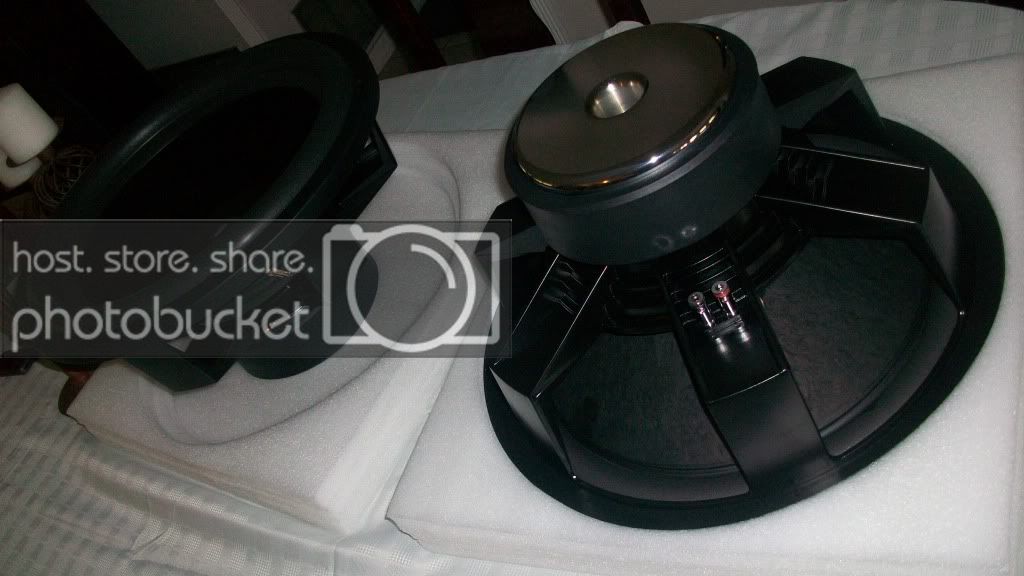

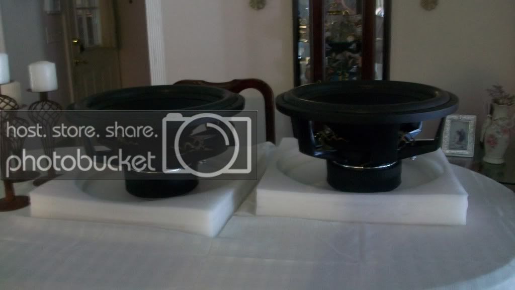

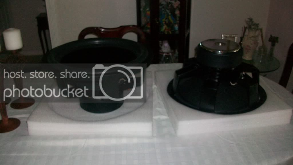

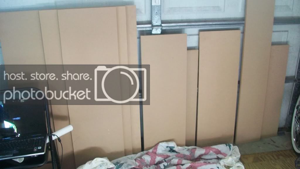

well, i had the xl 15 for a while and decided to go bigger. i ordered two 18 lvl 4s with 5 coils. pics of beginnings will be posted tomorrow. and birch will be bought tomorrow as well. should be fun. //content.invisioncic.com/y282845/emoticons/biggrin.gif.d71a5d36fcbab170f2364c9f2e3946cb.gif

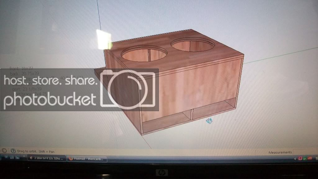

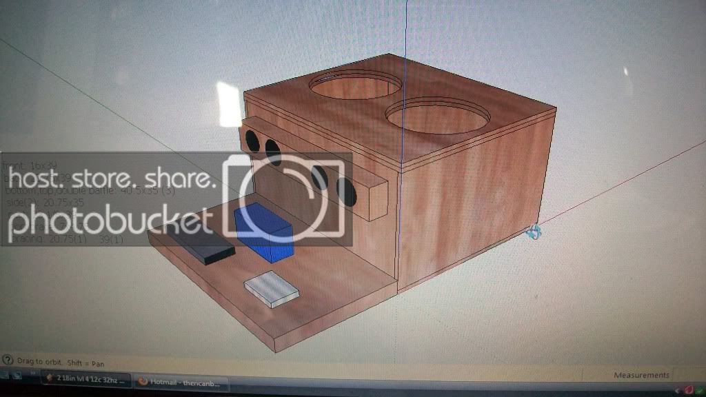

box design was by my friend theAnswer here on ca.com. the actual speaker box design was him on the the pix below, the little ****** looking platform attached was me...:/ i no i **** at sketchup
Woot woot, should be nice man..

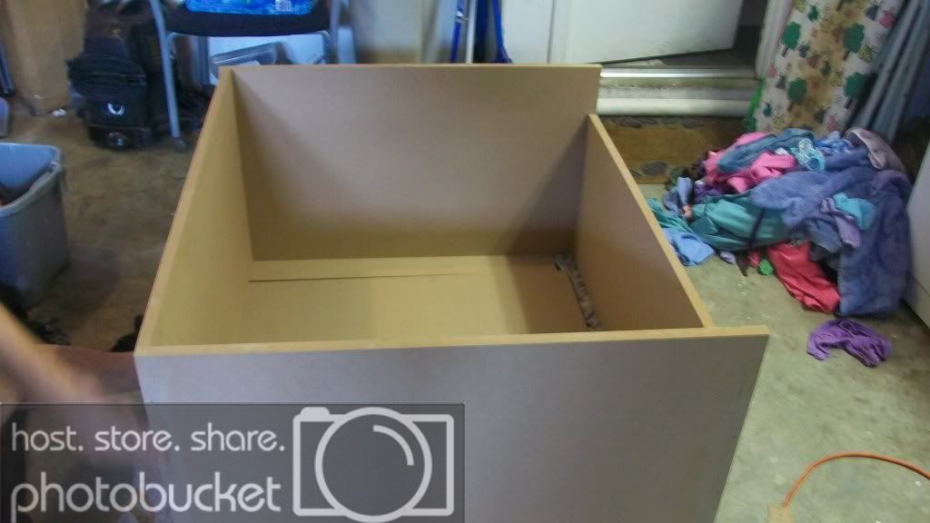

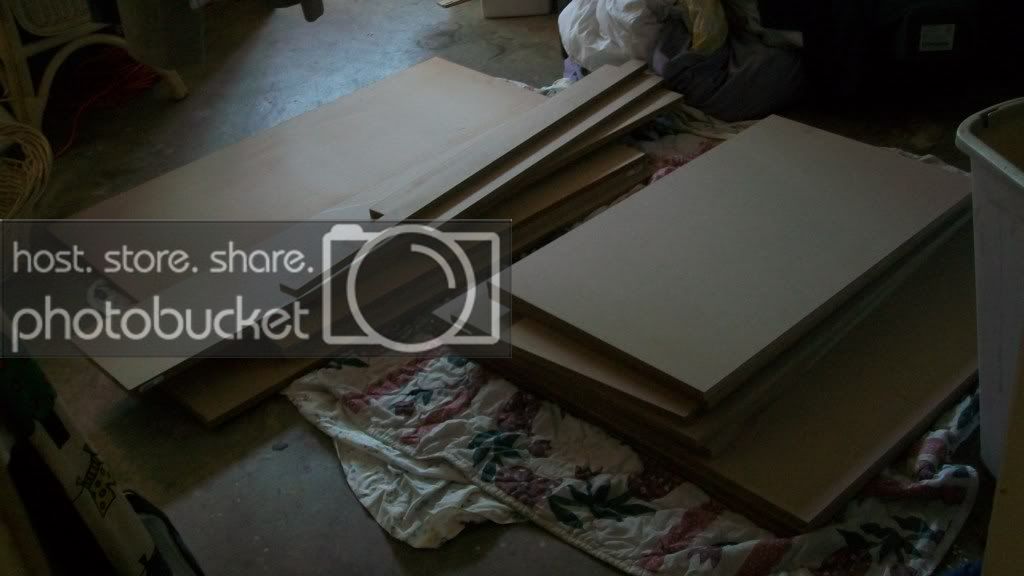

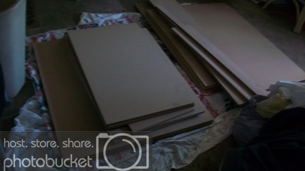

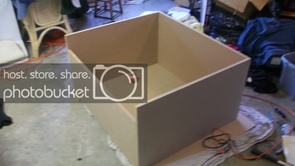

thanks man. i decided not to do what you did. i just did a normal box. when i went to lowes to get the wood cut they screwed it up so i left went to home depot and they did the same thing. so im just going again tomorrow buying two panels and getting a carpenter to cut them precisely. ill be building this saturday or even tomorrow. cant wait

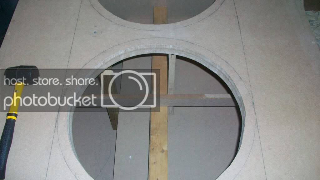

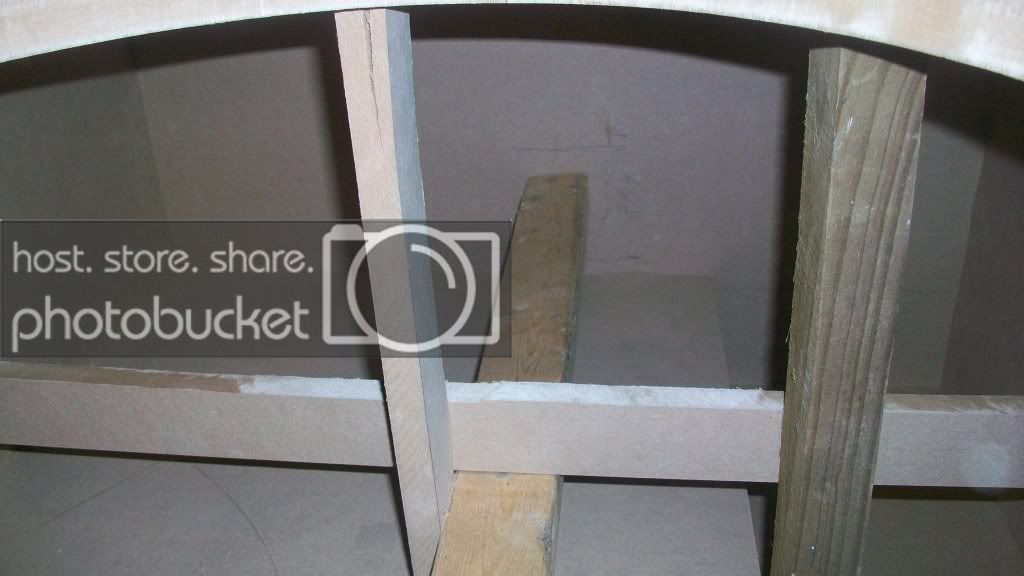

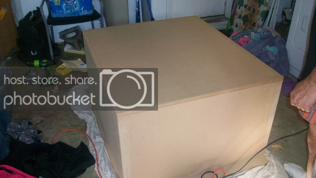

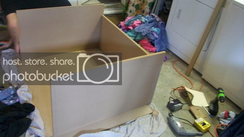

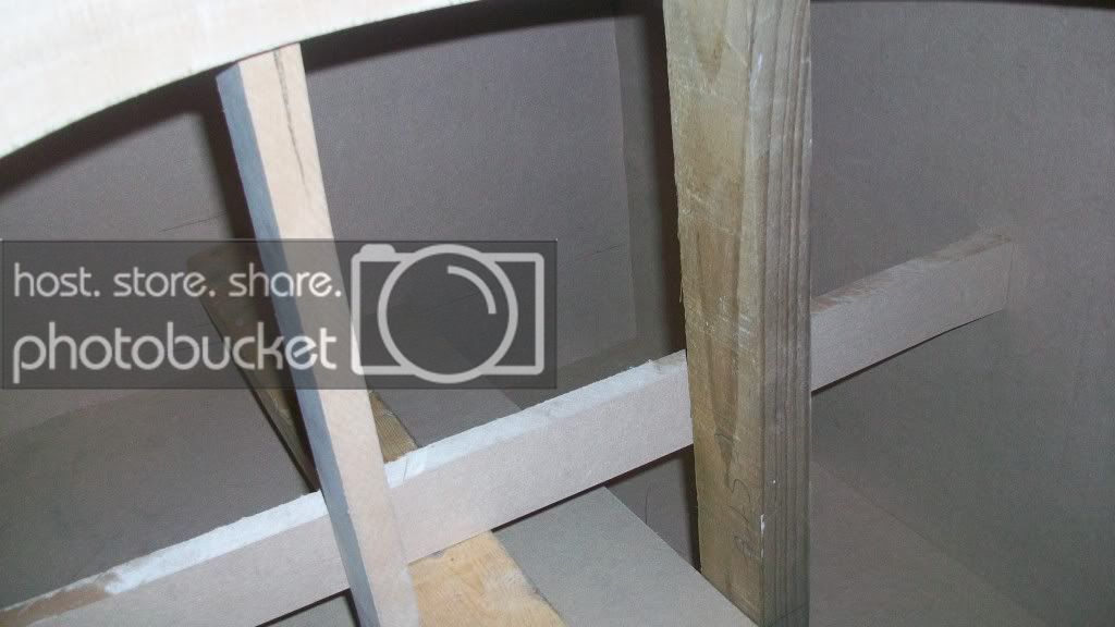

I see you split one of your MDF braces. You should have doubled up on the strips of MDF since they're not very stong on their own(unless you have them glued/screw where they cross, which will help keep them from flexing).
Nice subs though.
Nice subs though.

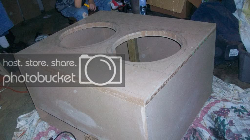

yah i did. all the braces are held together with each other. if that makes any sense. like, all the places where the seem to touch, they are screwed together. also, im siliconing the whole thing
whats it going in? whats powering em? And specs on the box?
Looking good, and DC is tha shit

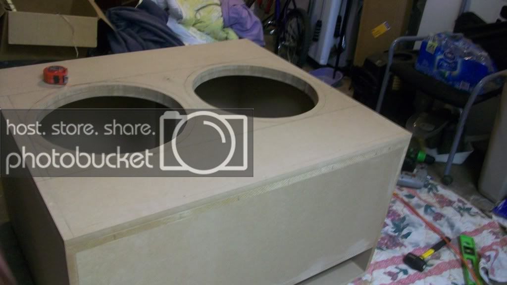

wow havent seen you in a while. its going in my jeep cherokee. for right now im powering them with my aq2200 untill crescendo starts sending out the 3.5ks. the box exactly 12cubes after bracing and subs tuned to 32.
