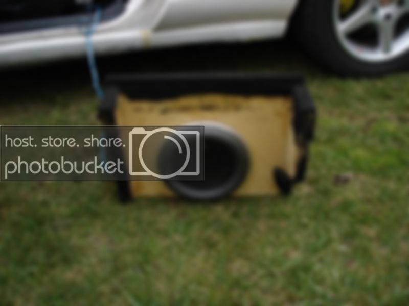

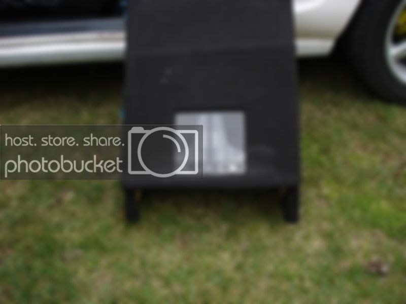

Here is a link to the 12" ported subwoofer enclosure, i built for my fiero, i did have to push the passenger seat forward about 3" to make it fit properly but it pounded and sounded clean. it could of been done better if i had done a version 2 of it after my friend bought it from me to put in his truck. i didnt get any pictures of it in the fiero, but you get the idea, the fiero has just as much space behind the seats as the mr2 if not less. so im sure you can fit a bigger enclosure then the one i built. if you mount the amplifier on the driver side rather then on the enclosure like i did.

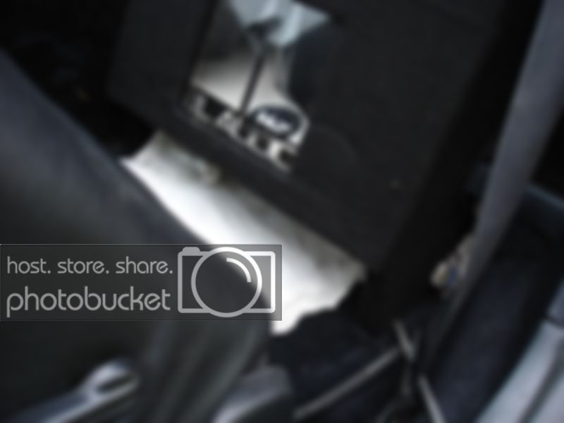

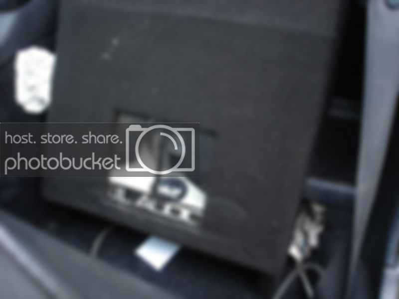

hey hmong337 got any more pics of your ride? its pretty sweet. it will be easier for us to help you figure out possible installation methods, if you could provide us with a picture or two of the area you have in mind for these subs to be installed at with the dimensions if possible. video of your ride doing a burn out would help out too. lol
I went and got pics from storage. Will post up in a sec...

at the end of the day you just have to realize, without going into the front, you just dont have alot of room to work with. We have probably exhausted all options without cutting / going into other compartments.
thanks for the replies everyone. i just wanted to make sure no stone was unturned. and after taking a second look in the cabin, 12's are simply going to be way too much work. i even looked into fiberglassing... it's just way too much work for the intended box that i want to build. i guess it's time to scrap this idea and start my research over with two 10's.
