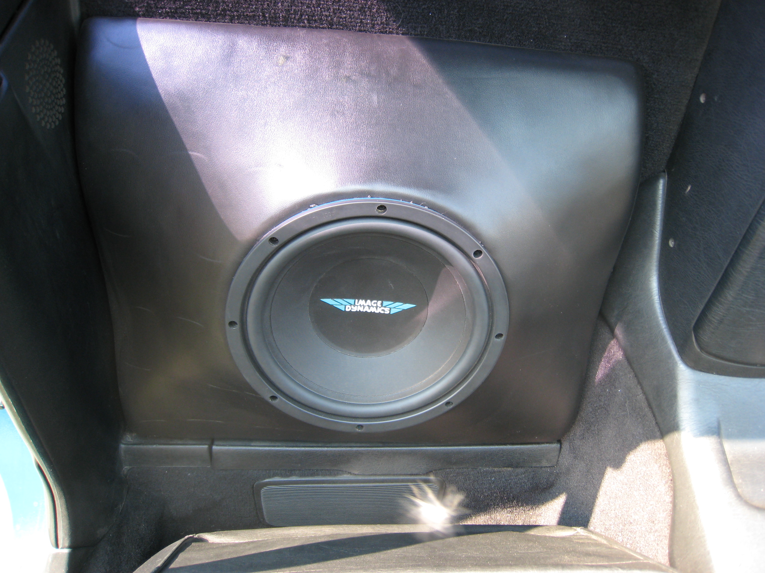

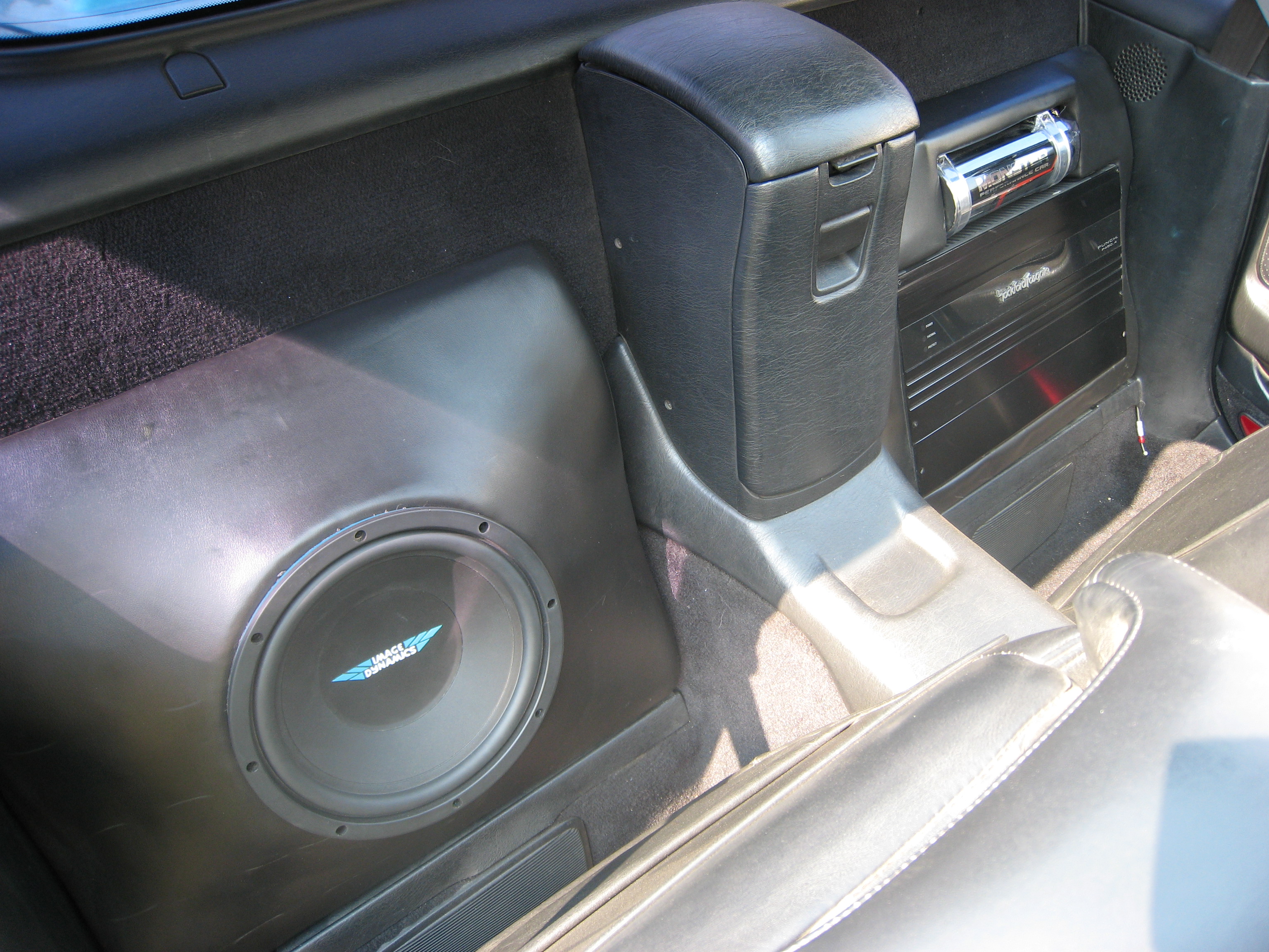

I will post a pic I have for him. I can tell you without cutting into the car this is the deepest you can go. This is an IDQ10 and with the throw and the seat at about MID position it slaps the back panel of the seat making an annoying sound. The box is ABOUT .65 cf, hard to say for sure with so many curves and this is fiberglass except parts of the side and the back. Should give you an idea of the space beign worked with. That magnet is ALMOST touching the back of the enclosure. WOW I'm bad with uploading. If a mod wants to resize those feel free... sorry guys!

Already tried that approach. I've sat in the passanger side with the IDQ10, not pleasant.
