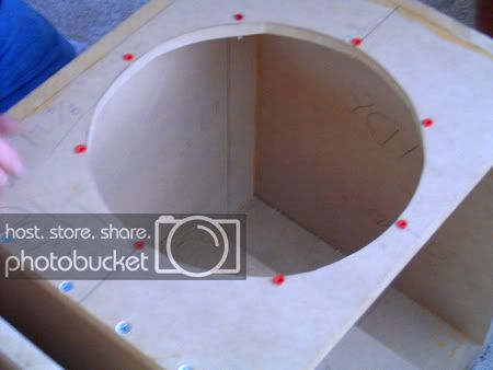

Well, I ended up just taking a slab of left scrap MDF, about a foot long an inch wide, and drilled two holes the length of the radius of my circle. Then screwed it to the center of my board, then stuck a pencil in the other hole, and traced out my circle. Came out magnificently, hehe.

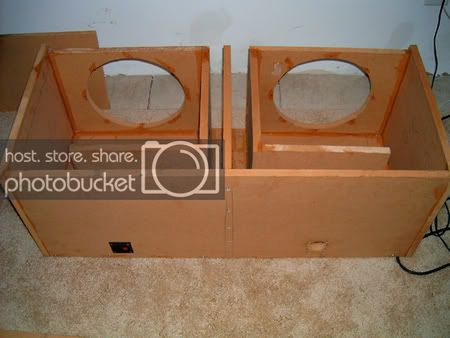

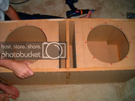

Well, I did a little bit more today, got a Jigsaw from a neighbor, cut out holes, did a little more drilling and screwing. I am having trouble with the 2nd port wall. If anyone could help me out PM or AIM @ FFr3nZieX, thanks.
More pics tomorrow...!!!

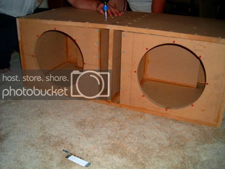

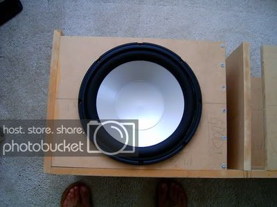

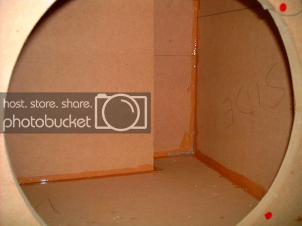

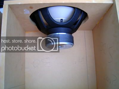

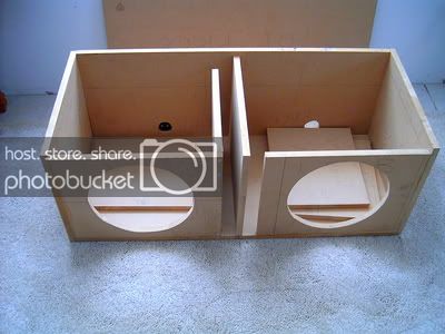

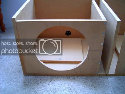

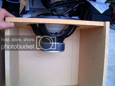

So I'm a little busy today but I did get some things done, I went to lowes and bestbuy picked up some Silicone 1 (100%silicone) sealant and 2 wire terminal cups. I cut out the holes for the subs, cut the holes for the terminals. I glued and screwed the sub walls in place, and mounted one of the 4 port walls, still havent glued it yet. Here's a little bit more eye candy ....
I'll be working on it more this evening, hopefully finishing it. //content.invisioncic.com/y282845/emoticons/smile.gif.1ebc41e1811405b213edfc4622c41e27.gif
Construction is COMPLETE!!!! ::slaps DONE sticker on box::
I just have a little bit of sealing left to do, and then I will be either painting it or going with the vinyl look...leaning more towards the vinyl. My dad also gave me a sleek sexy idea to spice it up a bit, I am gonna be placing two plexiglass window, above the two subs, using like 1" to 1 1/4" spacers and eventually put some blue LEDs in it...it will look sexy //content.invisioncic.com/y282845/emoticons/naughty.gif.94359f346c0f1259df8038d60b41863e.gif//content.invisioncic.com/y282845/emoticons/biggrin.gif.d71a5d36fcbab170f2364c9f2e3946cb.gif .

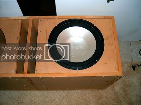

EYE CANDY!!!
ENJOY !!!
