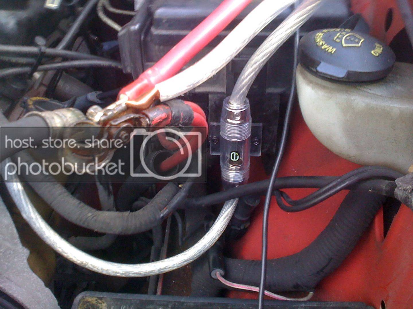

This is in a '98, but it should be the same thing:
Just realized the pictures are huge.
****, so i just put them all in the terminal together? should those other wires be upgraded also? looks like the original wires were just reused in your pics.

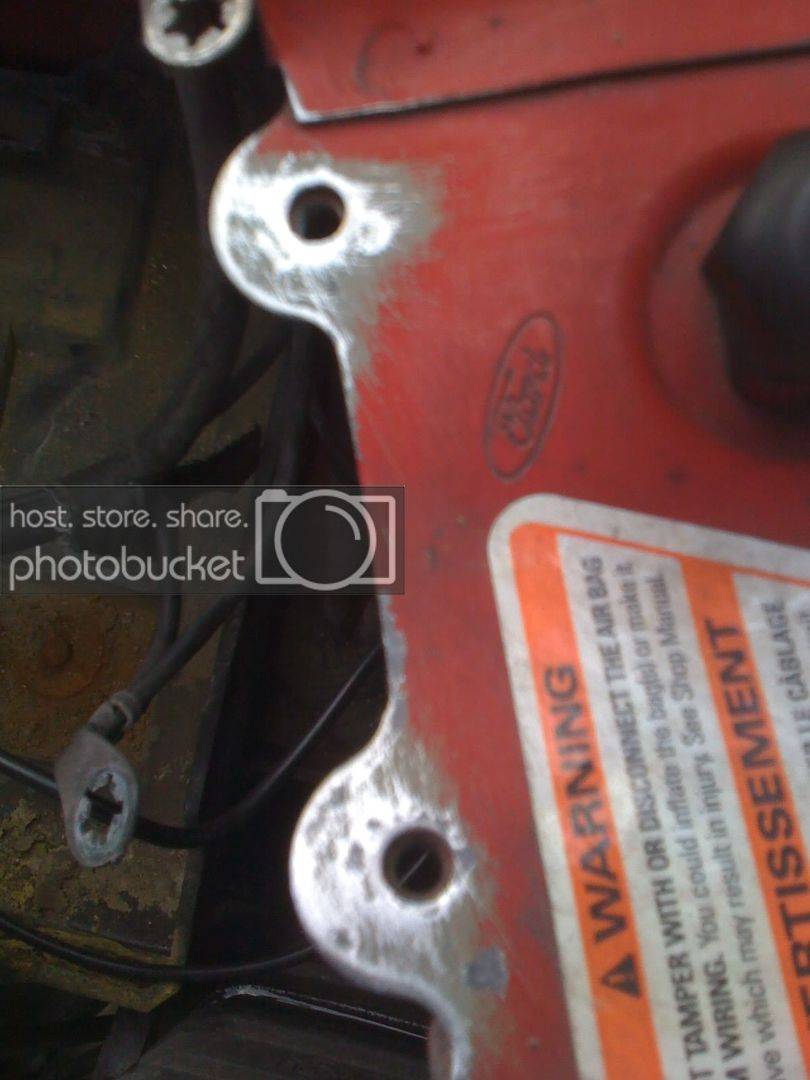

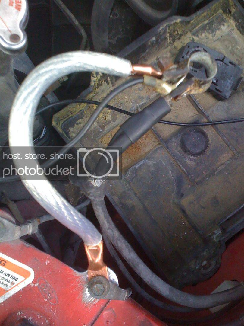

But, you simply need to just connect your wire to the back of the alternator, then to your battery's + terminal, then try to find the shortest place from your battery - to your chassis, then shortest distance from engine block to frame.
I went from ~13v @ idle to 14.3v @ idle and I don't have a fuse yet.

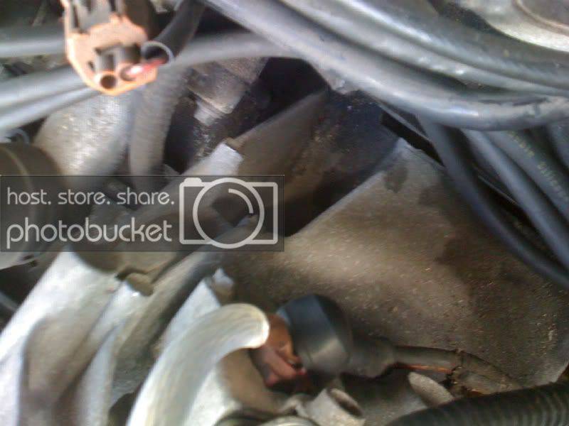

where is the wire from the engine block? thanks a lot for the pics man, really helps!!
I never took one. I did it right off of one of the alternator's bolts... but you can do it wherever. There might even be even better places underneath the car, but I didn't feel like drilling and all of that. I just did alternator bolt to these places:
I didn't want both grounds to be at the same place just for aesthetic purposes and I didn't want to wrestle with it. So, I grounded them right next to each other.
