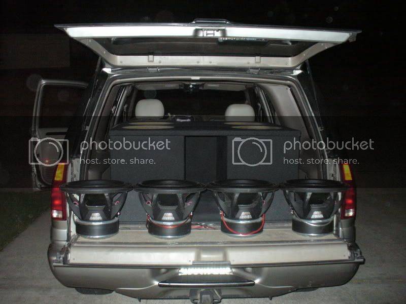

Ive ran 9500's for almost 3 yrs now. I have 4 9515-44's In a 15 Cube box tuned @ 30hz. And slames 6 cubes is to small, Ide give them Like 8-9cubes tuned @ 30-34hz. Heres my box there in now.
6 cubes is NOT too small. They'll work well in anywhere from 3-4.5cubes each.
