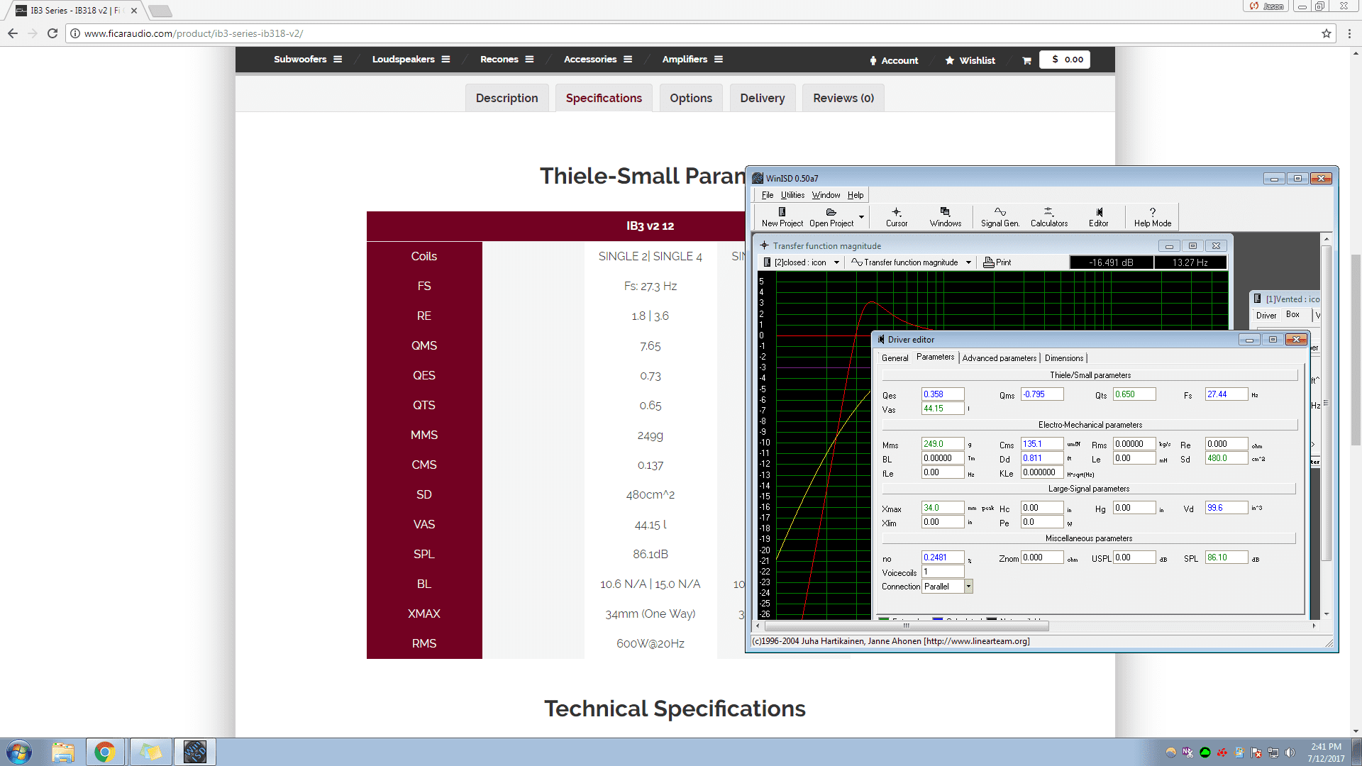

Trying to model an FI ib3 12 and the numbers are just falling apart. Any advice?
I tried to enter the parameters for a FI ib312v2 and got this...
I'm by no means an expert as I am just learning but does this look better for a d2?
Without trying to model myself, low Fs and .7 ish Qts means it is designed to function in a very large sealed box (or infinite baffle). Should be great in that application.
Resolution on your image is too low to see what's going wrong.
If your on a phone. U can zoom in and if you're on a computer. Just cntrl + (+)
Couldnt find anywhere to host the image right...
I was just modeling it vs my icon in IB. Just to see differences. Fi is a whole 3db louder across its bandwidth. I didnt check excursion capabilities but it has 33mm vs 22.
Im aware of the applications. I was just comparing.
I tried modeling it later and it seemed to work for me this time.
