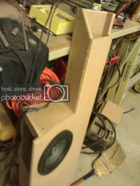

oh, bump. getting ready to put a powerbass pbx- 10 in there tonight...... i just can't find the t/s parameters for the life of me, so i can only go off my best guesstimate and hope it has decent sq roll. 1'cu @ 33.5

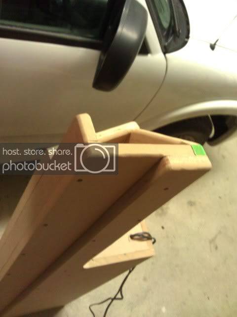

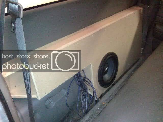

so, after a bit of garage space bugeting, i finally got it done sun. night....... really impressed with myself..... not used to tootin my own horn, but TOOOT
lol, got i back out, coated the port/ back/bottom and lettering the box right now, just waiting on the contact cement to dry.
1.2cu@34hz and excellent flat response. good db gain sealed cabbin. just what i was going for
thank you. truth be told, i've had problems in the past with getting the db gain cabin closed with bts mini-truck enclosures. having another 1-2" to work with helps, too..... well, final tack coat ready... time to start laying vinyl..
