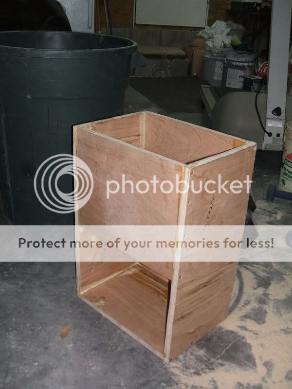

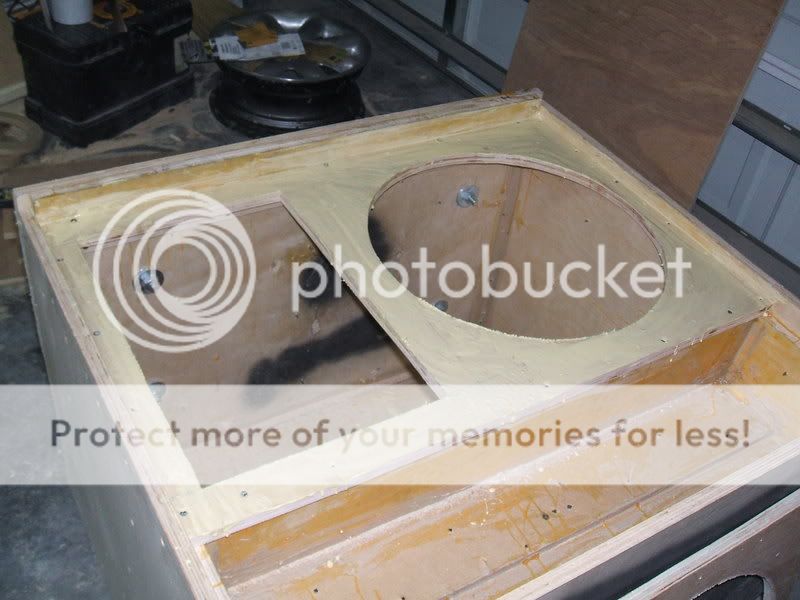

got all the front baffles on, minus the front and rear "beauty panels"
125lbs as of now. ports get built tomorow.
idk, i hope its high though.

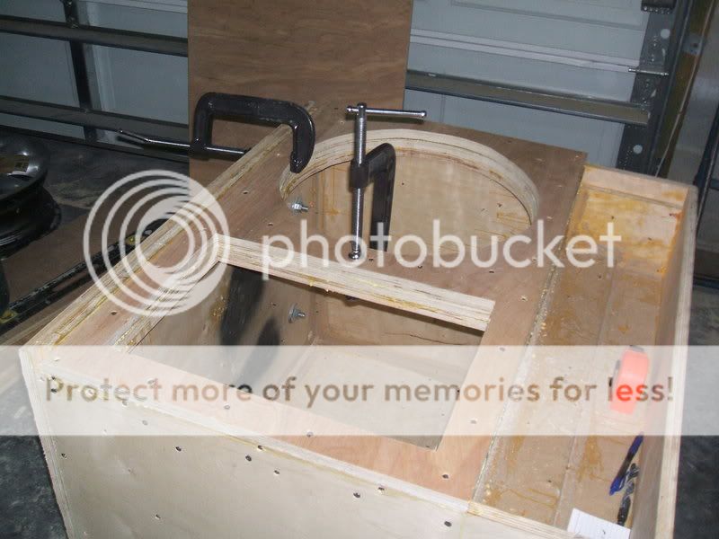

its mainly for just a daily loud *** setup, but i did the removable ports, which im about to build in a minute, so i can change the tuning and see if i can get higher numbers //content.invisioncic.com/y282845/emoticons/smile.gif.1ebc41e1811405b213edfc4622c41e27.gif

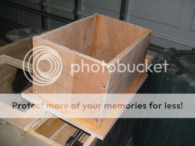

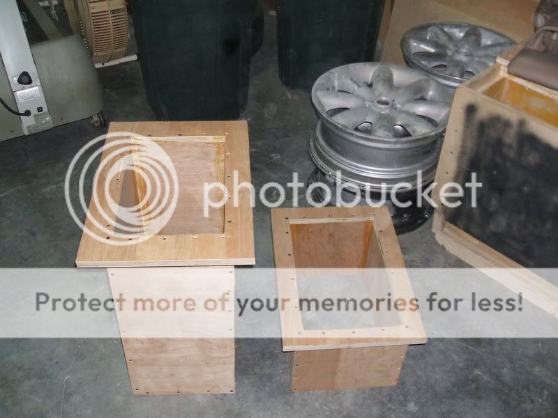

ports = done
im gonna round the insides still, so theyre not 100% done, i have to get my friends router first. im gonna buy one eventually.

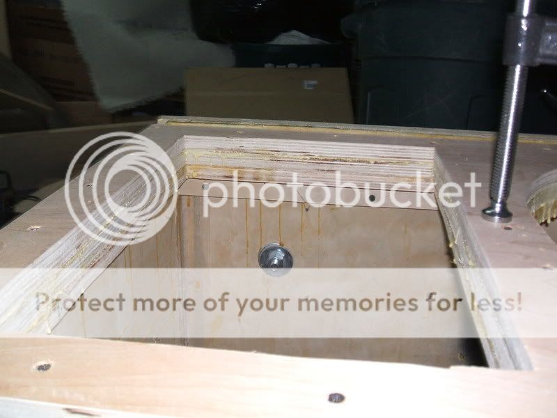

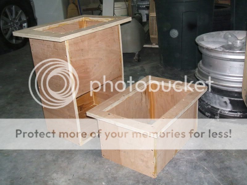

50hz port

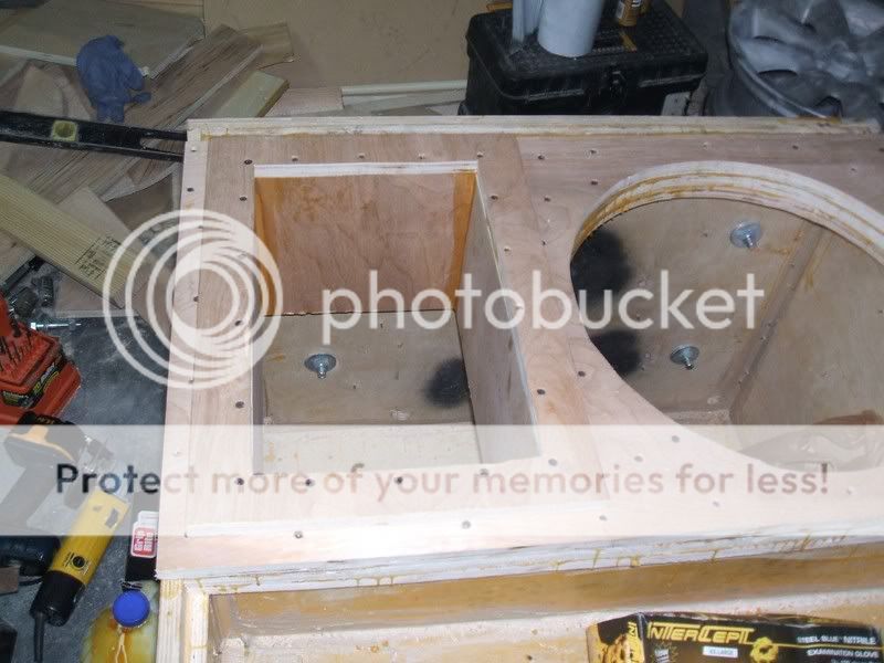

inside box (there will be a final baffle on the front, making the sub and port flush)

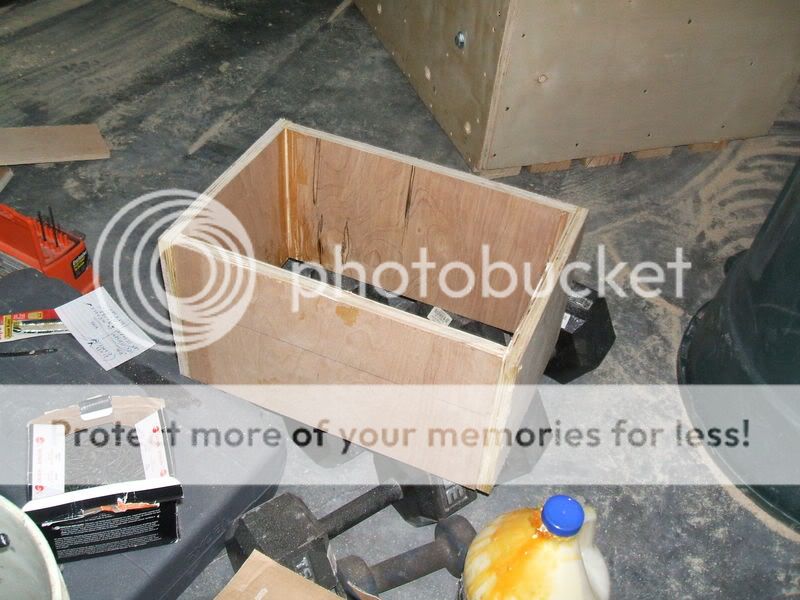

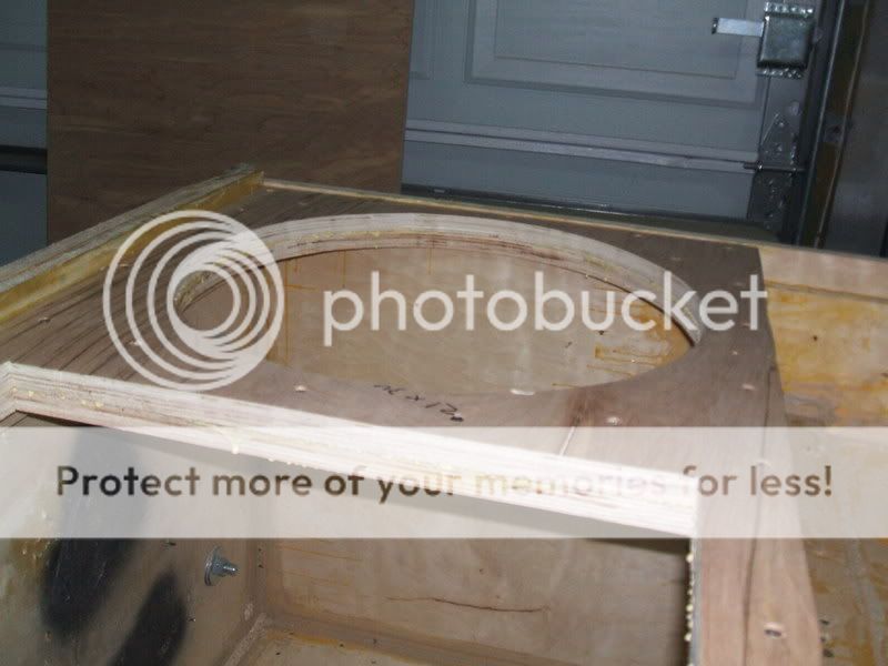

35hz port
35hz left, 50hz right

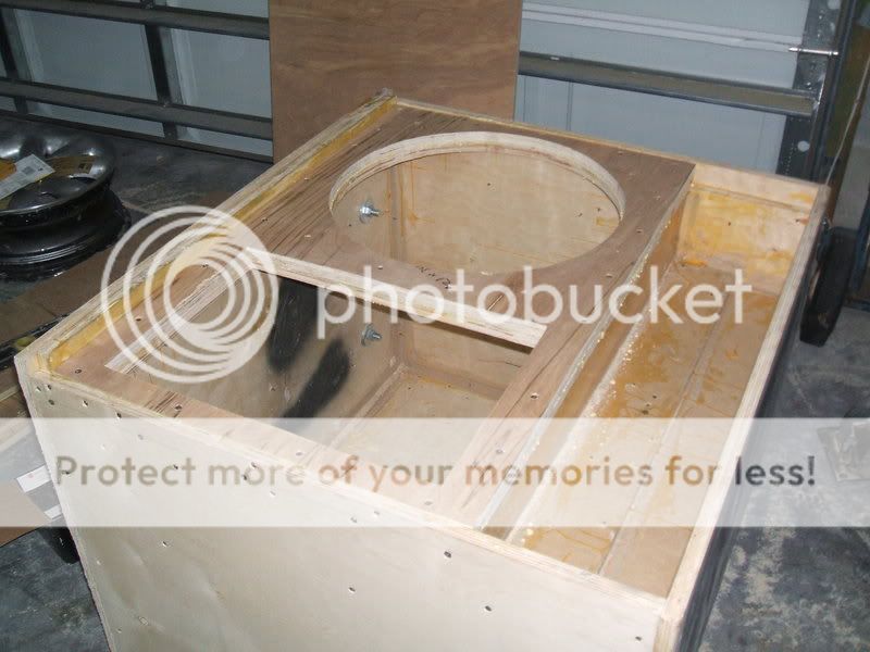

i dont know why, i just over do it on screws and glue.
i wouldnt be so sloppy with the glue, but i dont have the little squirt bottle, i only have a gallon of tite bond. i need to buy a bottle and just keep refilling it, becuase pouring from the gallon sucks lol.

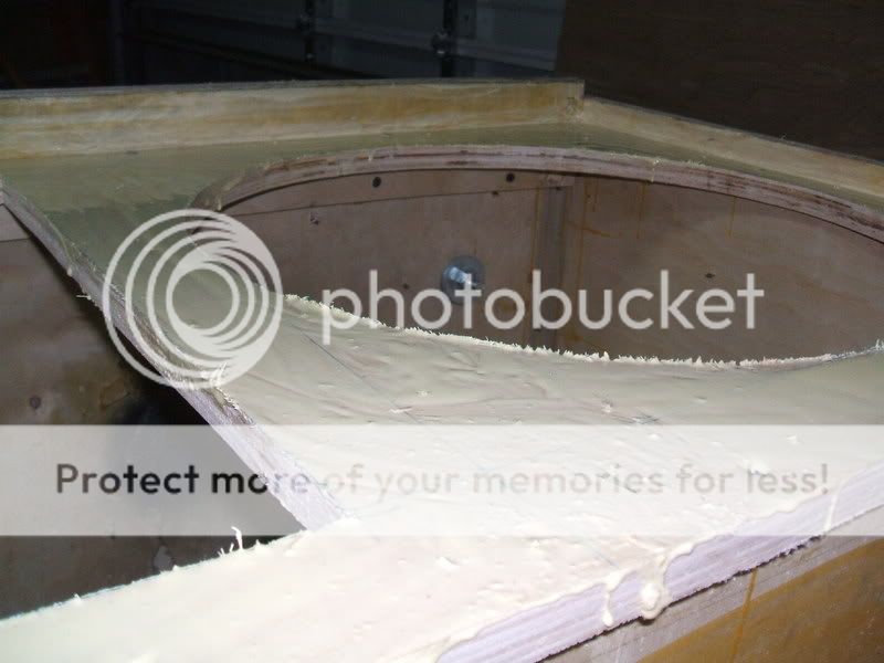

next on the list is to resin everything, and fill the screw holes on the ports with bondo so the baffle has no holes in it
i dont know about that 35hz port.. the way it turns like that i would say it will sound like poo
why dont you try curfing the inside of the port to curve it instead of a 90 degree turn???
