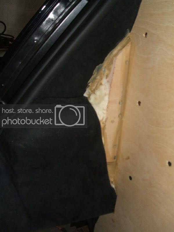

been working on the back lately, i dont have much more left to do really as far as the trim panel in the rear goes. i love how its coming out.

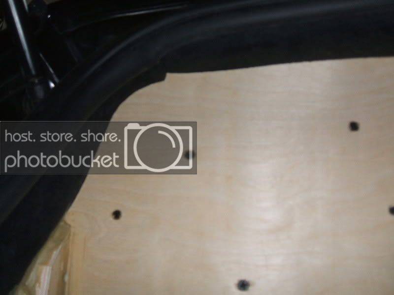

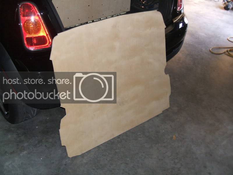

cut out the rear trim panel, although i knew it wouldnt fit, so i had to 2 piece it to get it in the car.

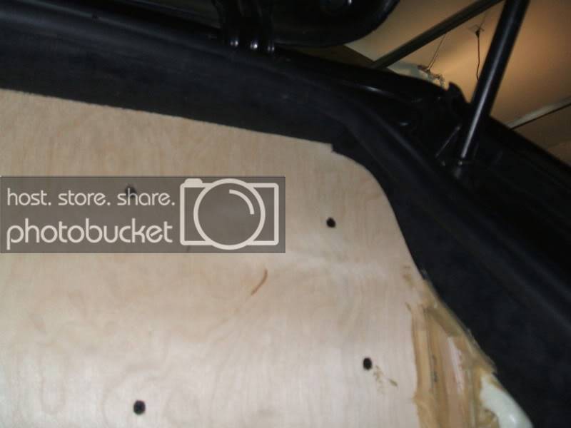

drivers
passenger

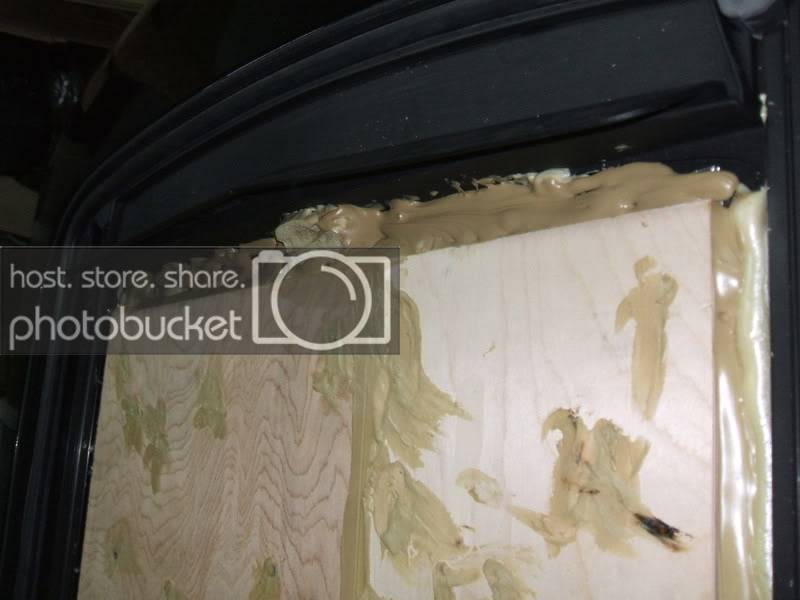

all i gotta do is make a little triangular piece to cover over this mess, and im done with the rear trim panel.

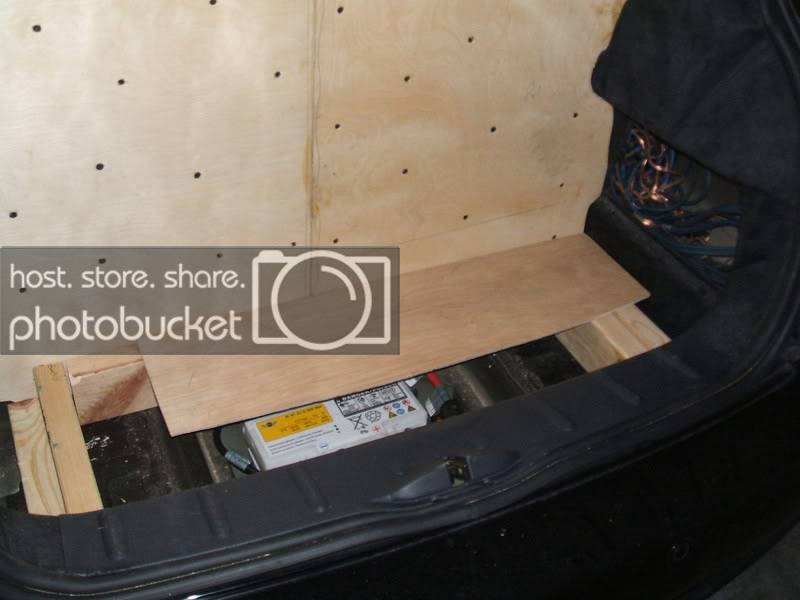

raising the floor a little, this is where ill put things like excess wire, fuses, my 3 way crossover, etc etc. (under the floor)
the floor will be suede as well, thats why i think suede top bottom and sides, then the center trim panel would look good accenting it in vinyl

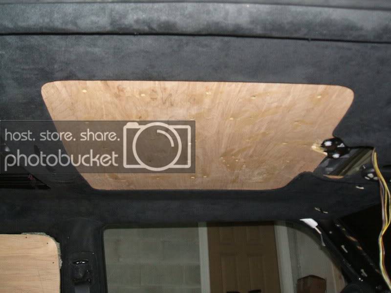

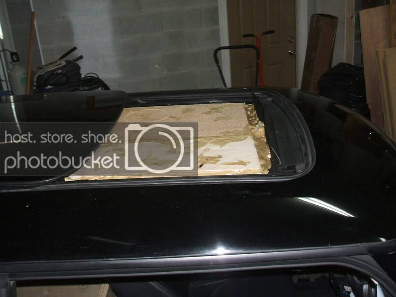

closed the sunroof, need to cover this in suede, and it wont look bad at all.
this is what looks bad, but no one will ever see it, the sunroof DOES still open though, its just pointless since its sealed off. its very stiff, ive got the 3/4", then a layer of Peel n Seal, then 1/4", then another layer of peel n seal, then the final 1/4" which you see from the inside of the car, which will get sueded.
