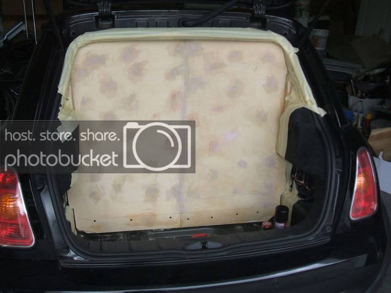

mini cooper, wall, 2 18" mts, 6kw

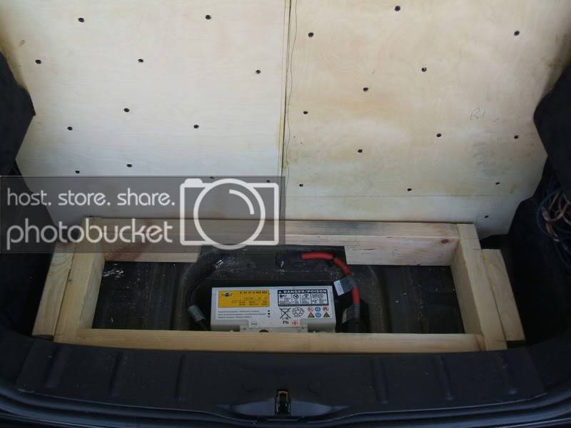

frame for the false floor

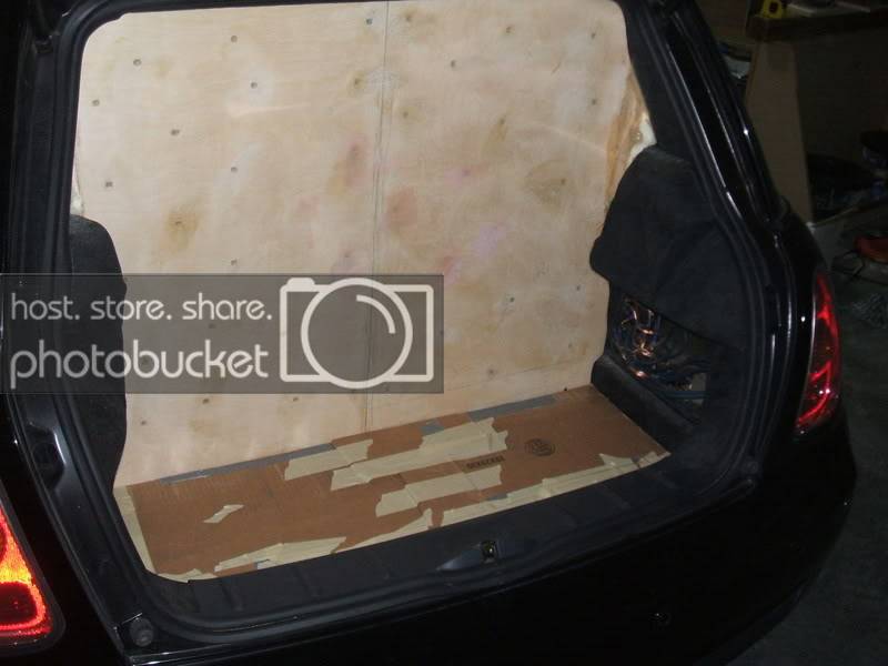

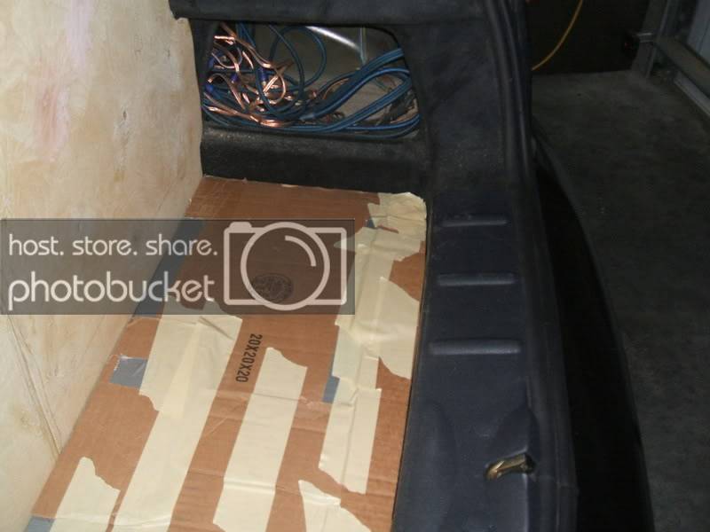

cardboard template for the floor
will be traced on 1/4" birch, and cut out tomorow after work, around 4pm EST.

been working on the back lately, i dont have much more left to do really as far as the trim panel in the rear goes. i love how its coming out.
cut out the rear trim panel, although i knew it wouldnt fit, so i had to 2 piece it to get it in the car.

raising the floor a little, this is where ill put things like excess wire, fuses, my 3 way crossover, etc etc. (under the floor)

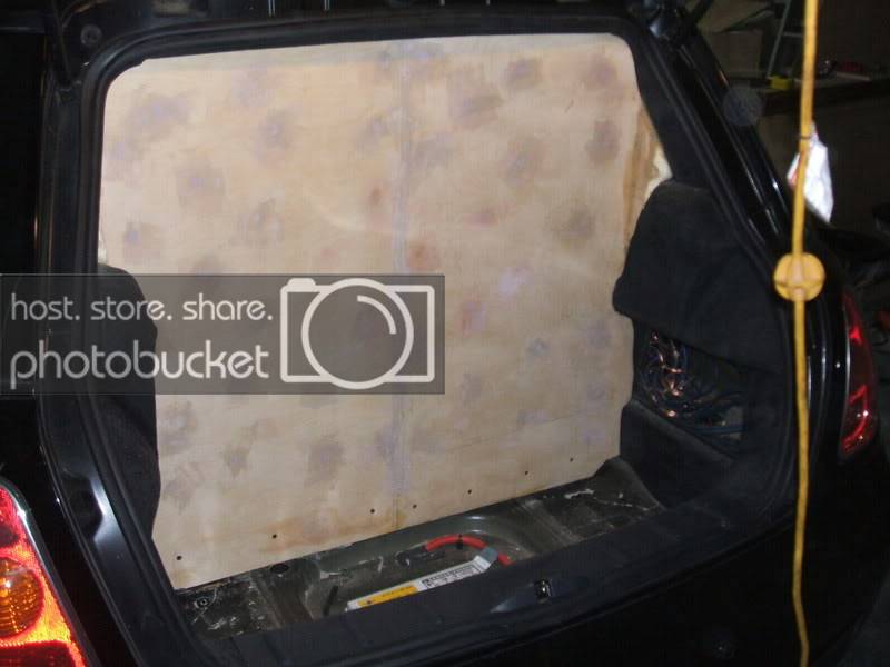

closed the sunroof, need to cover this in suede, and it wont look bad at all.
this is what looks bad, but no one will ever see it, the sunroof DOES still open though, its just pointless since its sealed off. its very stiff, ive got the 3/4", then a layer of Peel n Seal, then 1/4", then another layer of peel n seal, then the final 1/4" which you see from the inside of the car, which will get sueded.
