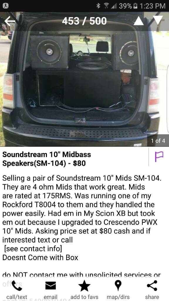

This guy be selling 10"mids but they look like subs can someone explain how mids work because I thought mids were the speakers on the front sides and rear sides of your doors and only came in 6.5 6x8 6x9 5 1/4 not as a 10" I always thought that size was a sub if anything? Or is a full scale system tweets mid speaker then mid woofer and then sub ?

Have you even looked at what speaker's guitars, and rock concert/dj speakers use? All 12 and above.
Fitting them in your car is not for noobs. You need to know how to do custom work along with picking proper mids +tweets for a proper 3 way or just tweets that play low for a proper 2 way front stage along with having a digital signal processor to time align, cross over and eq them all out properly.
Results will turn out phenominal though, the lower midbass and midrange gets a much needed punch especially if you have a crazy subwoofer stage.
