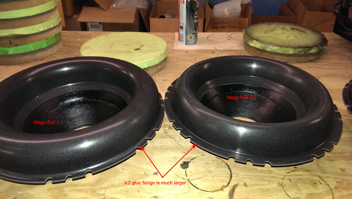

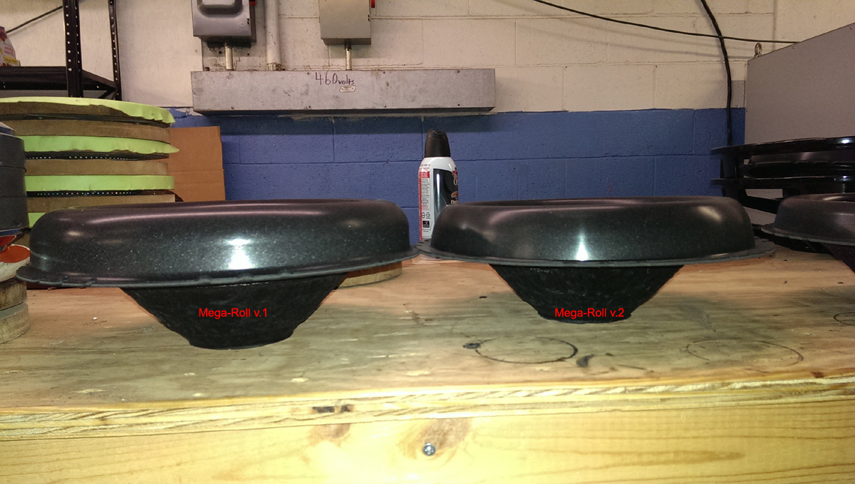

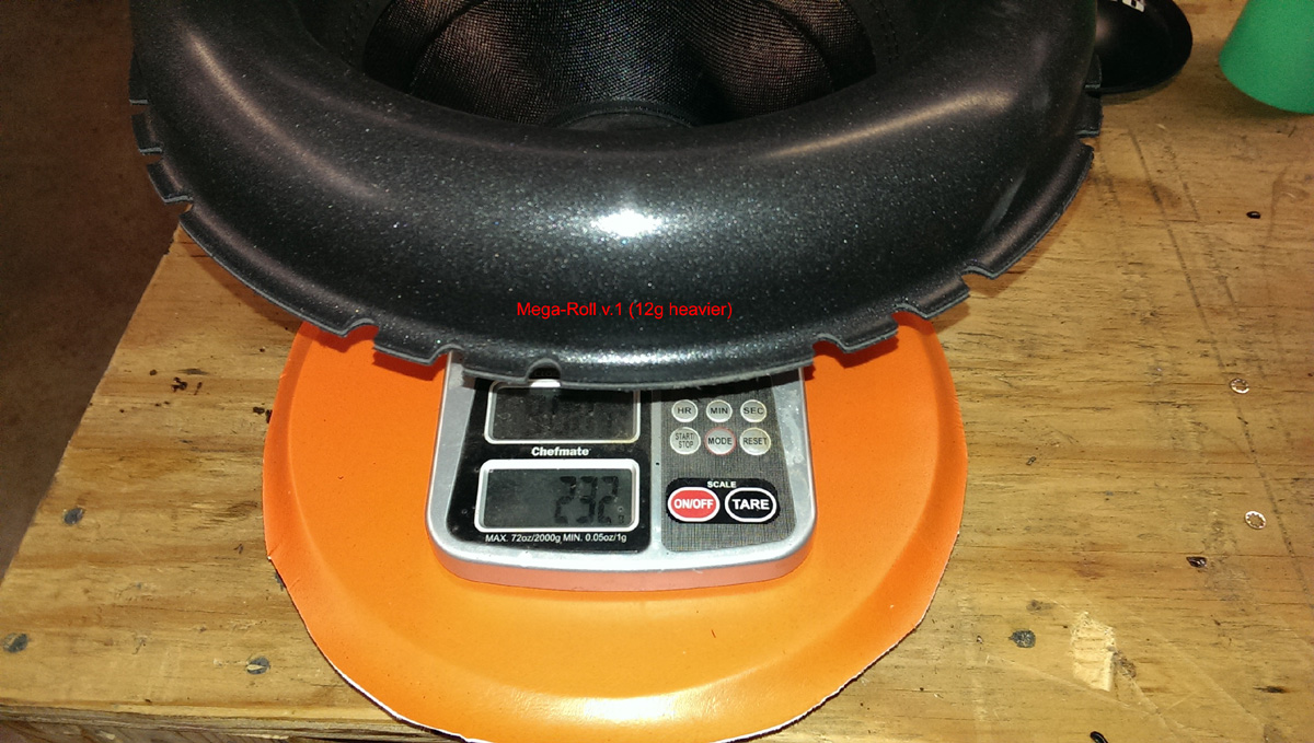

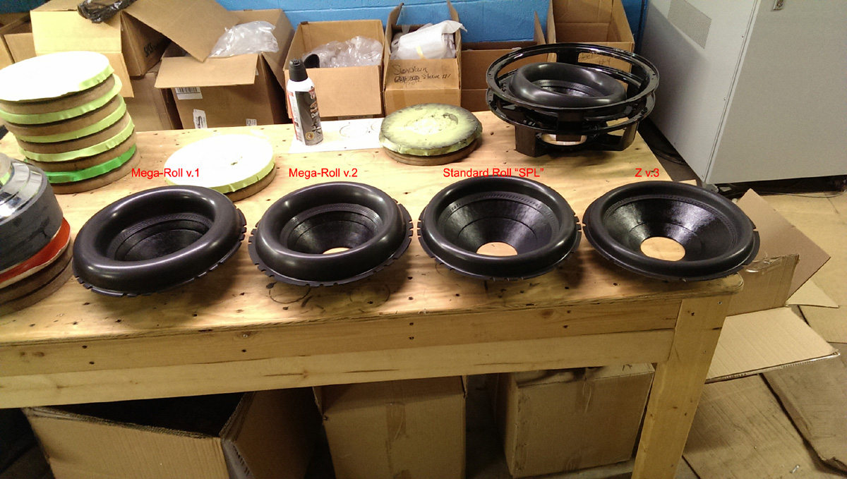

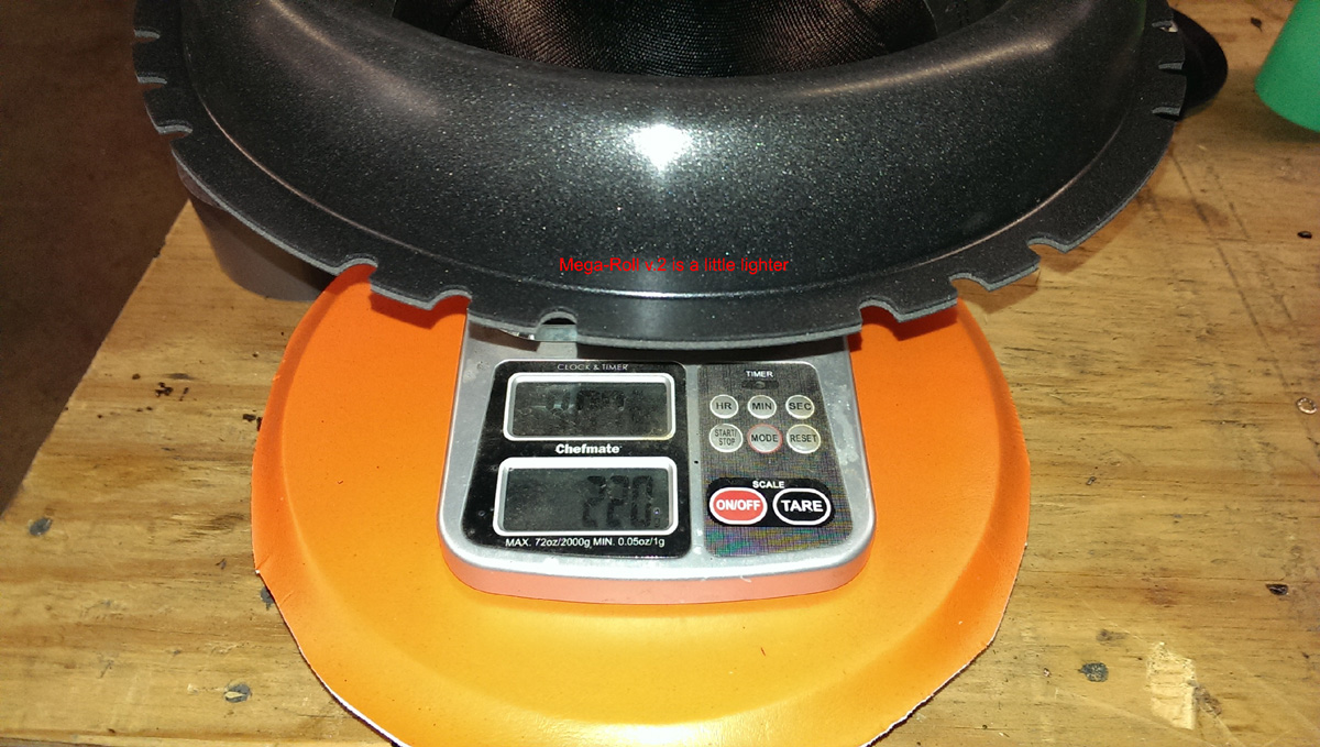

Hey let's talk about Mega-Roll v.2 while we are at it //content.invisioncic.com/y282845/emoticons/smile.gif.1ebc41e1811405b213edfc4622c41e27.gif
That is about to launch -- bit more linear profile based on our data over the last few years of the Mega-Roll v.1 on the market (I've found that people that were on the fence about the LOOK of the v.1 have been swayed to like the v.2 look). Easier to mount since we moved the surround away from the screw holes a hair & the new shape angles away so less likely to bump it w/ the drill. It's also inherently stiffer so we can drop a spider layer for the same compliance (reduced mass).
Most of the difference in "apparent" size is the angle of the roll -- overall dimension are within a few millimeters (total width & height).

Does the V2 have more actual cone area?
It's really almost identical -- they are a few mm narrower but I put most of that width "savings" into the glue flange -- to both push it AWAY from the screws & to increase the surface area for adhesion.
