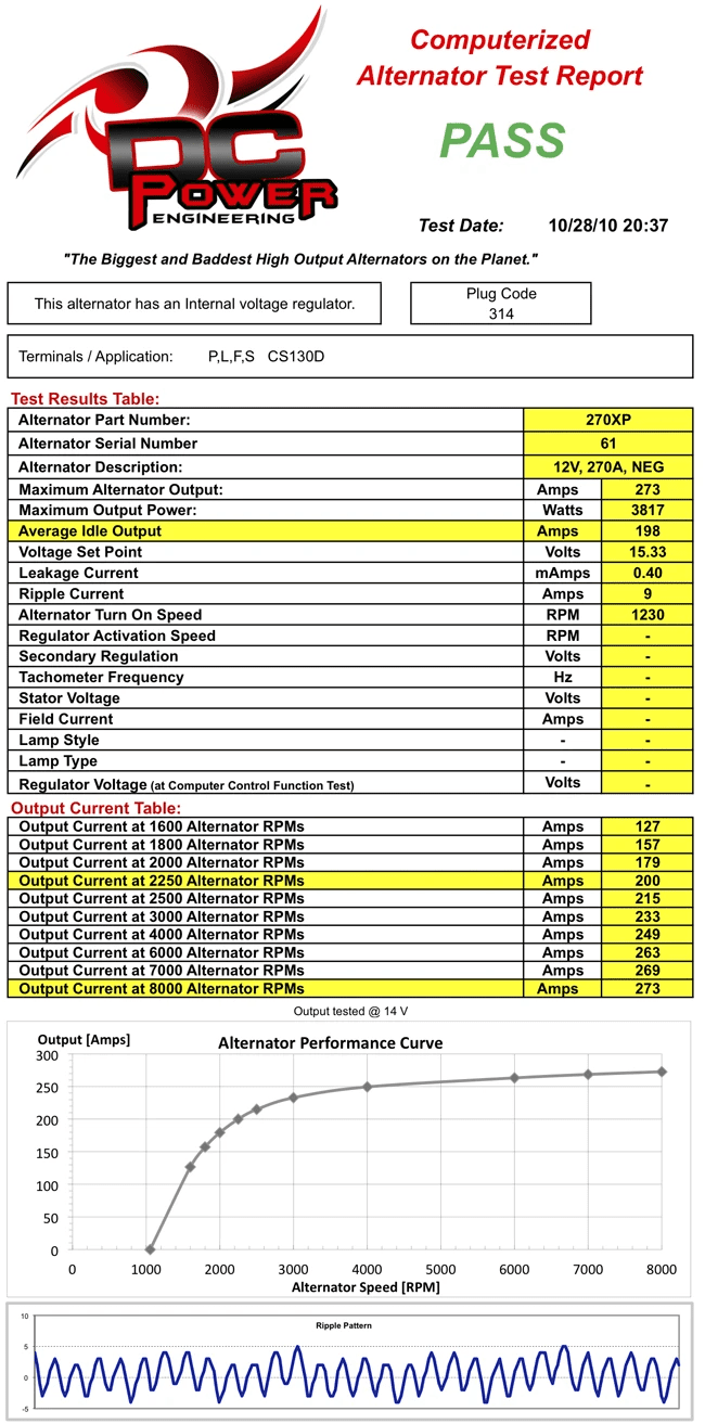

I showed you hot and cold numbers.
No i'm talking about a real benchmark, not hypothetical max numbers. This is what a real company does
25964
  • OUTPUT VOLTAGE:14.8
  • IDLE AMPERAGE:200
  • HOT IDLE AMPERAGE @ 200° F:180
  • MAX AMPERAGE:270
  • HOT MAX AMPERAGE @ 200° F:250
I mean hell Singer literally sends you an official benchmark sheet with your package because he individually stress test each unit. So much for "uhh your just paying for the name"
